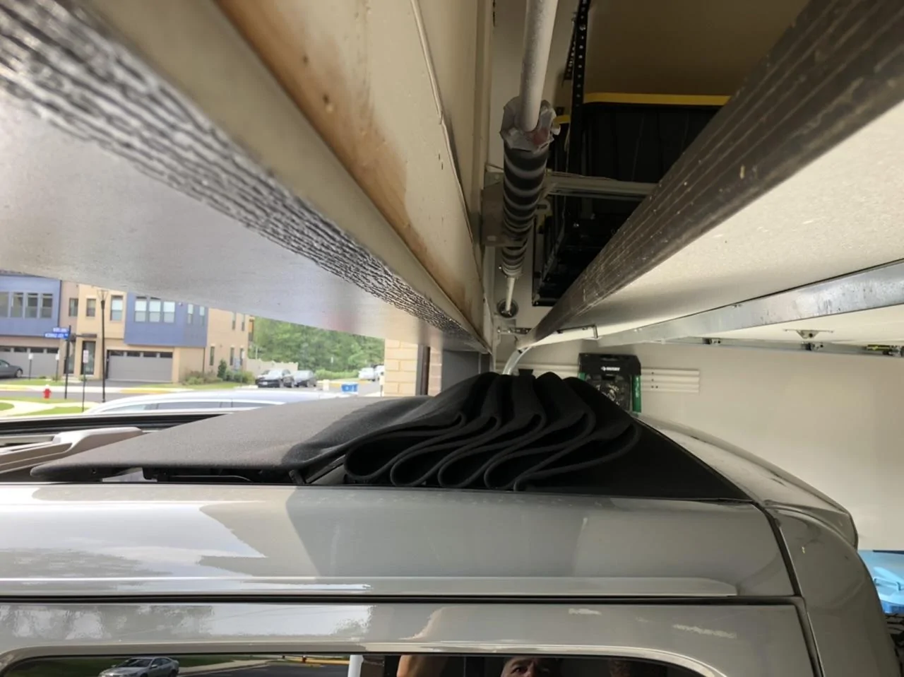

I have the MC 2.5” life with 35’s and I still have room to spare, even with my sky touch open. The other thing idea to ensure it would fit in the garage is adjust my garage door to open the full height as the garage door frame.
