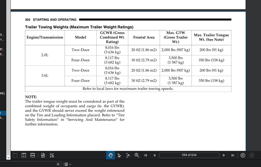

I've seen different numbers for the GCWR on a JLUR 3.6/6 speed. One which was posted in another thread by an admin which says that number is 11063, and another with a spec sheet that lists 8495 as the correct number. That's over a 2000 lb difference between those numbers. I'm looking at a trailer which is 3000 lbs dry and will be close to the capacity of my jeep so finding the correct number is important. I know there is another thread with what weight trailers people are towing. I'm not interested in that. I want to do my own calculations with the correct number. The dealer says I'm pushing it, even with a weight distributing hitch. Does anyone know where I can find the correct number?
