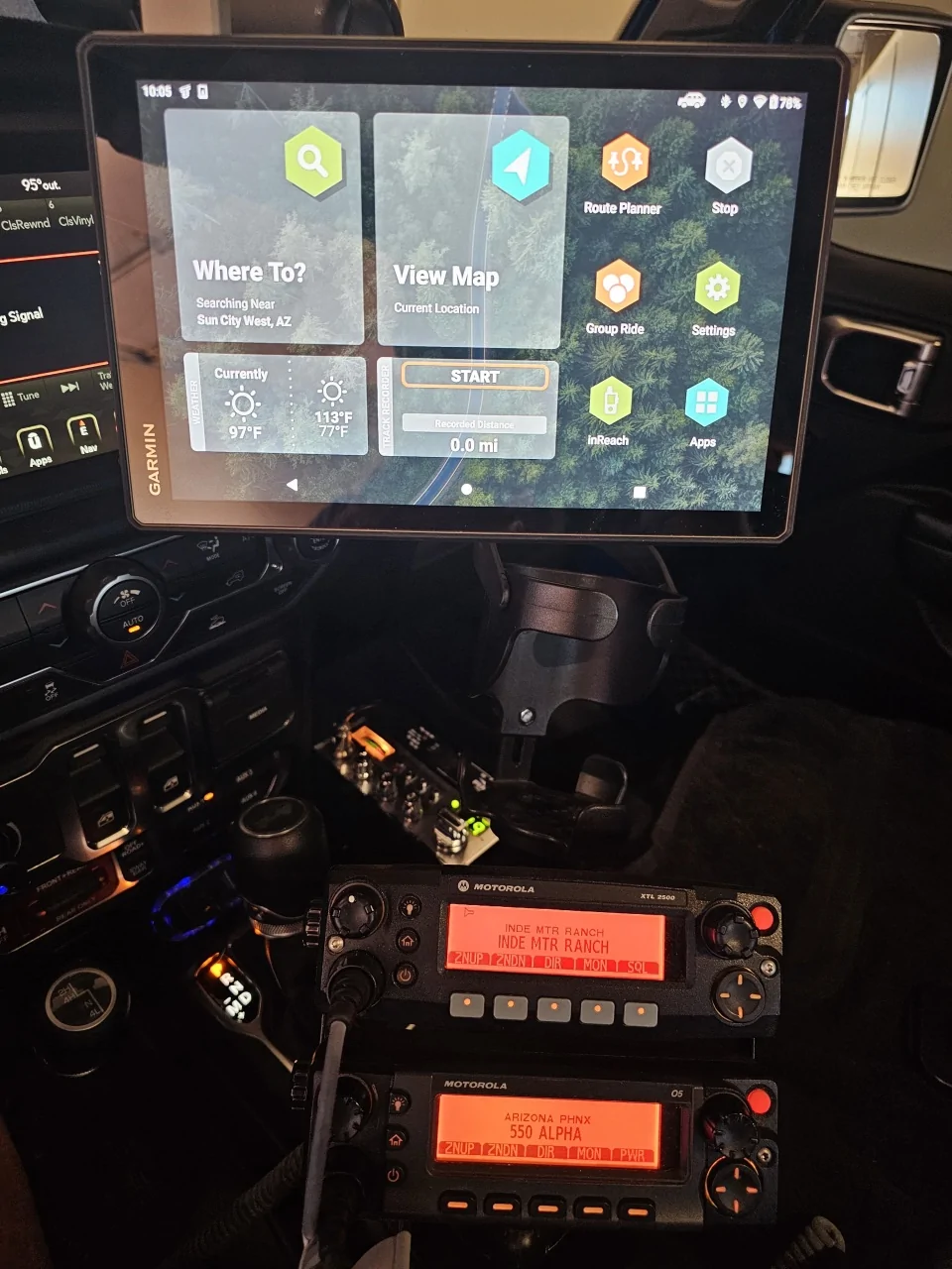

I have the 10" screen.

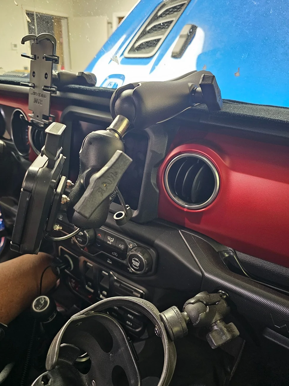

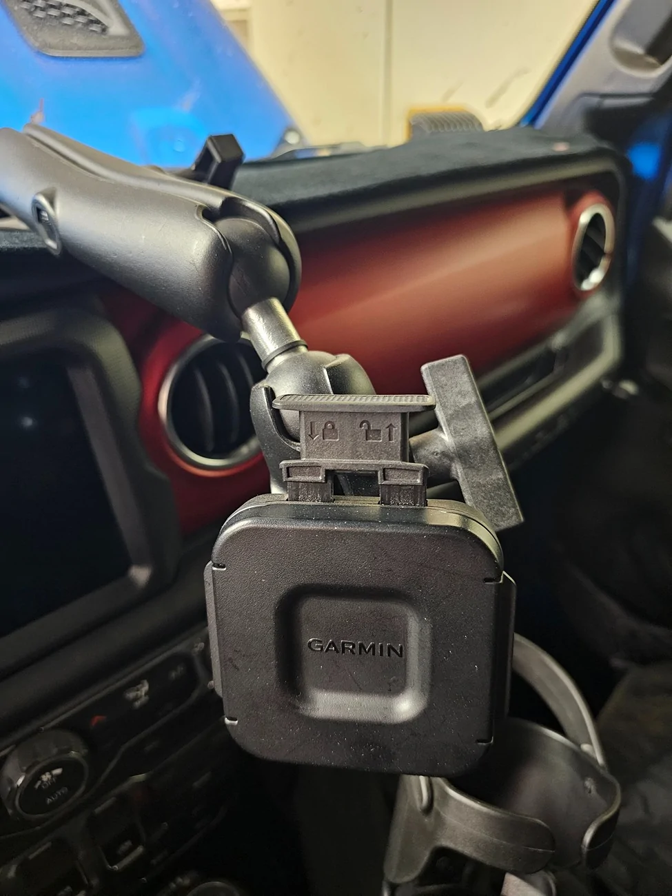

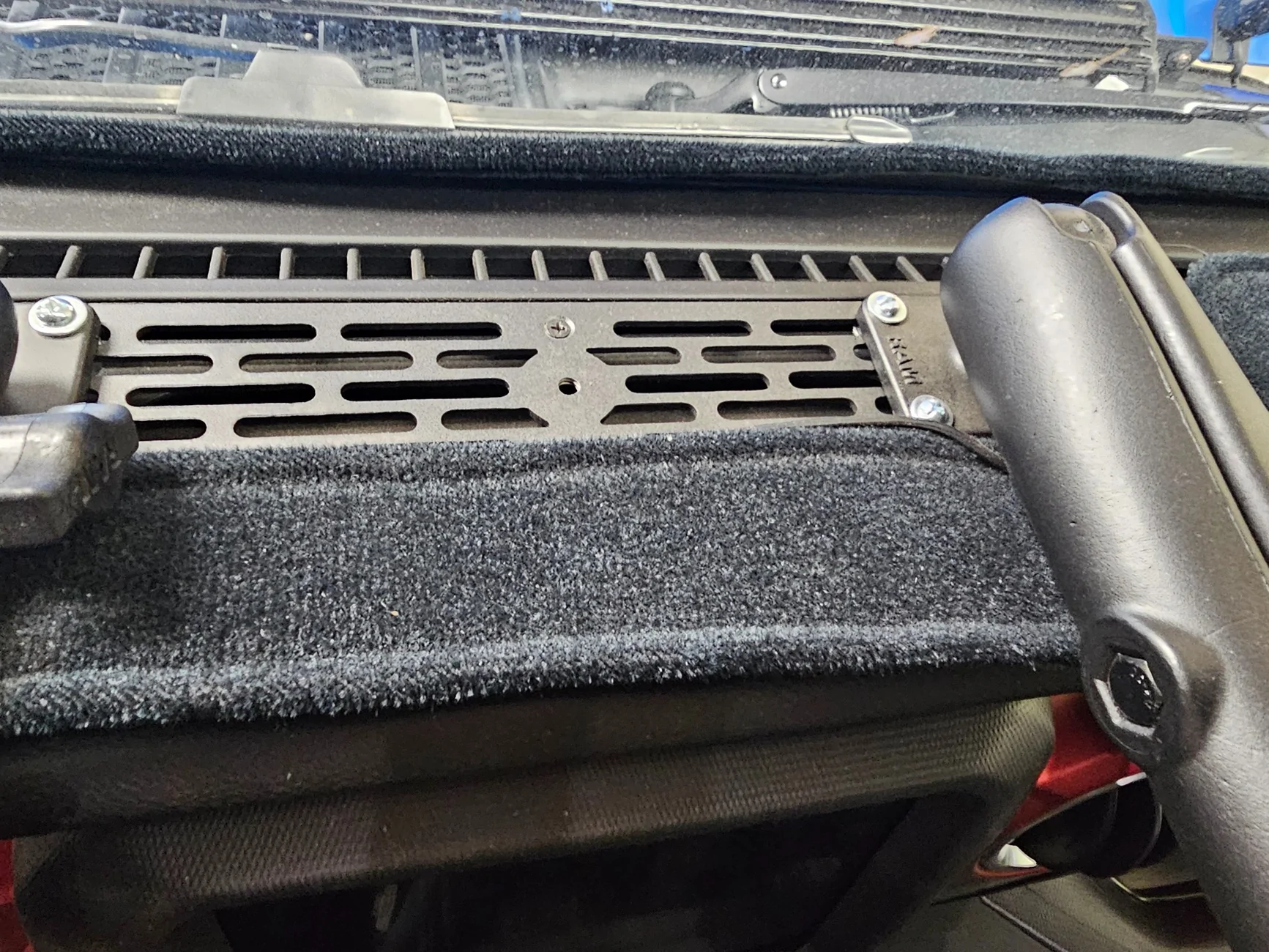

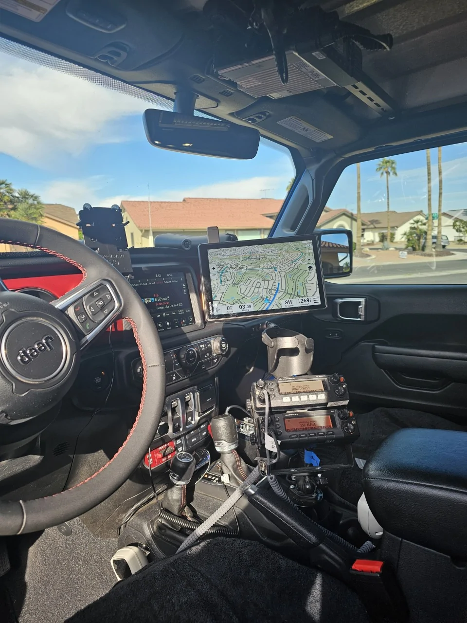

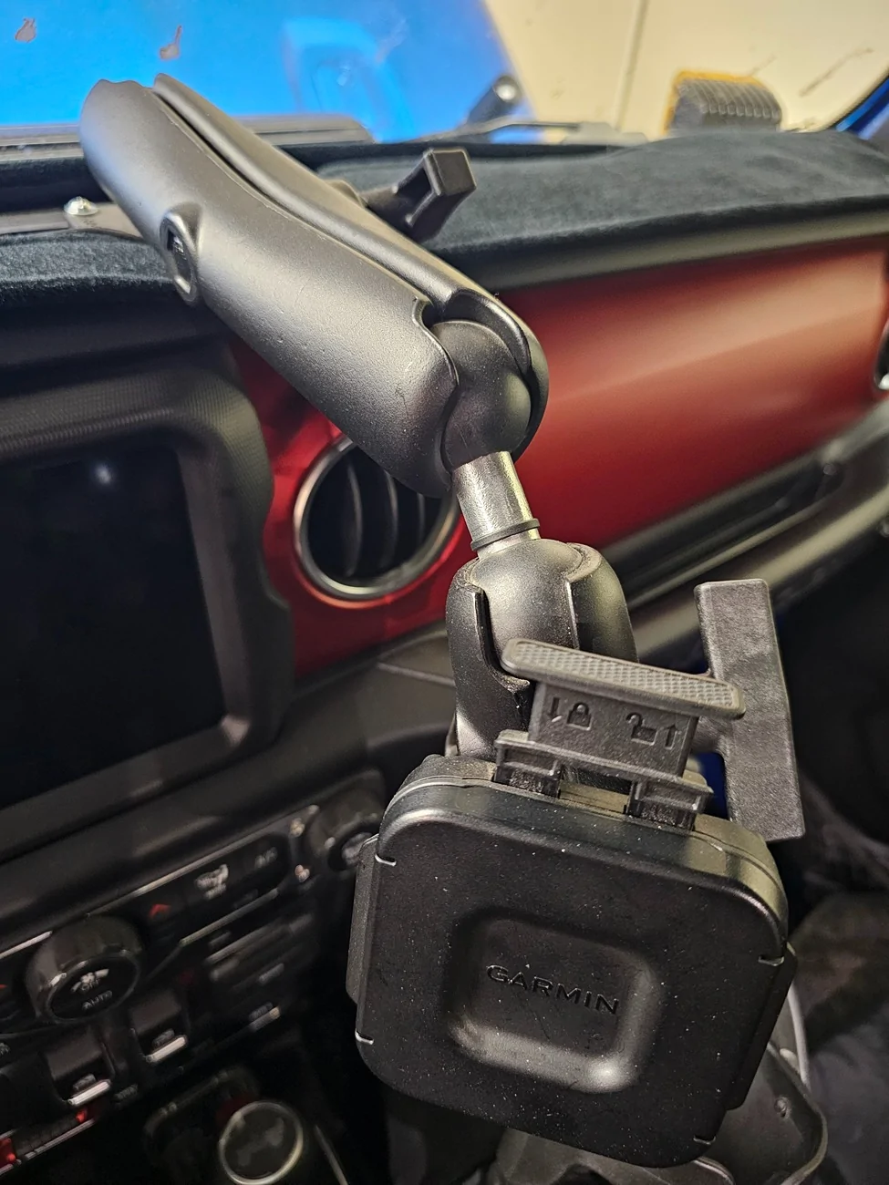

how did you mount that Garmin? What did you attach on the dashboard to it to keep it from rattling on dirt roads pull some pictures if you can.
Nokones
Kenny
Dec 31, 2023
1,041
1,128
Sun City West, AZ
I used the Bullet Point Rubi Grill Mount that fits inside the inset on top of the dash and I used RAM Mounts Ball Mounts, Ball Joints, Ball Couplers, and the Heavy Duty Long Arm. The long arm essentially lays on the dash from the ball mount for extra support for the weight of the Garmin.
There is no vibration.
