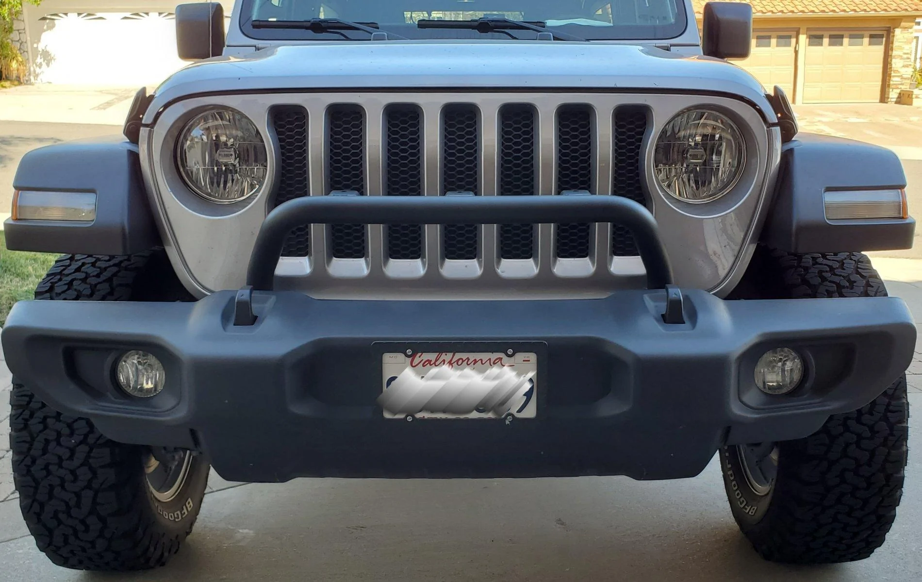

I'm afraid the closeout part numbers you mentioned don't fit a sport plastic bumper. They are for the Rubicon plastic bumper.
Our only current option for the sport plastic bumper is to remove entirely or trim. In my case, I chose to trim while on the bumper. I used a box cutter with a new blade. It was a 20min job taking your time.

Good point. From looking at the images, the mounting hole pattern is different. It may be as simple as drilling new holes.
With the recommendations from others on this forum, I found trimming the existing panels in place the best/simplest way to go.
