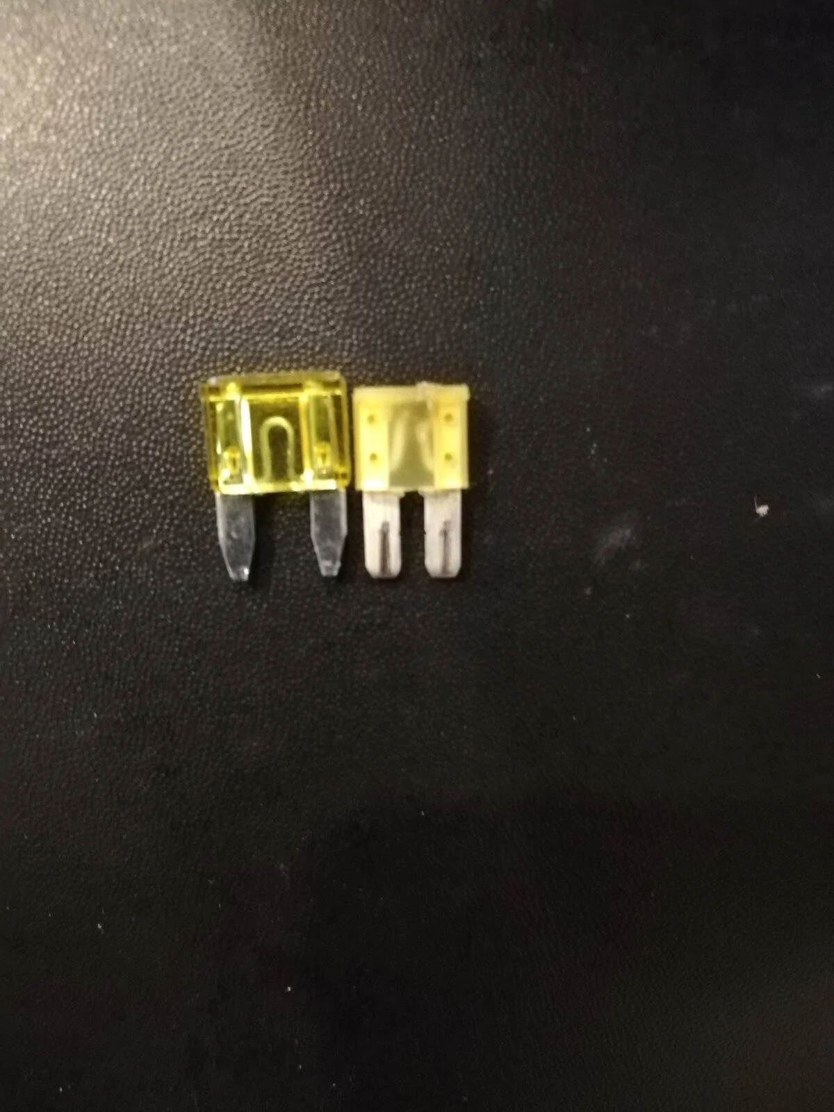

seems Wrangler use non-standard fuse, they are even smaller than my amazon ordered mini blade.
what is the size called? want to order a batch so keep it handy.

This is the comparison, right hand one with blown wire is the factory
Jeep Wrangler JL fuse is not standard mini blade? IMG_20210618_124158

Factory fuses are Micro2.
The left is a Mini.
