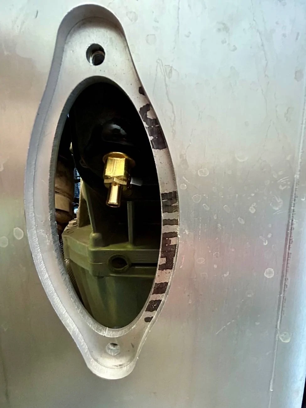

I have the Artec skid with a fumoto valve.

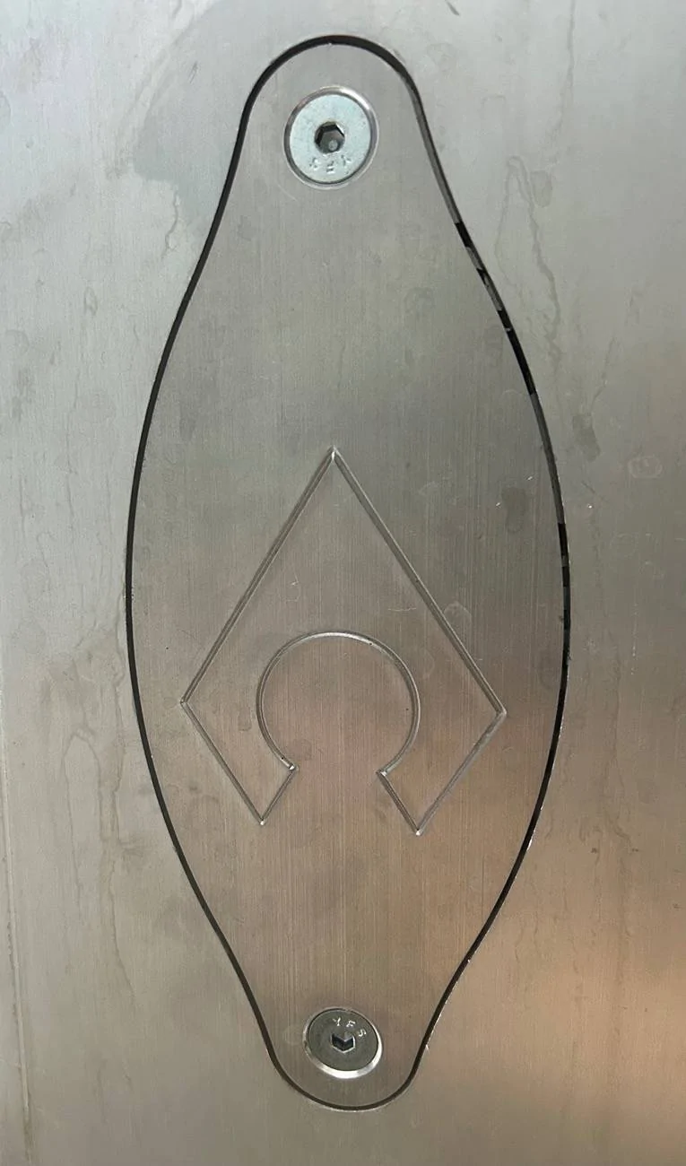

This is the shape of the opening - easy access for a oem plug or valve:
Jeep Wrangler JL Fumoto valve friendly engine skid plate IMG_4370
Jeep Wrangler JL Fumoto valve friendly engine skid plate IMG_4369

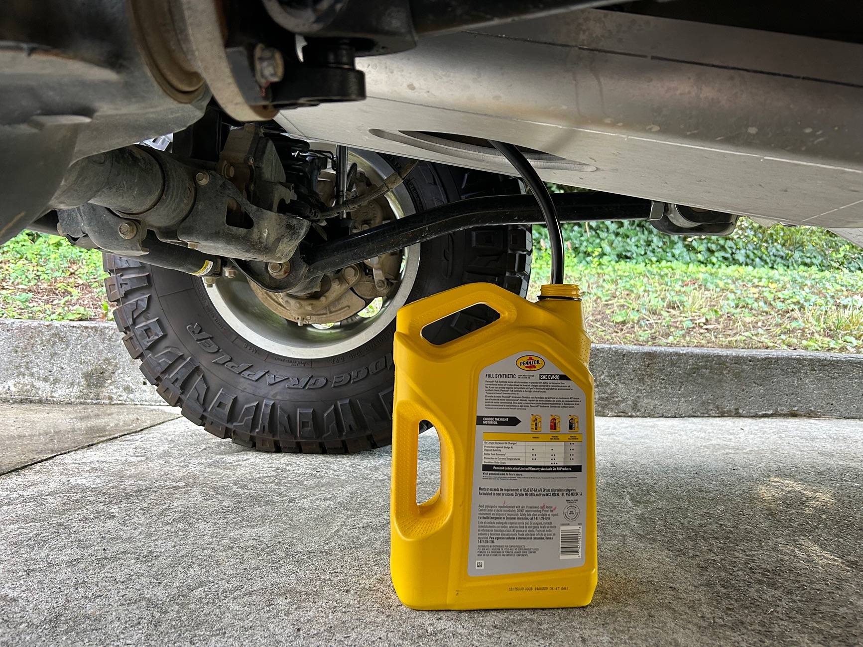

The valve kit came with tubing. Here I’m draining my oil into a jug. So easy!!
Jeep Wrangler JL Fumoto valve friendly engine skid plate IMG_5159

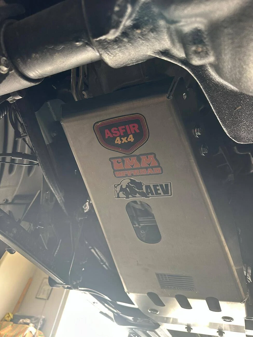

Ah true with the Fumoto. I have the Stahlbus so I have to get my hands in there at a specific angle to get the connector on.
The Votex is kind of the same way with the connector. Only difference might be gas vs diesel, considering a cat can easily sleep on top of the skid plate underneath the oil pan on mine. There’s days of room down there.

wild that Artec's is from neighbor state for 800 bucks but asfir is $466 n ships from israel
