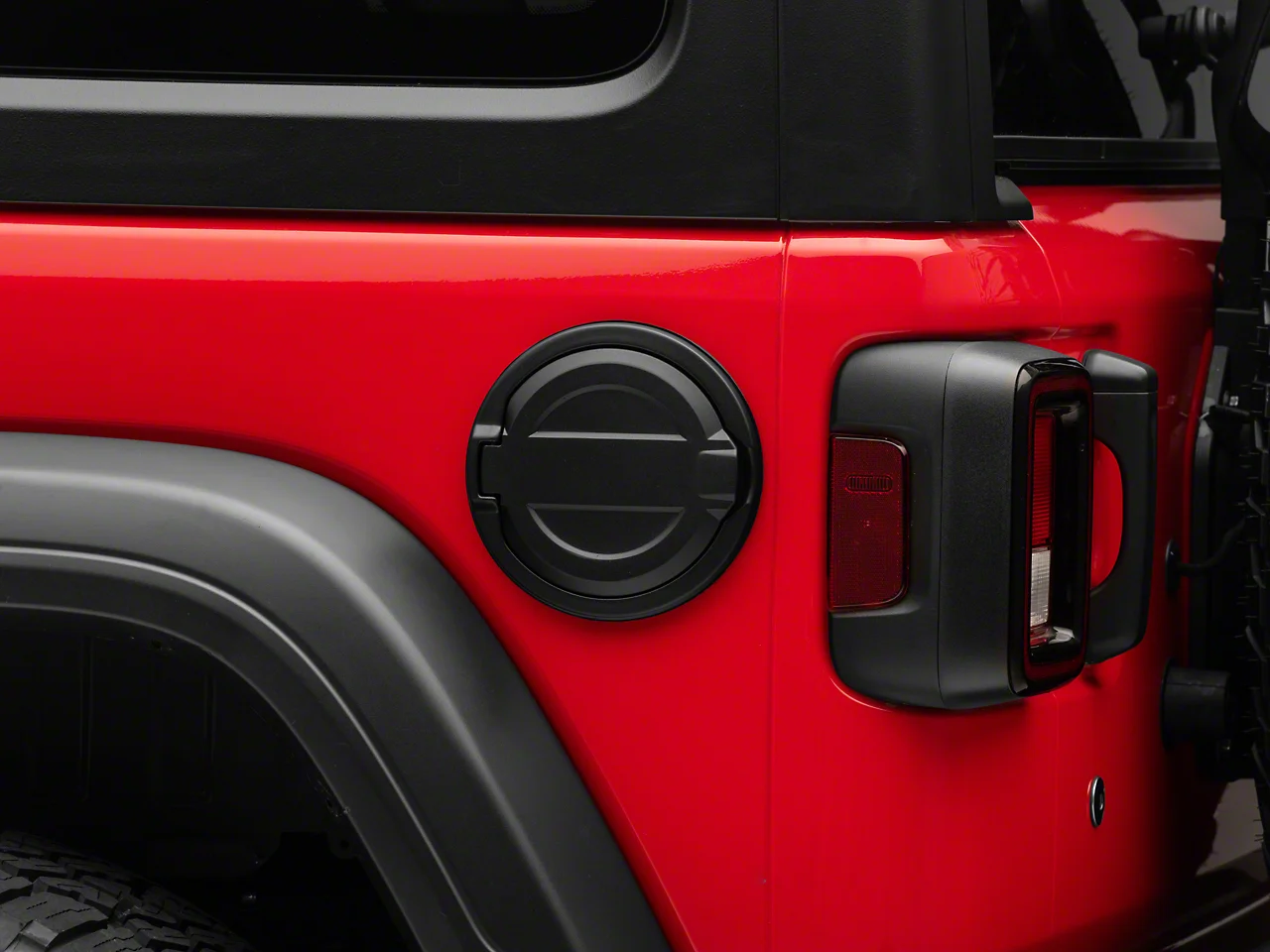

Wanted the cleaner look and bought the Redrock fuel door from Extreme Terrain.
Pulled off the rear tail light housing which is (supposed) to enable you to push in the tabs that hold existing fuel cap housing so you could replace it with the new one. On my 2025 Wrangler 4 dr, I'm finding braces in the way of getting close enough to press in any tabs.
Anyone made this swap, not wanting to scratch the paint around the housing.........another one of these not as easy as they make it out to be.

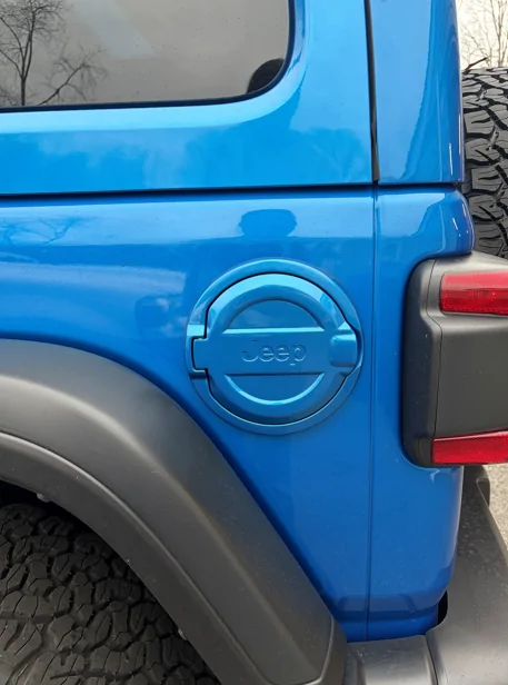

Replace my black one with an oem color match door. I use a trim tool to the closest two from the inside after removing the tail light. Once half would push slightly out, I use a trim tool on the remaining two from the outside. Replacing a door for a door, there is a rubber gasket between the door and the paint so use the trim tool between the gasket and fuel door. Not sure with no door to fuel door if there is a gasket.

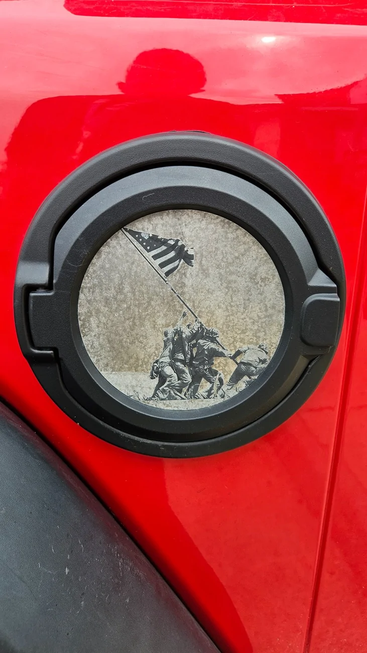

My Sport Altitude did not come with a door, so I had a custom one made to match her side mirror-back decals.
