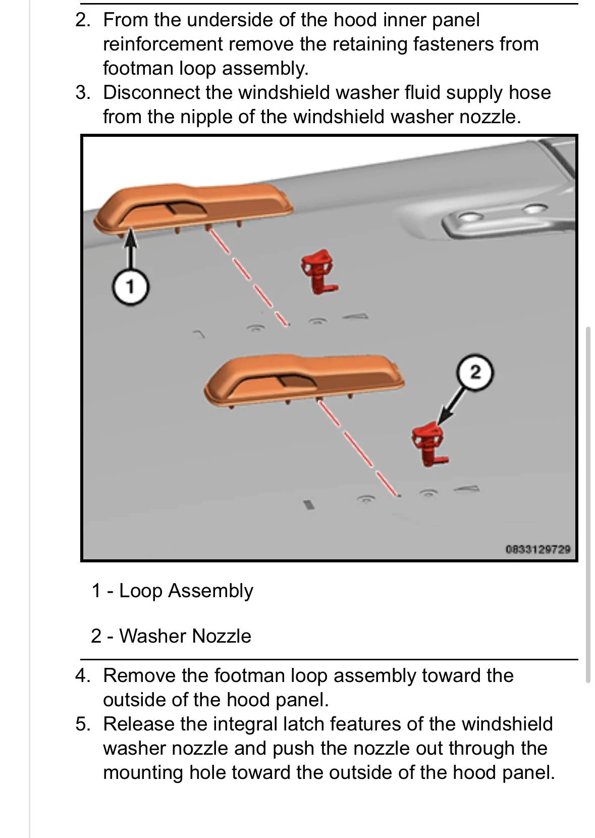

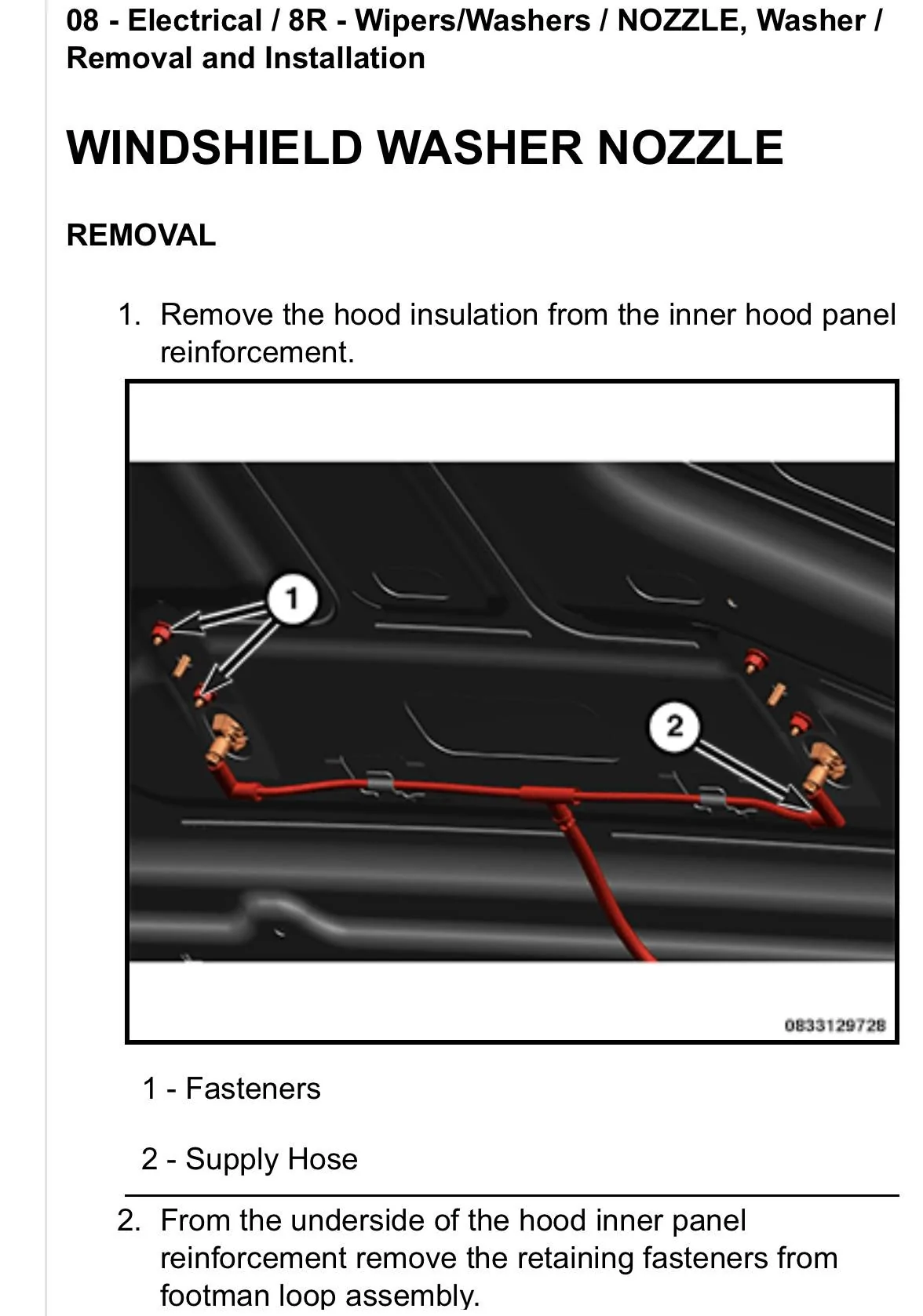

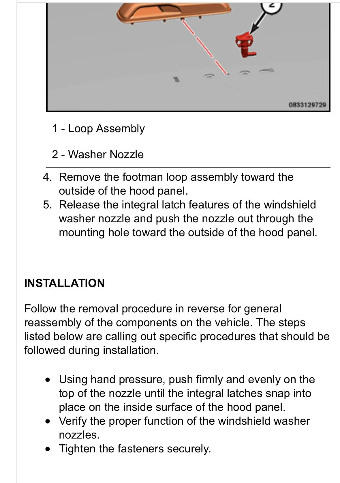

Hey folks-
I've been searching on the YoutTubes trying to find instructions about how to replace the front washer nozzle. Anyone has instructions about that? Or has done it and can give me step by step instructions? It can't be too difficult but last time I tried to figure something simple out, I ended up breaking a part which then cost me trifold... So this time, I am not going to attempt to re-invent the wheel.
Thank you in advance!

@Onward4x4
The diagram posted above by @fczabala is very good.
Nozzle replacement is not hard to do. Just be careful / go slow when prying off the hood insulation, retaining fasteners as the will/do break. Be sure to have a few fasteners on hand before you do the deed.
Frt. Mopar Nozzle-Windshield Washer 68293025AA
Rear Mopar Nozzle-Lift-Gate Washer 68293253AA
Mopar Hood Insulation Retainer 6504135
