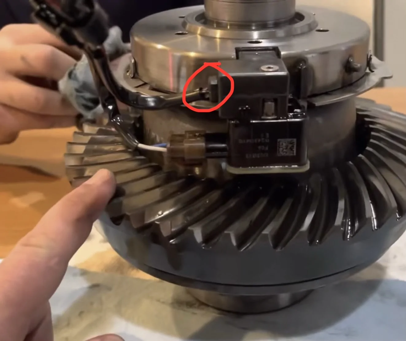

My front locker harness plug broke and will not stay firmly plugged in to the connector. How can I fix it?

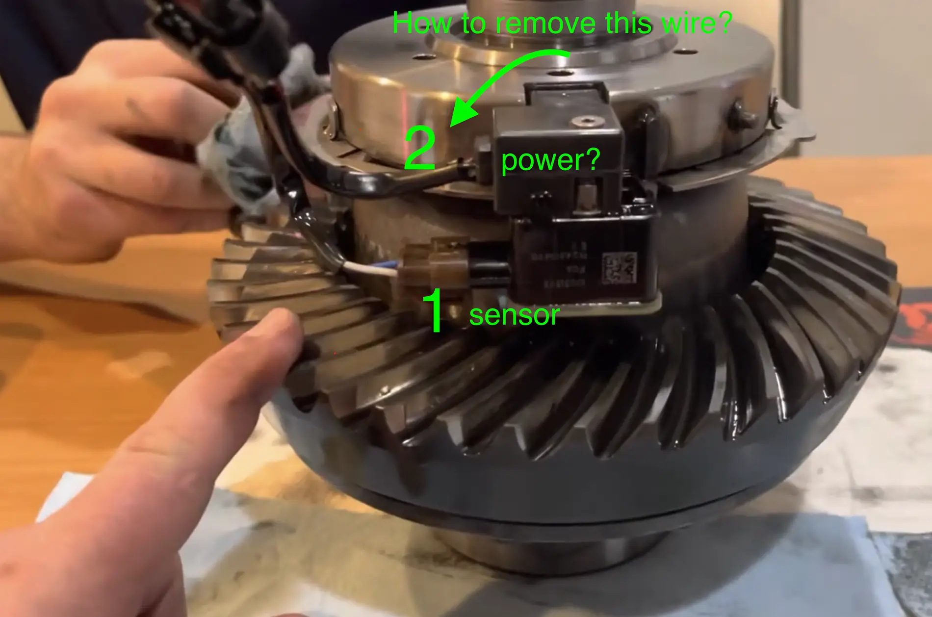

I’m seeing that the harness is actually a Y cable connected to both the locker position sensor and power connector.
it looks like once I unbolt the driver side bearing strap, I have better access to disconnect the cable from the sensor and power.
How did you unplug the power connector? Were you able to just pull to unplug it from where I circled in the picture?

What you have circled in red is the sensor. If your wrench is skinny enough you can get it in to the torx bolt on the top of your picture without removing the strap.
if what you have is a socket torx plan on removing the strap.
Once you unbolt the sensor and you’re holding it you’ll be able to undo it by hand.

But to get the whole harness out on the bench, it looks like I need to disconnect both #1 and #2 (see picture below). #1 is easy since it just unplugs from the sensor, but #2 looks hard-wired. You mentioned earlier that you unplugged the sensor (#1) and the locker power (#2)—did your #2 actually unplug somehow?
I really don't want to try unpinning the connector inside the housing, but if #2 doesn't unplug, it feels like my only other choice is pulling the whole carrier, which I’d rather avoid. How did you end up getting yours out on the bench?
Sorry for throwing so many questions at you! I’ve got the replacement connector on the way and just want to have a solid game plan before I tear into it. Thank you!

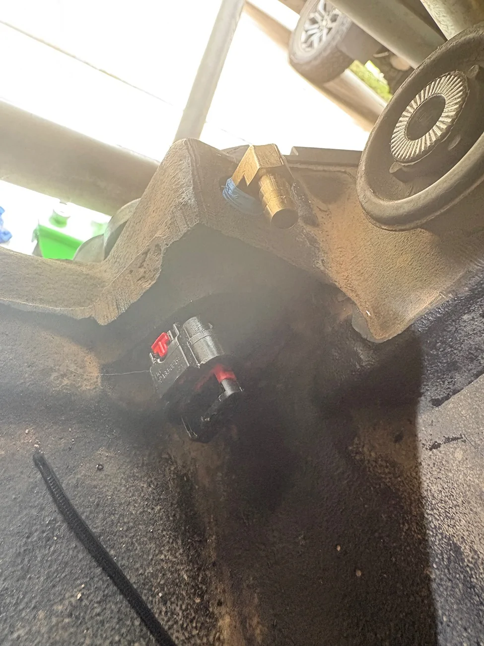

Broke my front locker plug a while back. Figured out you can just zip tie it connected. It's survived a week out in moab and some other wheeling trips, not a bad hackjob of a solution, lol
Nice’ How did you zip tie it connected?

Looking close yours looks a little different than mine. I’m driving a 21. I was able to unplug the power connection reaching into the diff.

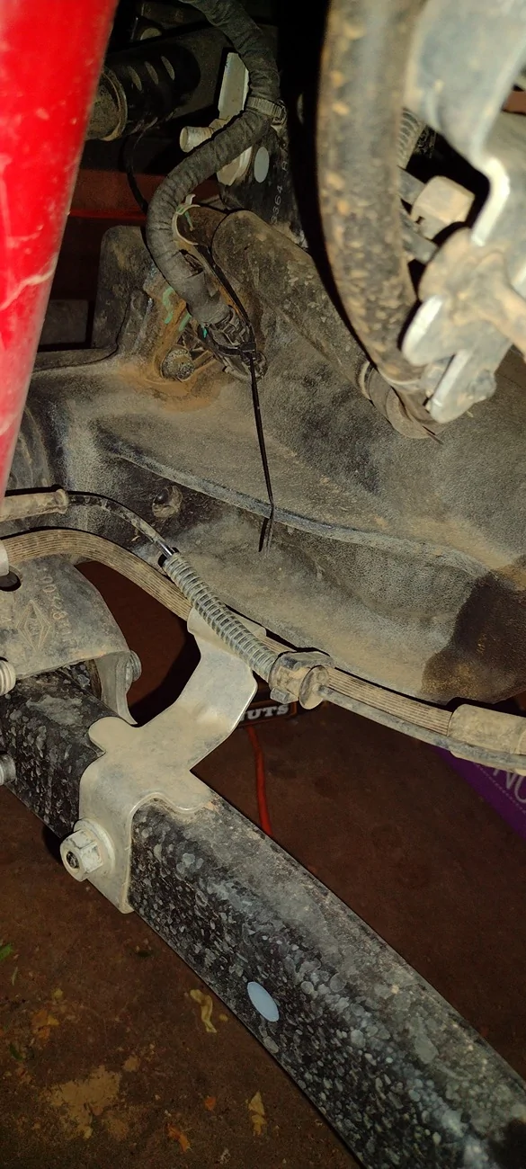

Ah, sorry, lost track of time. I just went around the backside of that breather just above it, and around the plug. This assumes your issues are the same as what I had (the plug is fine, just broke the clip part that holds it in). This is the best shot I could get with a 1-month-old strapped to my chest, lol. If you need better shots, I can try again tomorrow.
