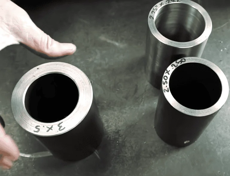

Correct, I think the R&P are still the JK ones in the ProRock 44. I haven't heard which is stronger. The JL ProRock 44 axle housing however has a 3"OD, .5" wall tube and the M220 is 2.75"OD with a .282" wall tube. ? on the air lockers and reid knuckles.
On my computer this time, so the Dana Ultimate44 is about .375" thick tubes (9.5mm). I looked up Dana's material for the advantek R&P, and they say it's "stronger" but rated for the same torque rating. They appear to be using the word "stronger" to mean same capacity, smaller R&P.

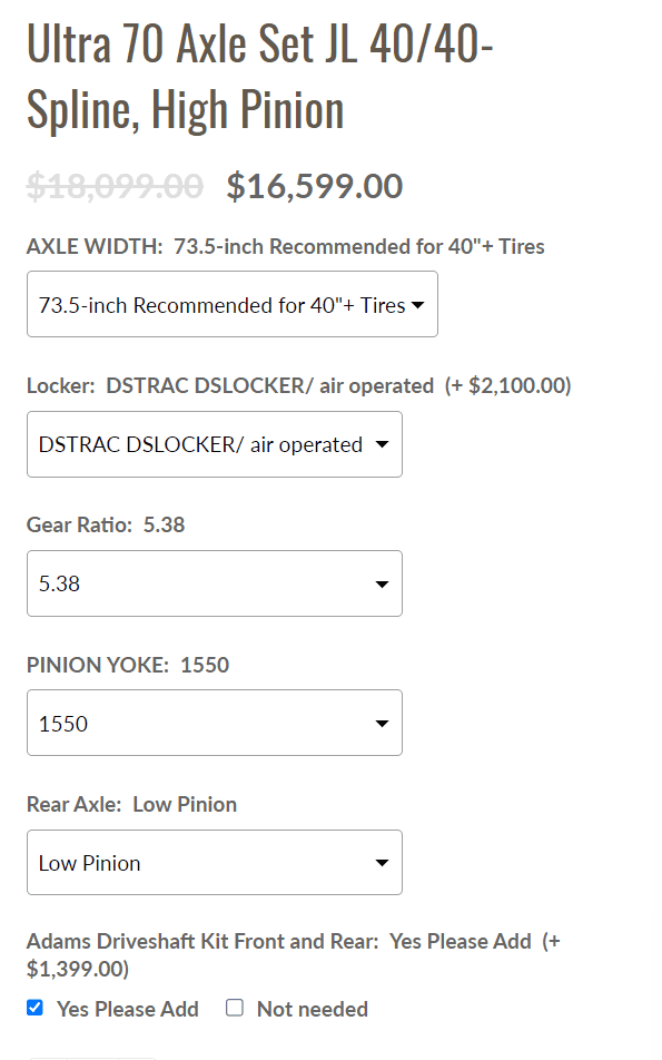

Sell both stock axles for $5K and pay $8.1K for the 40 spline, 73.5" wide DSTrack 70's. (Not counting the $2.1K for air lockers and $1.4K for Adams.)
Jeep Wrangler JL Front Axle, build it or buy it? 1662158276346
Email them, I'll bet they'd sell you just the front.
