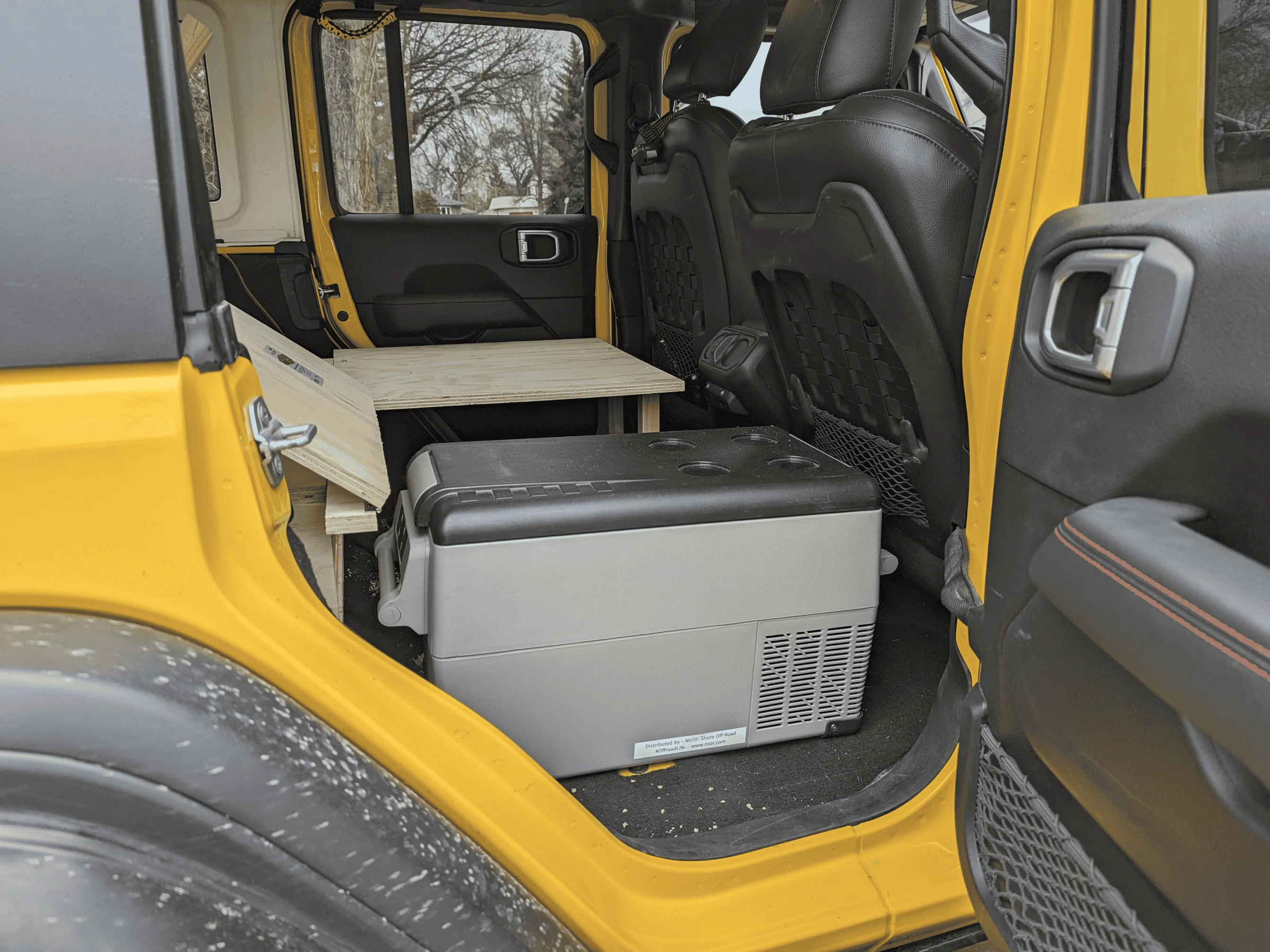

Just to clarify, you run that behind the drivers seat, where the rear driver side seat was? Did you leave the passenger side seats in, or do you think the cooler will fit with the passenger rear seats in?
It actually behind the passenger seat, but the space is exactly the same, I believe. I removed the entire rear bench. I could move the fridge to the driver's side and take a photo or two.

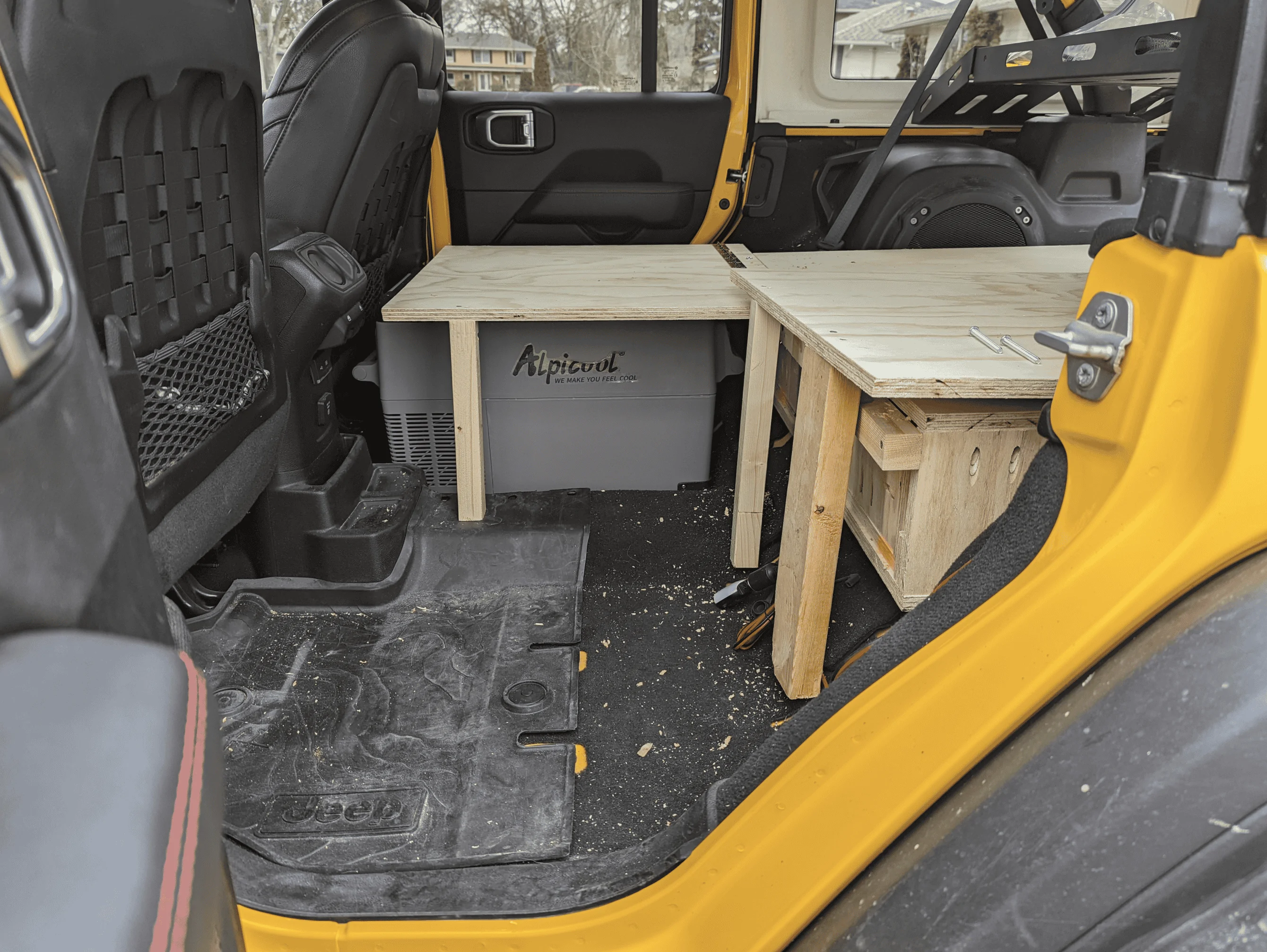

That's really good info to know. So if the fridge will fit with the rear middle, and rear passenger seat still installed, I will go ahead and order that fridge, or one that size or smaller.
If you don't mind posting pictures of where it is now, or even behind the drivers seat that would be awesome!
This is where it is now, taken during the build stage.
Jeep Wrangler JL Fridge to replace rear drivers side seat 1676577488581
gbr
Gerald
Nov 11, 2019
325
988
Canada
2020 JLUR
One more...
Jeep Wrangler JL Fridge to replace rear drivers side seat 1676577856527
