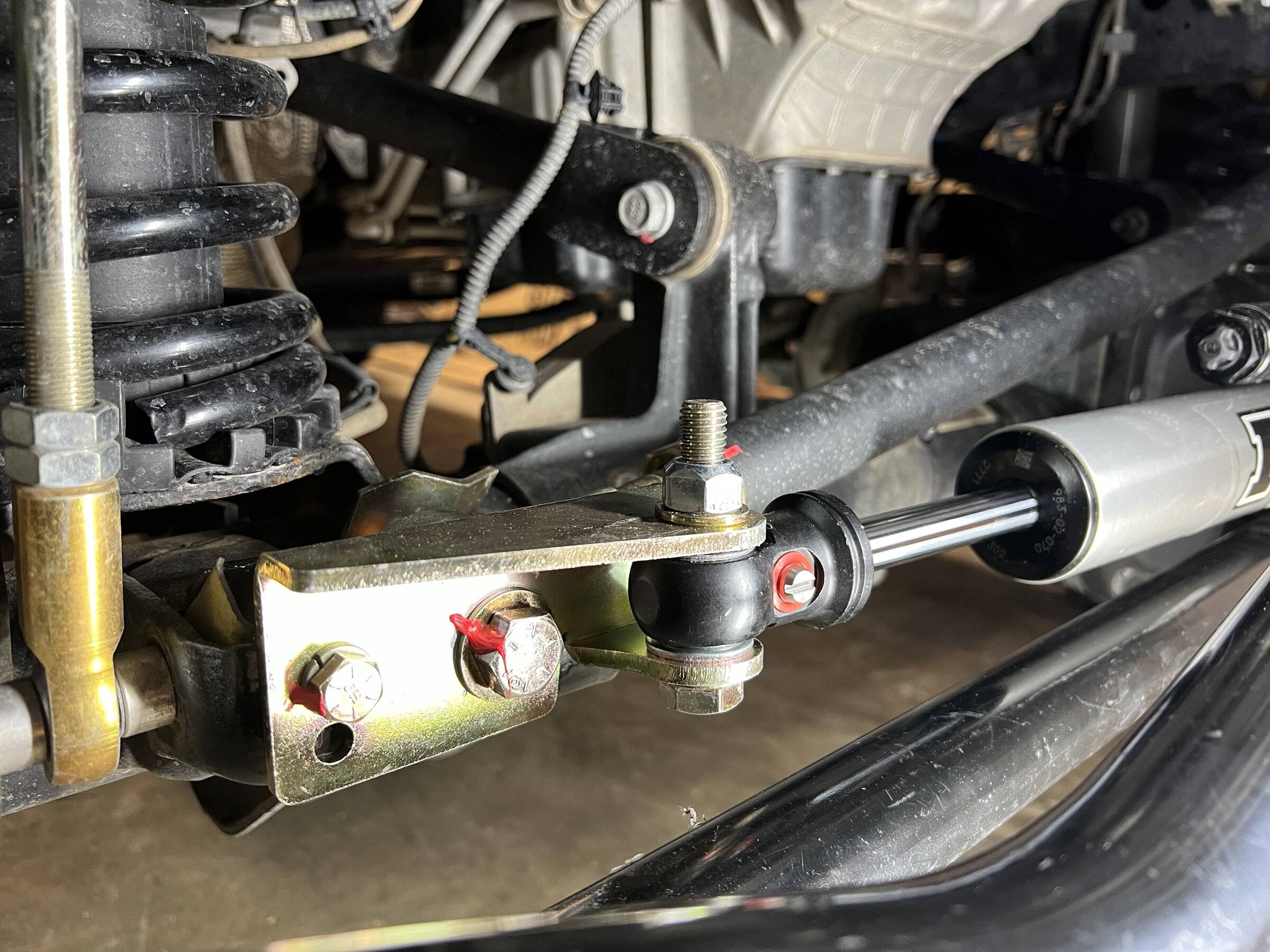

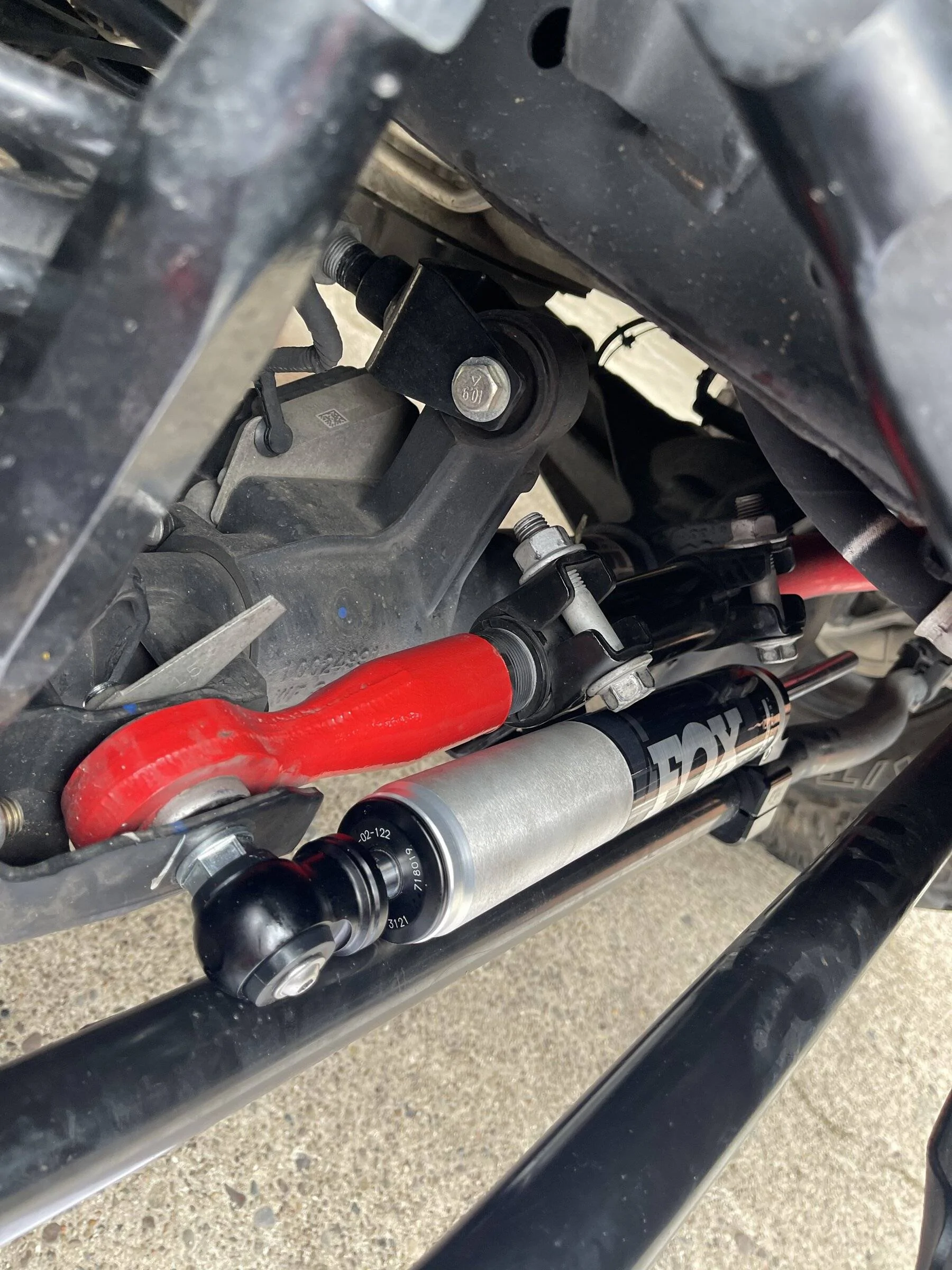

Ended up installing a rockjock relocation bracket and clearance is easy peasy now. Might have been able to get there with rotating and getting it just perfect but bracket got here early enough and I like that I didn't have to drill out the traclbar bracket. Overall gives just a little more room and keeps the stabilizer safe.
Also helped with the bump steer that I had going on so happy with the install overall.

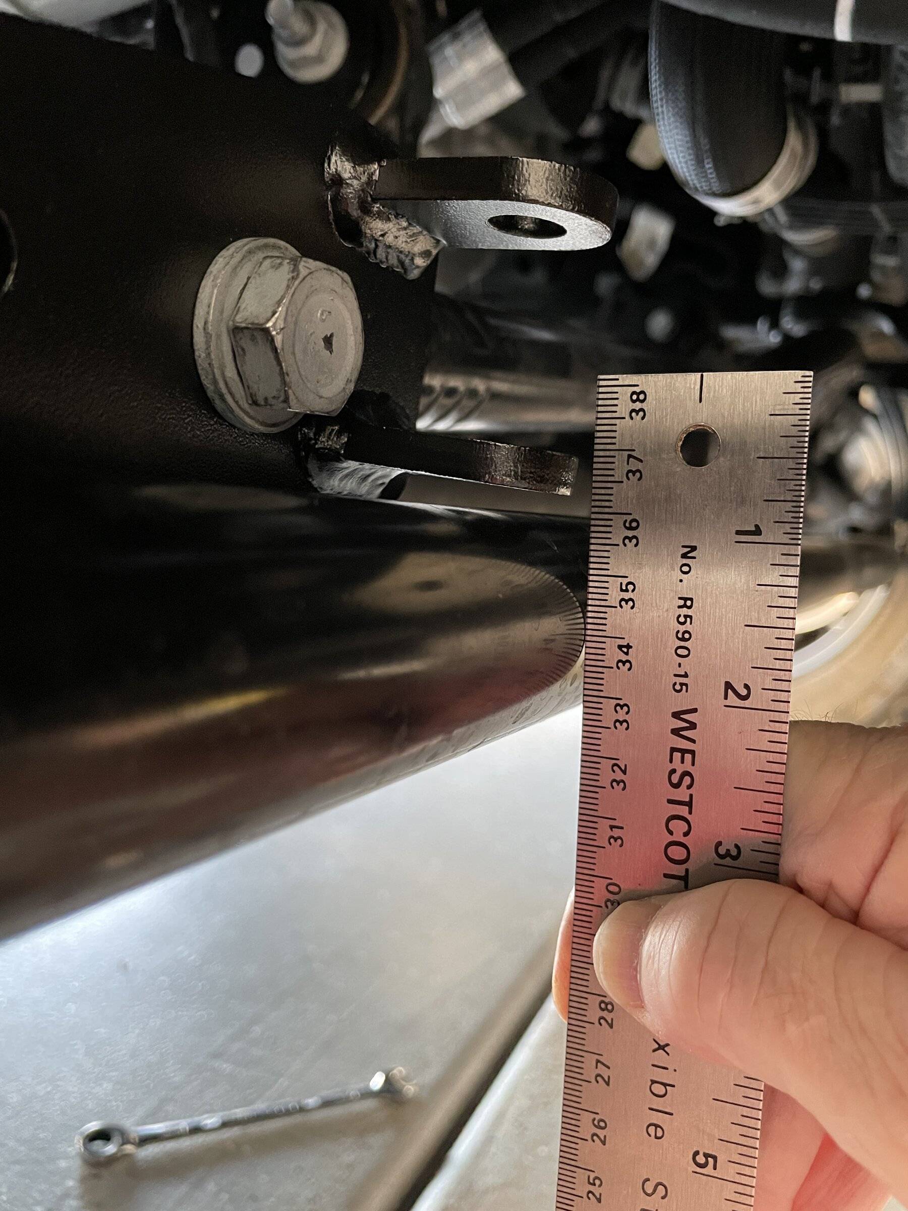

I concur with the fitment problems. I have tried both the Synergy and Yeti relocation kits and neither one of them will allow clearance of the stabilizer and OEM tie rod in full lock.. The tie rod floats up a good half inch at full lock. The passenger end of the OEM tie rod is a forged piece that actually curves upward about half an inch or so before it meets the horizontal portion of the tie rod. I tried all the suggestions that everyone has thrown out about rotating this or that and looked at all their pictures (all of which are shown with after market tie rods). On the Yeti, the bolt that attaches the stabilizer to the Yeti bracket won't even clear the tie rod at full lock, even if the bolt is turned upside down. Picture shows Yeti bracket installed and tie rod at full lock with only 4 mm of clearance. The bolt that is suppose to sit there extends much beyond that or turn bolt upside down and bolt head is thicker than 4mm.
I suspect that the factory tie rod rides further back towards the axle, and the aftermarket rod ends are longer to push the bar further forward. I'll have to remember to pull both my stock one and previous Steersmarts version out of the shipping container at work, so I can verify if that's the case or not.

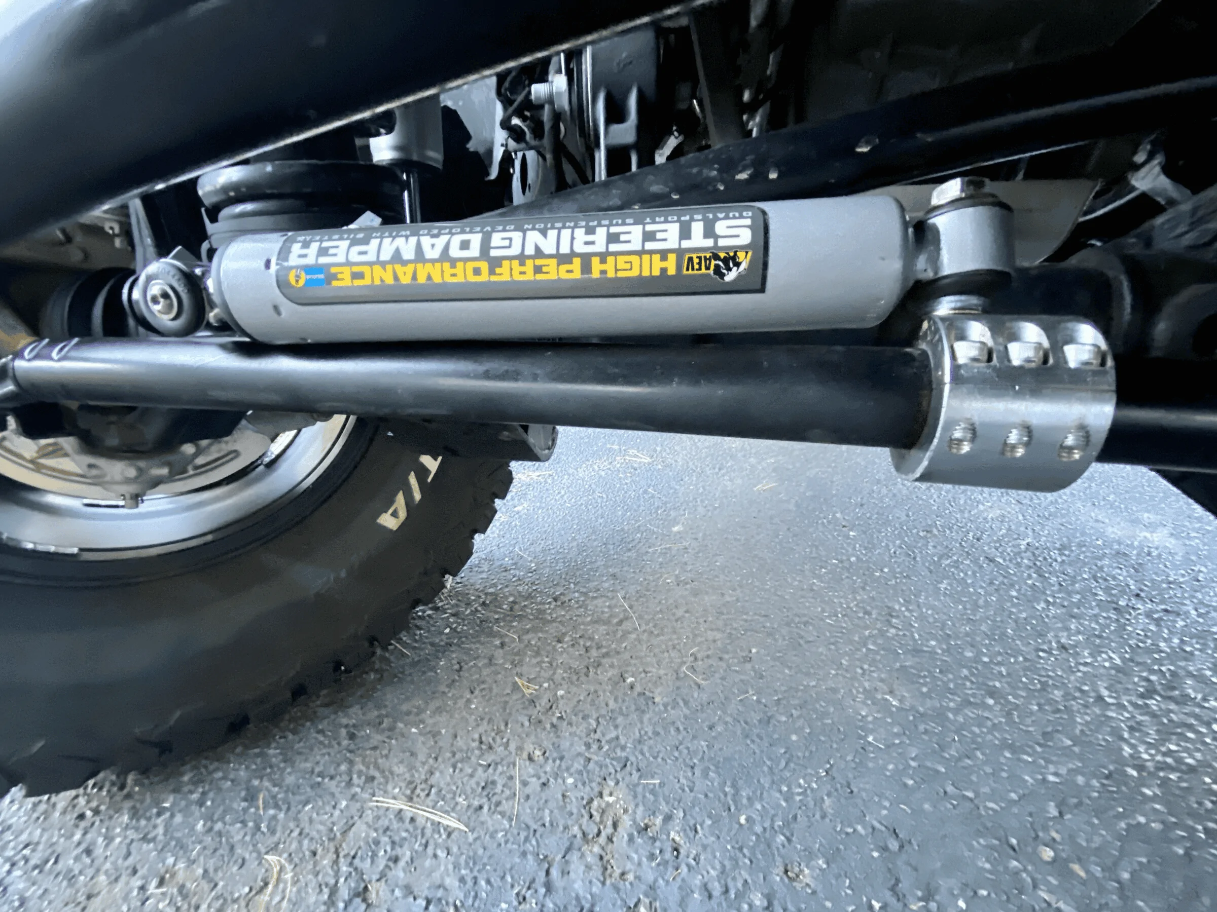

Here is how it looks with a monotube or twin-tube non TS stabilizer. Hits stock tierod with AEV, Teraflex and Factory OEM. RockJock braket on the way to fix it. Will ditch the AEV trackbar bolt, but keep the tierod clamp.

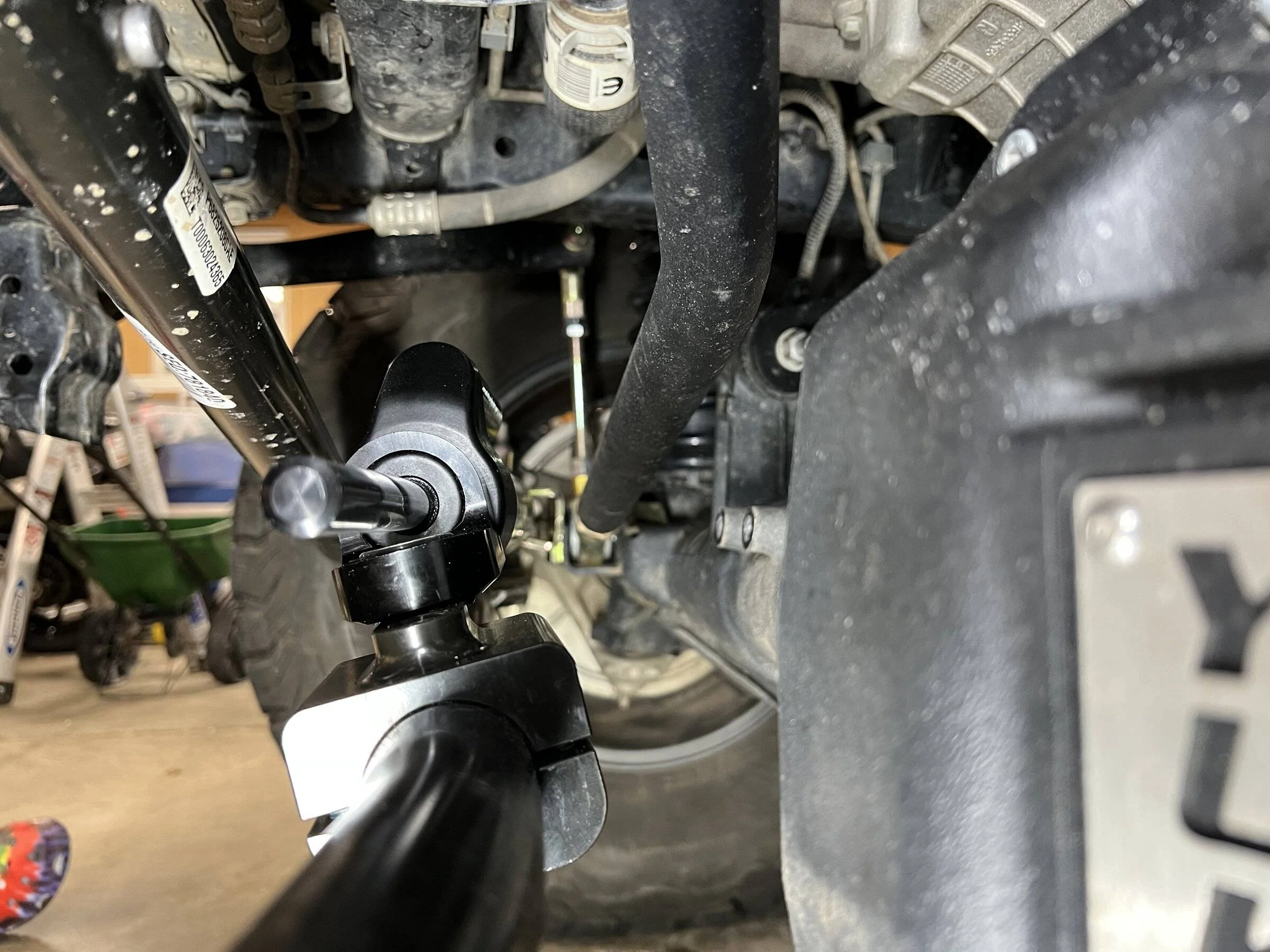

In case this helps anyone, the Clayton steering stabilizer bracket is compatible w/ stock tie rod and Fox 2.0 ATS stabilizer. I had to drill a 3/8” hole for a second bolt but everything fits securely. It clears when turning full passenger as well.
This might be short lived though as I see Steer Smarts Tie Rod and Drag Link in my very near future.

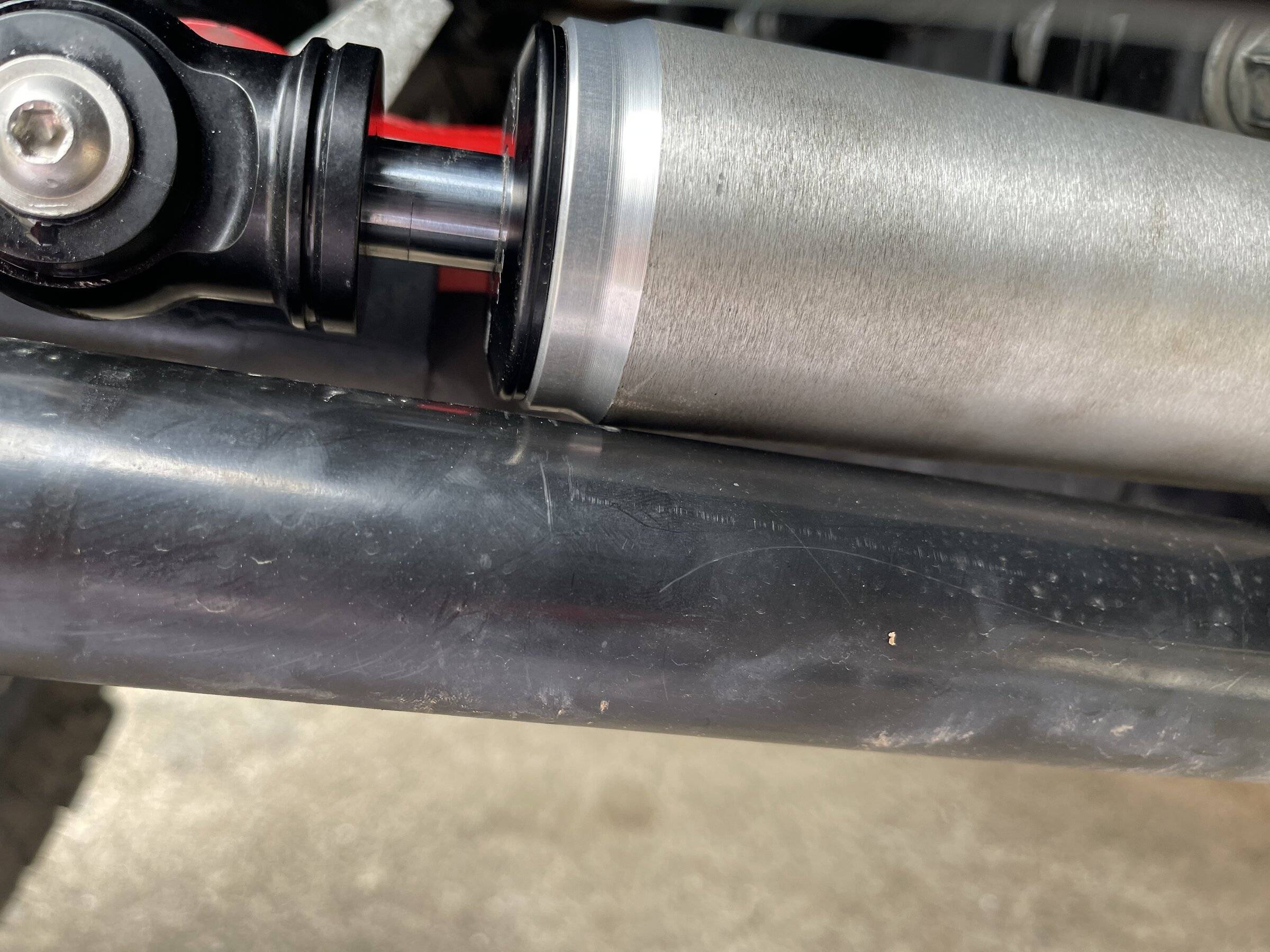

Mine is extremely close to the track bar and tie rod at full lock passenger. Any recommendations?

I couldn't get it to clear with the synergy post. Had to get a relocation bracket to get it all to fit without rubbing.

I was never able to get it without it rubbing something so I had to go back to stock. Once I changed my steering to the metal cloak system it wasn’t an issue anymore
