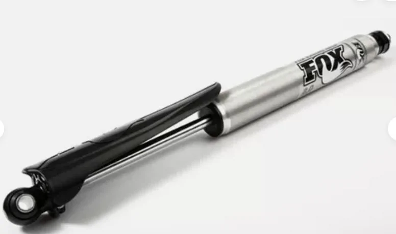

Just to confirm the closed side of the shield with Fox logo faces towards the front of the vehicle on both front and rear shocks once installed, right?

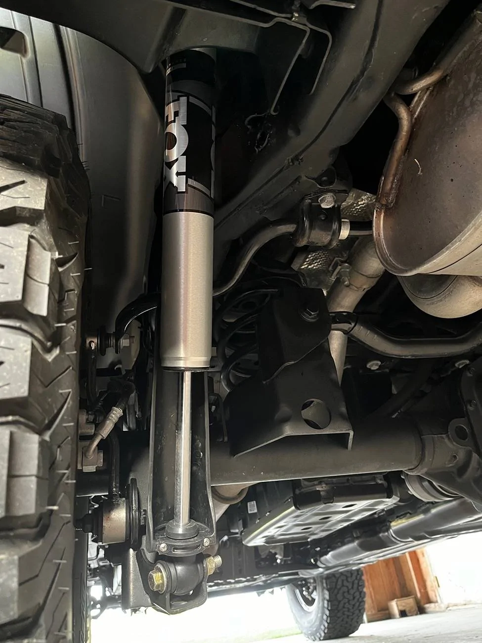

Yes. It’s to block rocks thrown up by the front tires.
Also, the small u shaped clamp piece you put the screws through to attach to the roost shield, drill out the holes so the screws go through them easily and not need threaded through. Once you thread them through and tighten them into the roost shield the shield will not be tight on the shock. Do not touch the holes in the shield, ONLY the clamp holes.
