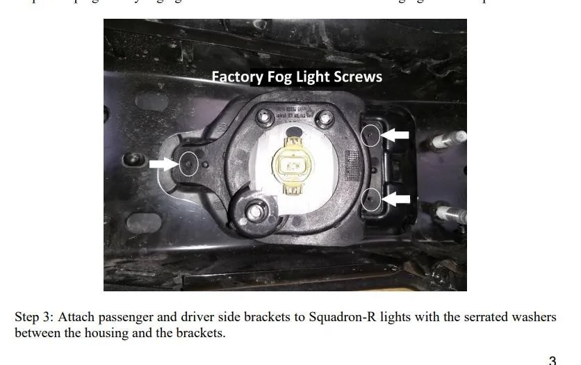

This is from the BD installation instructions for the Sport and Sport S bumper. Looks like what they accomodated in your bumper.

Yep that’s what it looks like, thank you. I was talking with a fellow forum member and they just got a set of oem leds. I guess that’s just what I’ll do. Thanks for giving me some information, greatly appreciated!

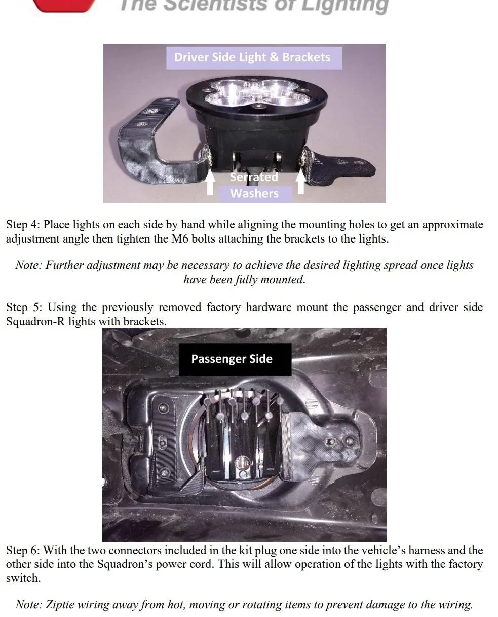

Next page of those instructions shows how they fit with their bracket. The brackets shown are apparently 3D printed plastic. But their production brackets are stainless steel.

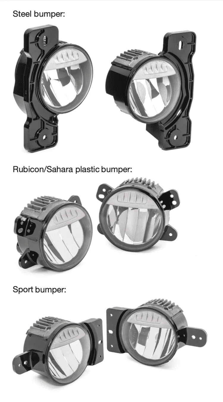

Hello, I have a 22 JLR with stock headlights and fog lights non led. I recently put a new steel bumper on my jeep and the factory fog lights do not fit. If I get a set of oem led fog lights will they just plug into my existing harness or is there something else I need too do?
Thanks for the assistance!
there are three different fog lights, you need the ones your bumper was made for.
