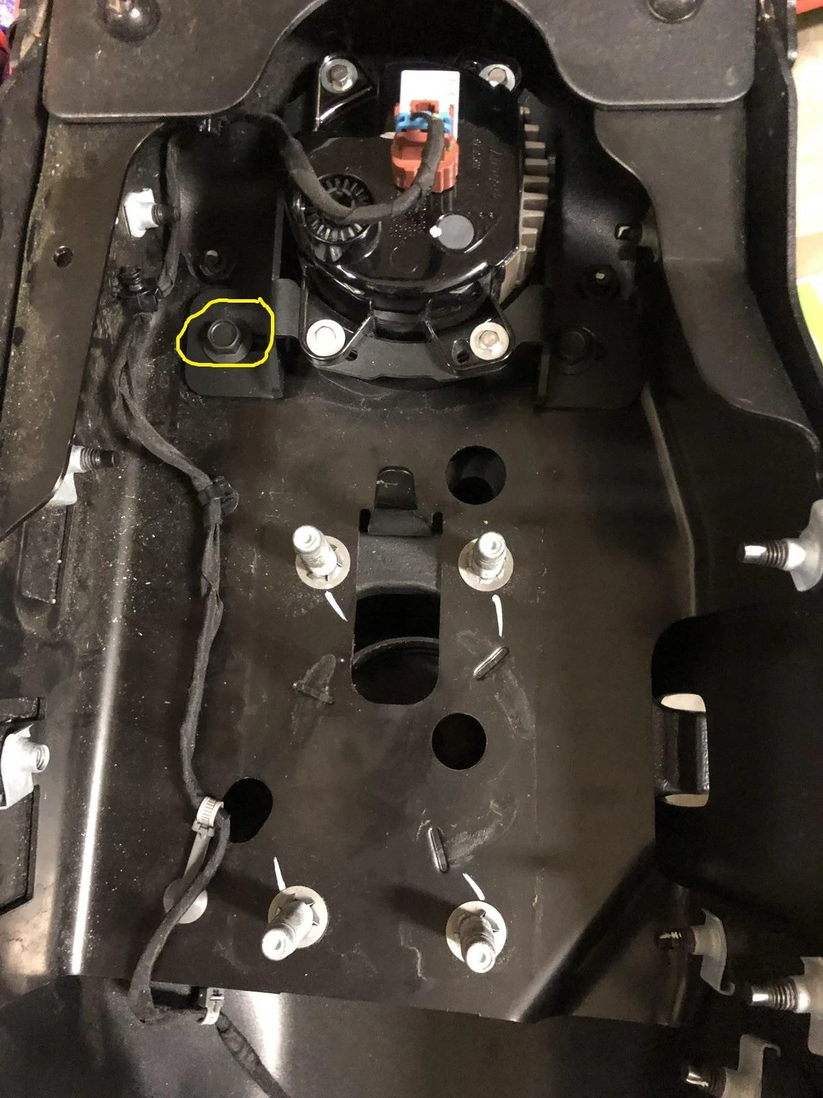

I have everything for my steel bumper swap. But I'm missing these mounting screws. Anyone have an idea the size or a mopar parts link?

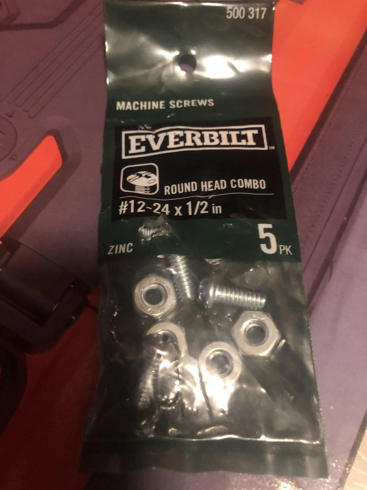

After Mopar and numerous dealerships just shrugged and said we don’t know and we can’t do anything to help you , I finally found the right size screws.
Jeep Wrangler JL fog light mounting screw F1ADBB68-E8B4-4E78-8370-A93B2969F387
I used just the screws to mount the Quadratec LED lights to my Rockslide bumper that uses OEM steel bumper screws. So these should work for you guys
