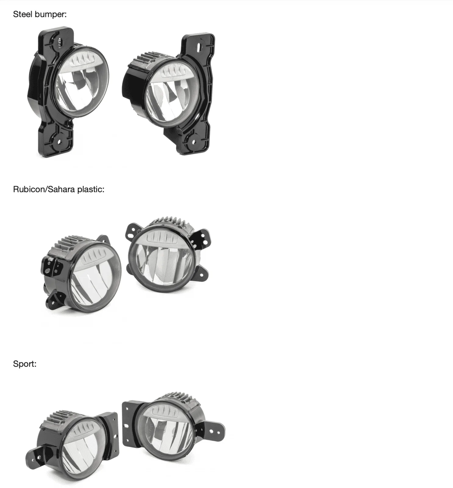

The base Sport bumper has the three tab mount setup, the premium models, Sahara/Rubicon have the four tab mount setup and the Mopar steel bumper has the two tab setup.

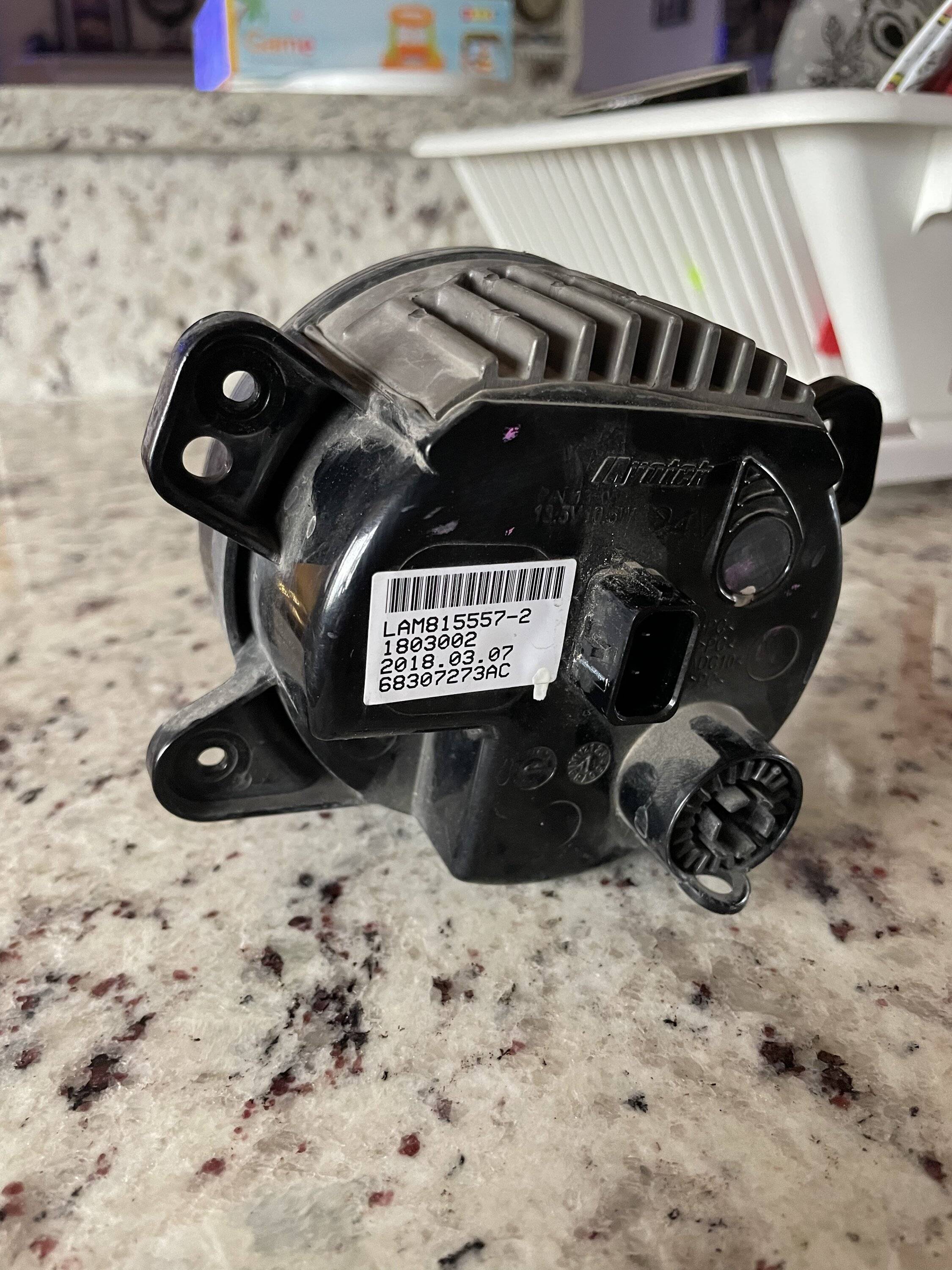

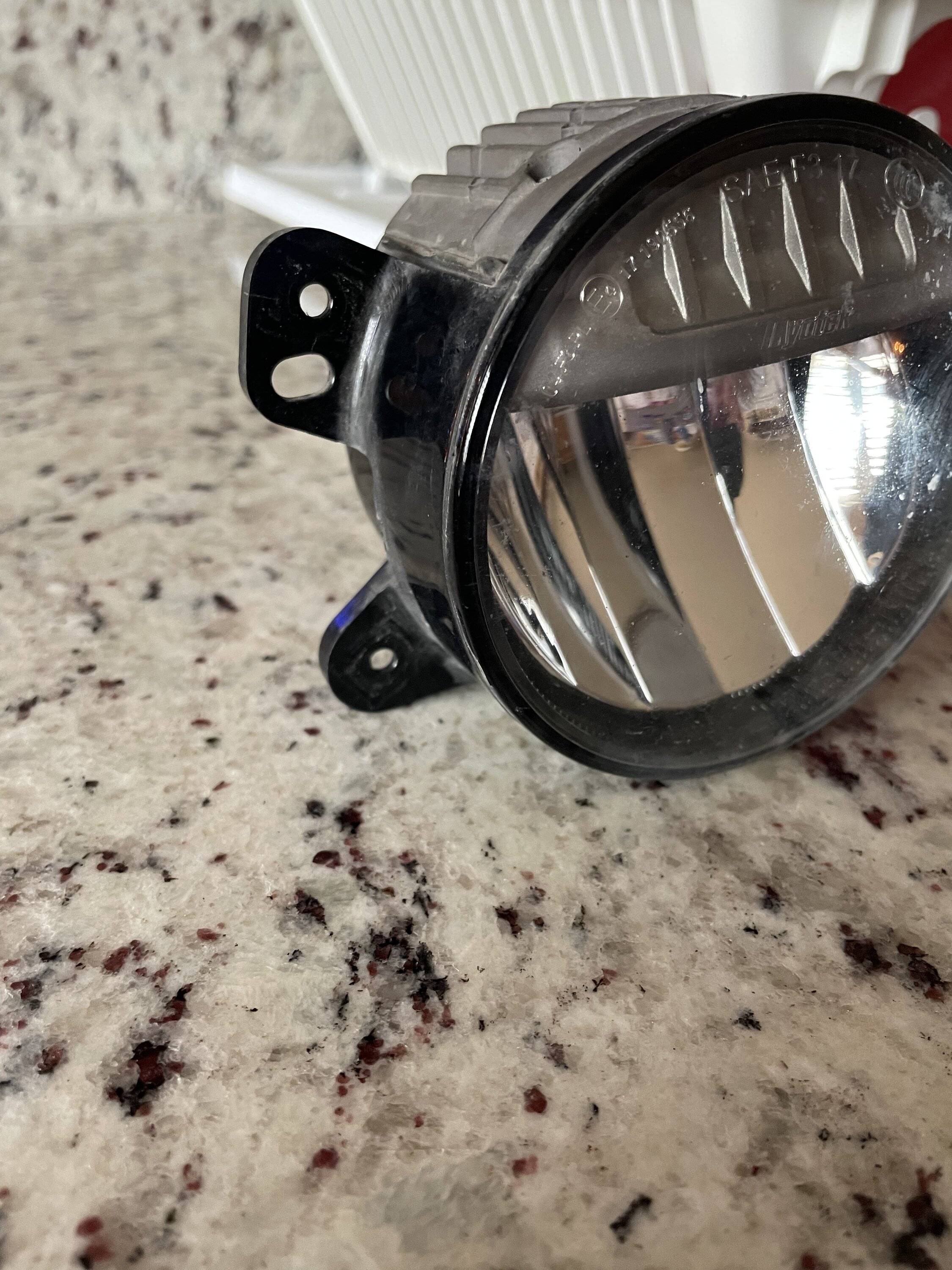

this is a four tab LED Fog light.
Jeep Wrangler JL LED Fog Light Mounting Question 118651B6-5B2D-4B3F-9794-BD8FA08B2D22
Jeep Wrangler JL LED Fog Light Mounting Question DE28265D-2154-421A-A334-A43D1B478649
the tabs are part of the housing.
