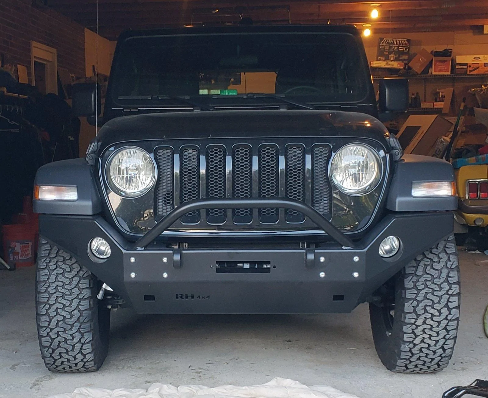

am1978
Looks good! Did you get your fog light wiring out of the old one?It's a sport so I'm wondering if they are different inside.
I just got the Rockhard Aluminum full width installed
I did get the harness out. I just pried between the steel and plastic so there was enough of a gap and it allowed me to get the harness out.Looks good! Did you get your fog light wiring out of the old one?
link to adapter?You have to unscrew all of the 15-20 little bolts/screws around the top and bottom of the bumper. Basically, you completely disassemble the bumper to get to the harness. You have to lift off the steel plating and remove the tow hooks too. When you see the harness, you then pull out about 10 little plugs that hold it in place, it's a real PITA. I did this last week so I could reuse my stock plastic bumper wiring harness and fogs on a Rubicon steel bumper (with an adapter which works beautifully btw). Good luck but it can be done.
Man I had to go back and search but here it is:link to adapter?
