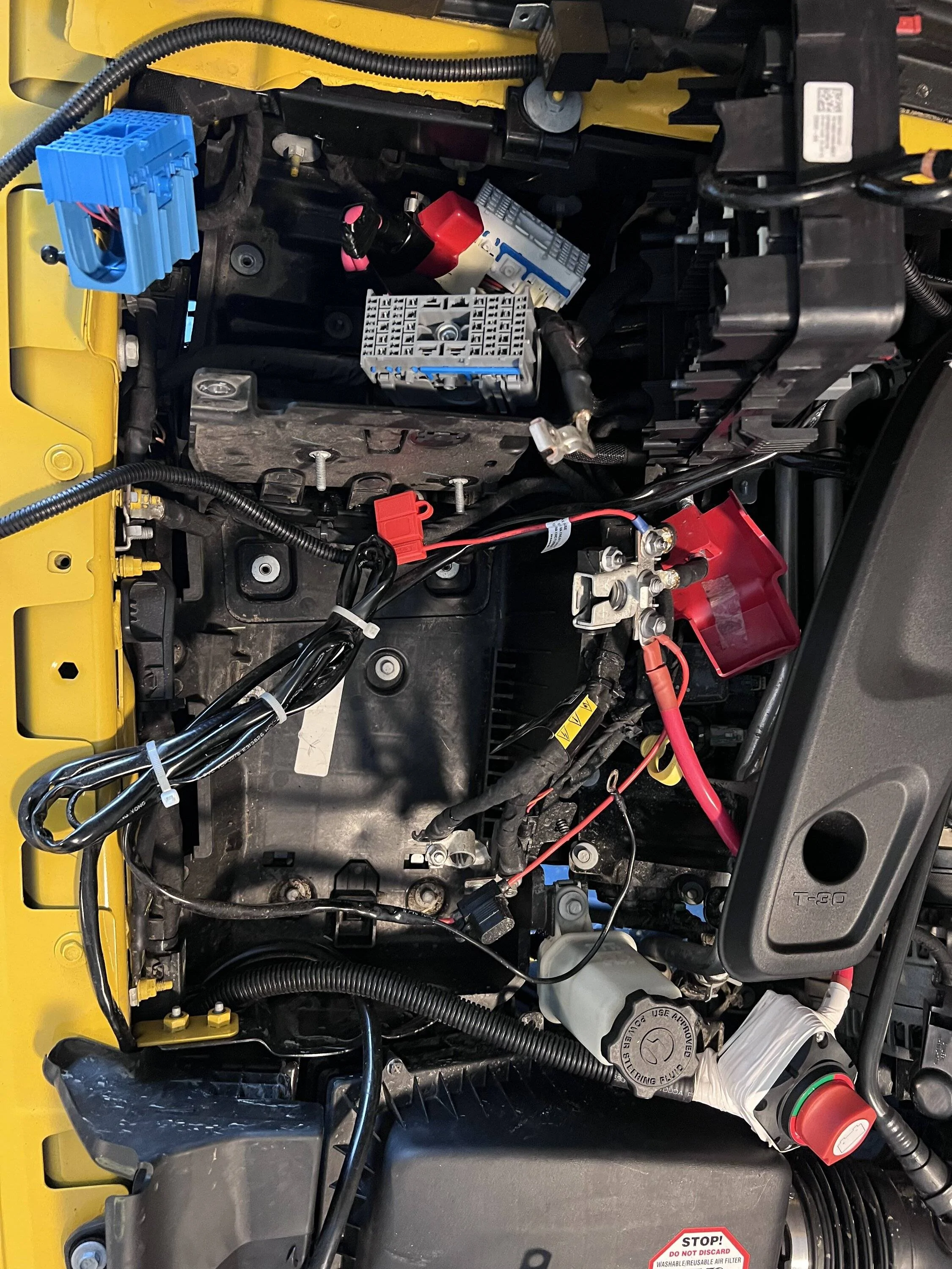

Excellent! I am going to run to AutoZone and get some new batteries and we will see what happens. BTW, could FCA designed the AUX battery location in a more challenging location?!?!?!

YIKES............. For anyone seeing this pic.... Do not dismantle your PDC to get to the Aux battery that resides under it. You could easily do a thousand $ plus damage doing the Aux change out this way..
Read here:
https://www.jlwranglerforums.com/fo...ent-the-easy-way-pull-the-fender-flare.56807/

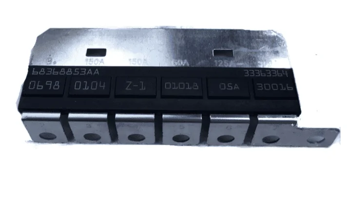

Looking at your pic and ... oh my ..... ...... anyway, good chance you have already or will be blowing a fuse in your high amp fuse array. Forum search with the words N3, blown, high amp fuse array.
If if the N3 blows, your alternator will no longer charge the Aux battery and you will see other issues...
So, FYI..... there are two different high amp fuse arrays.
Difference is one has a 60 amp fan fuse and the other has a 100 amp fan fuse. That is the only difference but yes, they are different and you need to keep this in mind.
By the way.... having the tow package is what dictates that you use the fuse array with the 100 amp fan fuse.
68368853AA Mopar Z Case Fuse Array (has the 60 amp fan fuse) and 68368854AA
Mopar Z Case Fuse Array.... (has the 100 amp fan fuse)
