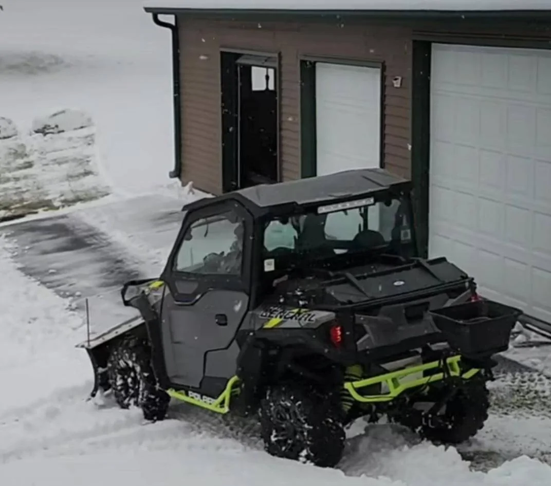

Nice job!
After our last derecho ( look it up) I had a huge limb break and hang down in one of my Hickory trees right behind my house.
I was able to drive my Polaris General up to it and hook the winch cable around the topmost branches- which were now almost ground level.
I had to back down the hill playing out the cable to give myself room - then used 4x4 and yanked it down. Super handy and a heck of a lot safer than trying to use a ladder and chainsaw...
Fortunately Hickory makes great wood for the smoker...
