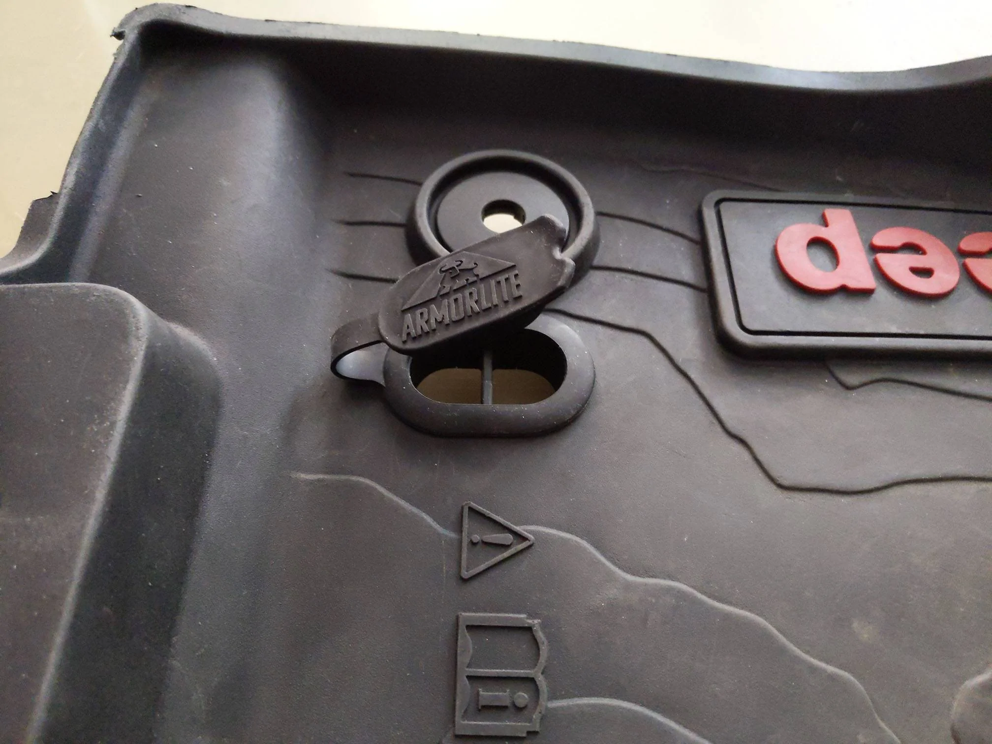

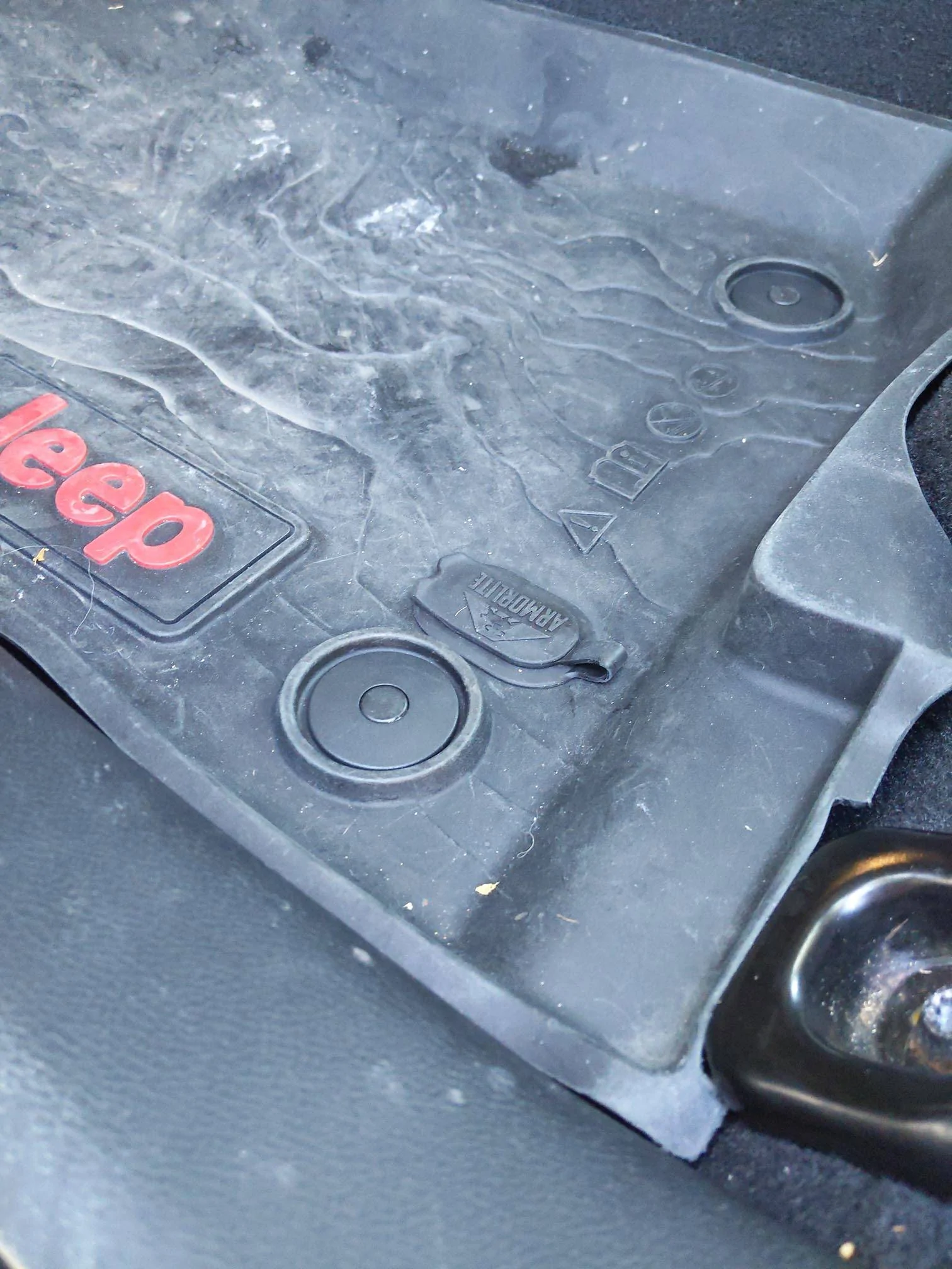

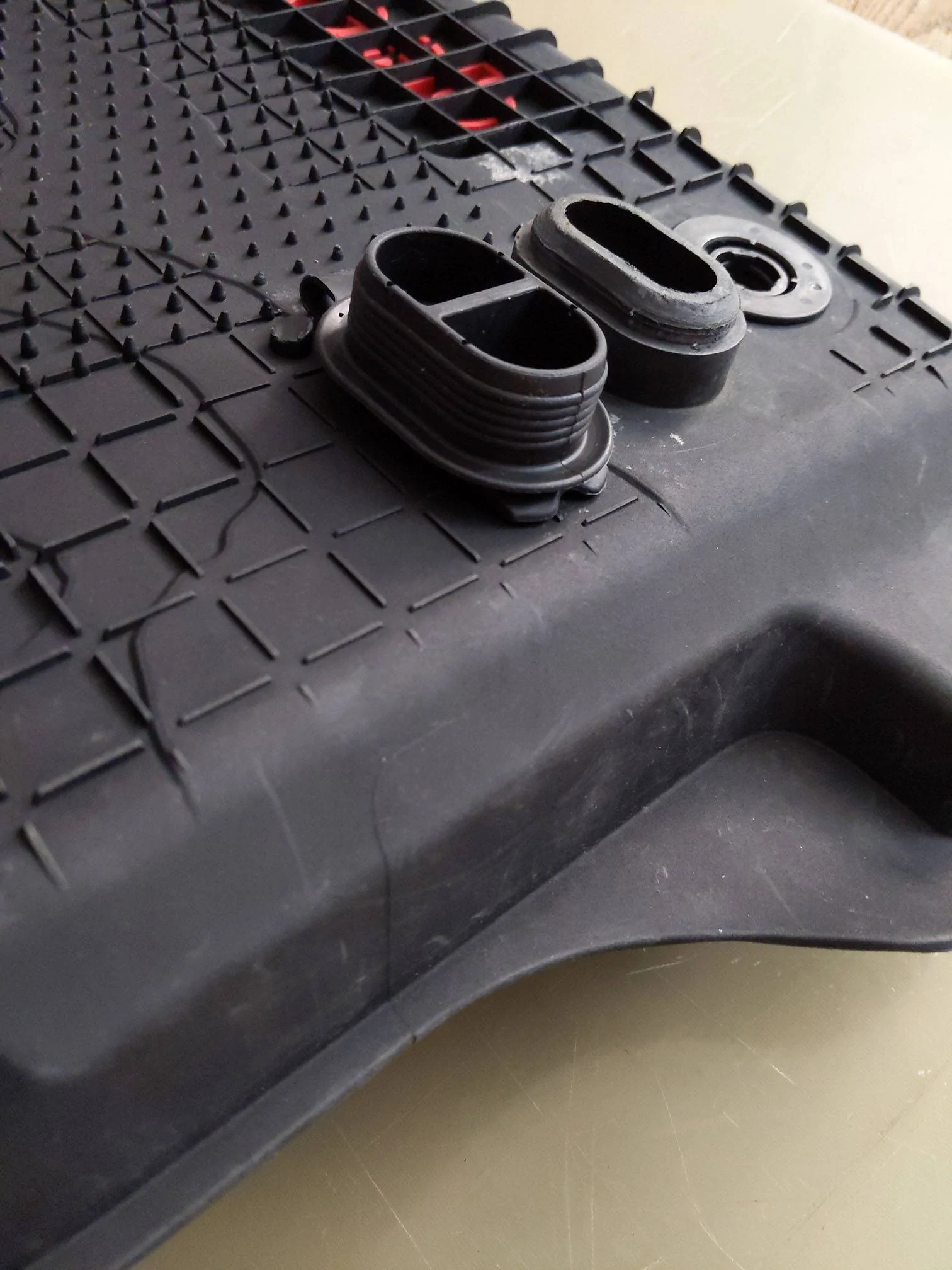

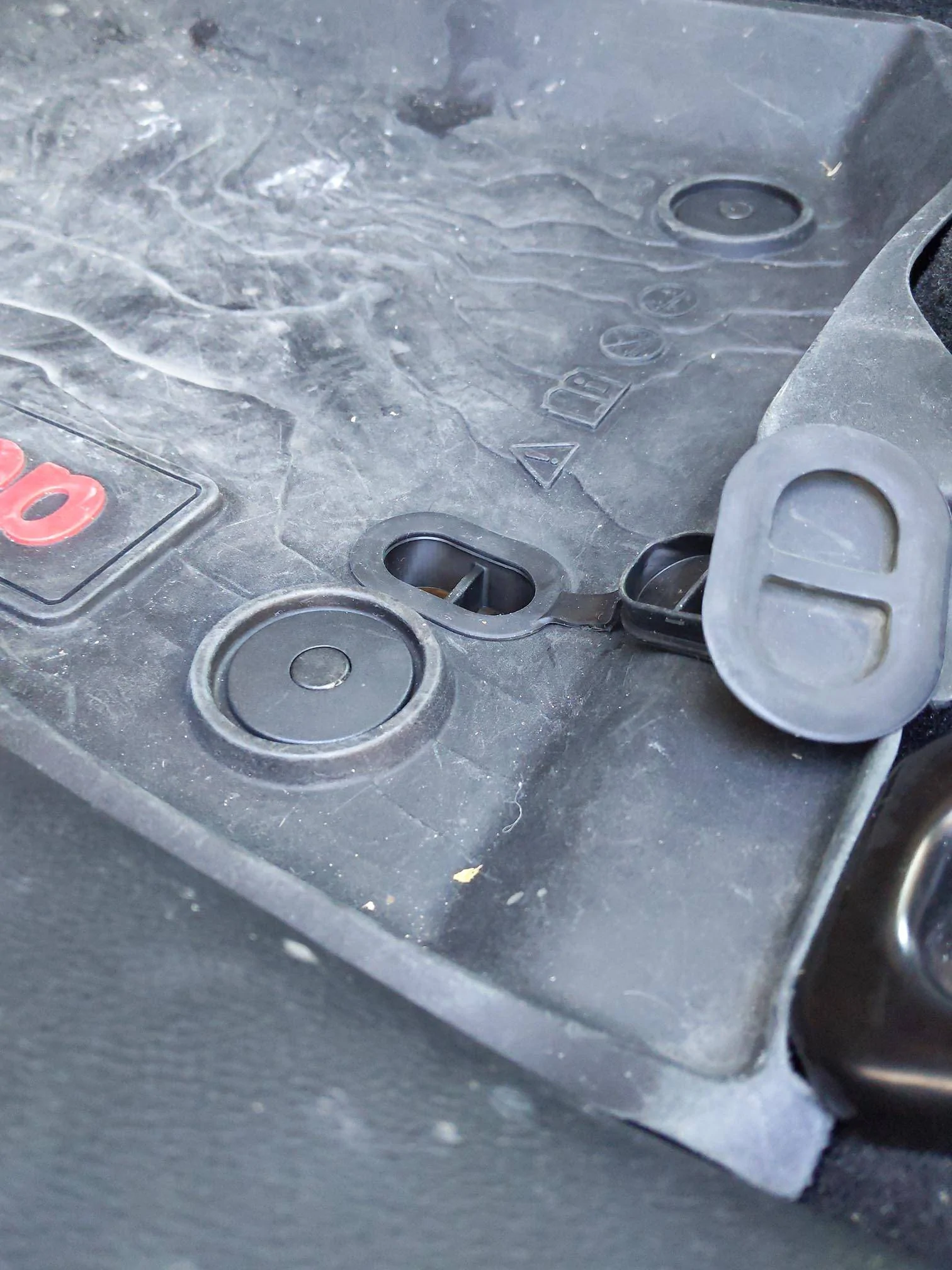

At some point my JL developed rain related water leak. I have the factory all weather floor mats with the built in drain, but the water was seeping in under the floor mat and carpet and the floor mat drain was plugging the floor drain hole, preventing the water from draining out. Some have cut the drain out of the factory floor mat, converting them to a regular flat floor mat, but I like use the drain in the winter to let the melted snow out.
The Armorlite flooring in my JT comes with removable floor plug/drains, so I ordered some of those to use with my factory all weather floor mats. Now after cutting off the factory drain off, I can convert them from having a drain to regular flat floor mats. When I want a regular flat floor mat, I remove the Armorlite plug/drain and use the flat floor drain plug. I plan on using the drain just for the winter.

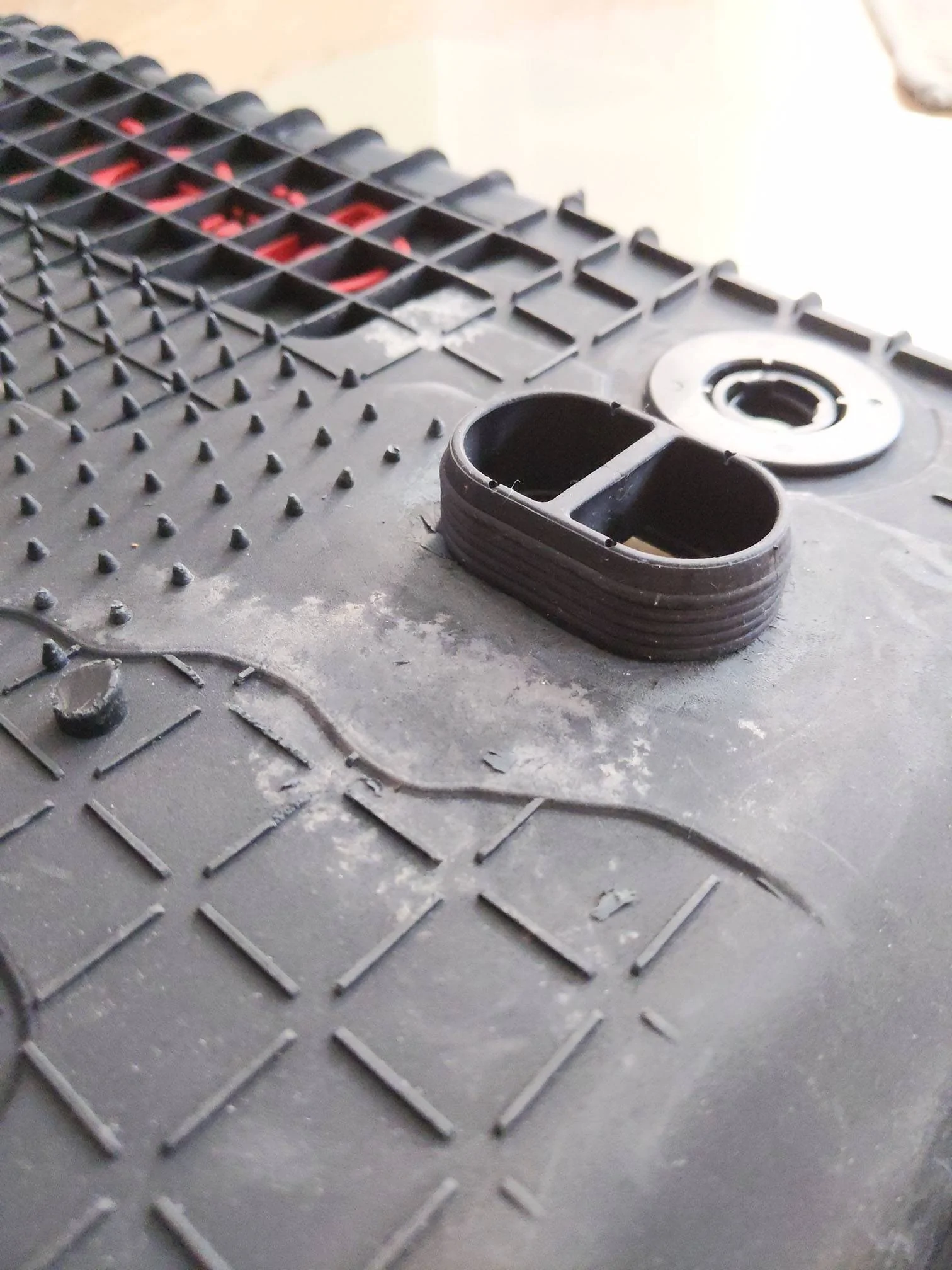

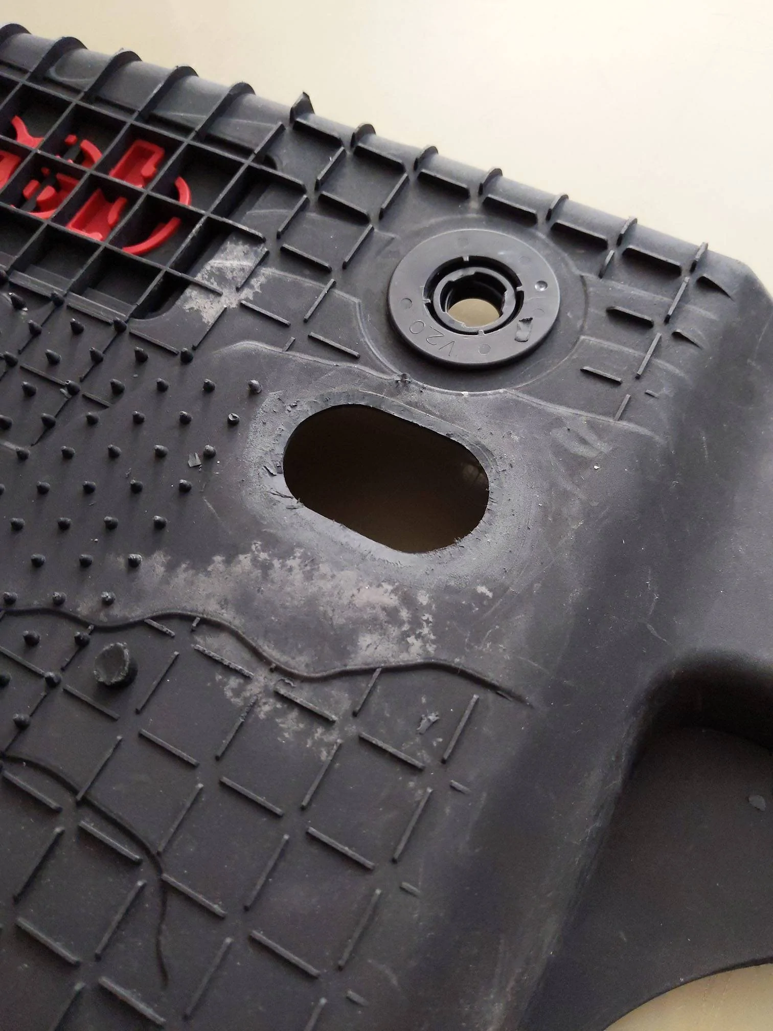

Here's pics of the installed floor mat. Pressing the plug/drain in to the floor drain hole creates a low spot in the floor mat, I don't think draining water out will be an issue.
