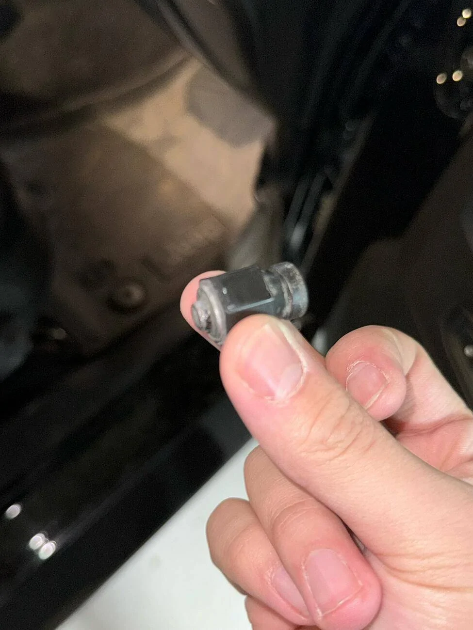

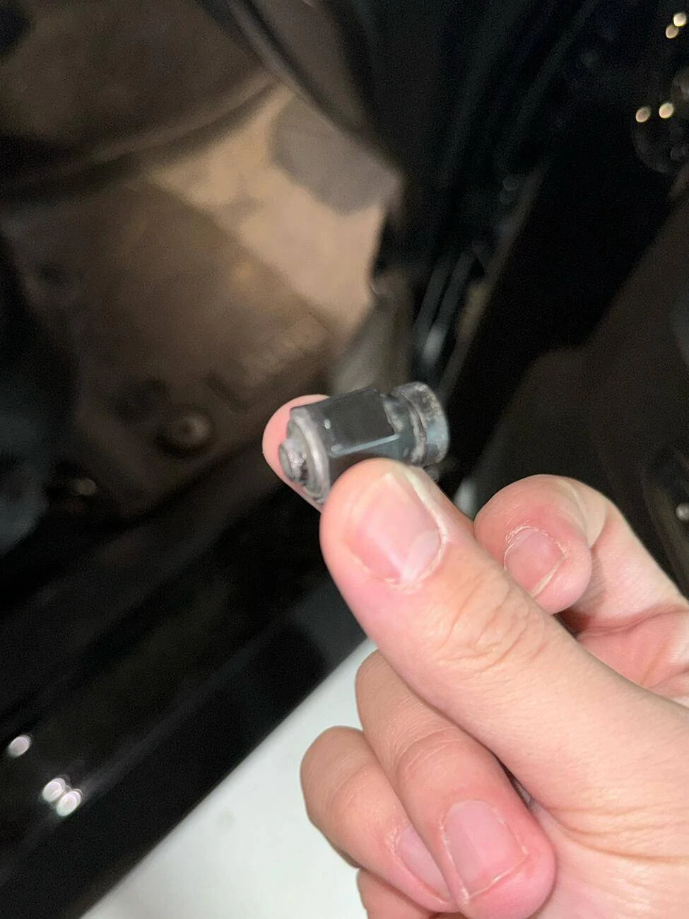

The metal stub on mine is broken...
Does anyone know about the part number? or is it even replaceable?
Or is there any specific type of glue can fix it?

Anyone could identify the part number?
Jeep Wrangler JL floor mat anchor broke tempImageyp8FLx
Jeep Wrangler JL floor mat anchor broke tempImagequfasP

There seems to have been a revision along the way so for those reading please note this does not apply to all JL's. Jeep moved from a metal stud design to a flat plastic clip design.
For those looking for the stud it is actually welded into the floor pan and is part # 6511326AA
Jeep Wrangler JL floor mat anchor broke 1755647888872-4k
And to reiterate the post part # is 6MJ08TX7AB
Jeep Wrangler JL floor mat anchor broke 1755647938936-ed
Thank you,
- Benny
Thank you,
- Benny
