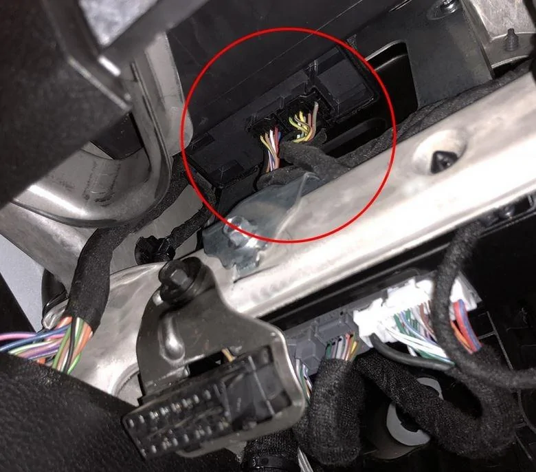

anyone who has a Flashcal can you help me out. I spent 20 minutes in a very uncomfortable position trying to find the gateway bypass plugs. I have a JLU rubicon and can’t for the life of me find these. Definitely not matching up with the picture in the manual.
If you can attach a pic of yours, would be greatly appreciated.
Thanks

Pull the plastic panel just below the steering column off. Comes off easy. Remove and you will see the target right in front of you. It is directly above OBDll port.

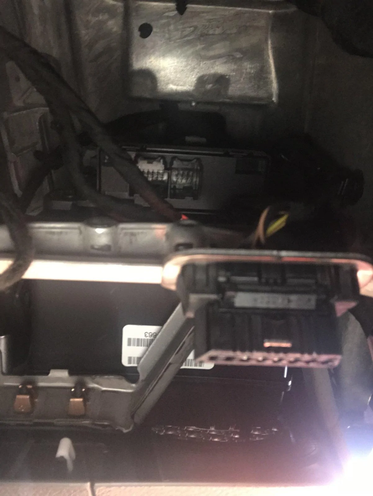

Tabs to release plugs are on the fire wall side of the 2 connectors. I can reach under and pull them off with out looking now, once you know where they are and how easy the unlock tab pushes you should be able to do it blind - putting them back in is a different story.

The panel pops off using your fingers in 5 seconds, and makes it a breeze to unplug these connections.
Sport must be different - I didn’t have to take any panels off. My plugs are in my bypass module but this is a picture looking up from the floor board, very easy to manipulate.

No, Sport, Rubi, Sahara, JL/JLU are all alike.
Sure you can leave the panel attached... you can contort and look up and do the deed. I have done that a few times.
But ....SO, so much easier to get at, to visualize, with that panel off. Panel pulls off it 3-4 seconds and goes back on the same way. Clips are very sturdy so no worry about breaking a clip.
I found that good lighting and panel off are also a great combo especially when you go to plug the 2 wires/connectors back into the Gateway module.
