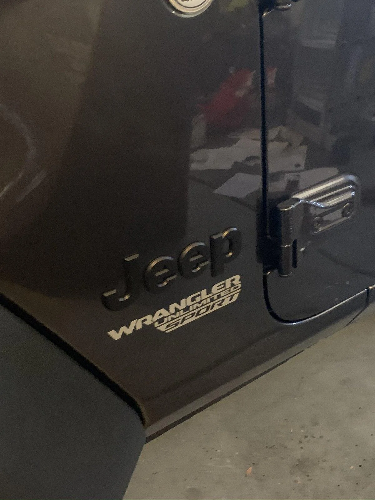

Thats awesome! Here’s a pic of the newly painted logos. It took about 4 coats to get to a point where I was happy with it. Only 1 redo was required when I got impatient and did a 2nd coat too soon after the 1st. Luckily it peels right off so if you do make a mistake it’s not that big of a deal.
So how do you remove the excess Plasti Dip from the fine detailed areas like inside the lettering? Just like a toothpick or something?
Thanks again - sorry for the nubish questions!
No worries! I’m a super noob too so all the info I have was found in YouTube videos or here lol. I used a toothpick and just lightly scratched it until I was able to get underneath the plastidip then I just pulled it out. There were a couple small pieces that stuck so I used some tweezers to pull those out.

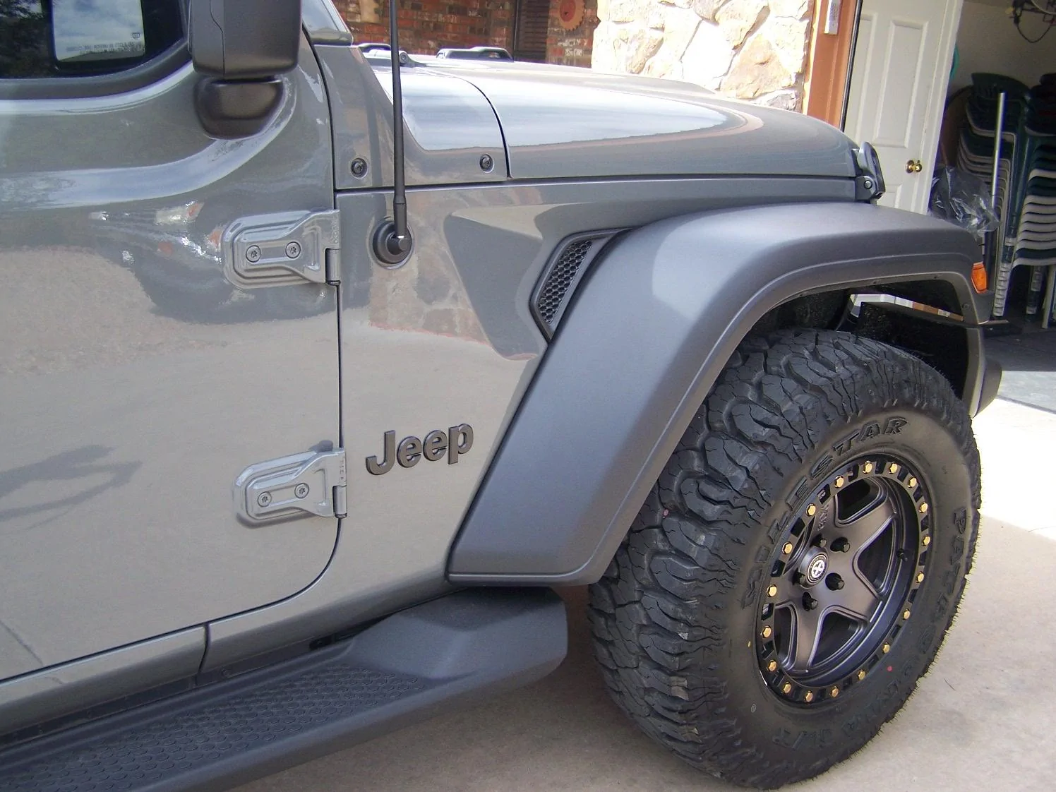

When I did my emblems I used Duplicolor Custom Wrap since it's available in a high gloss. I've used Plastidip on other projects but prefer the gloss finish, it's easier to clean and doesn't have that rubbery texture.
https://www.duplicolor.com/product/custom-wrap-automotive-removable-paint-wet-look/
I wish I had masked off the area around the hinges as it was a PITA to remove the overspray in areas that I couldn't get to w/ a small rag, including the lower front fender area were it meets the body.
