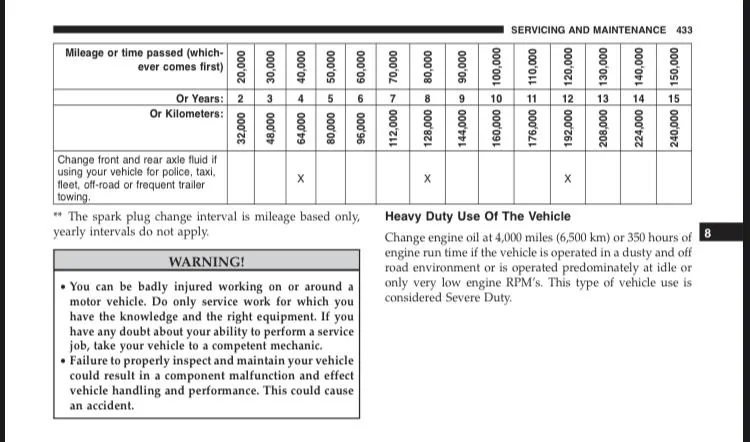

Here’s the maintenance schedule from the manual. Outside of oil changes and tire rotation, they don’t suggest anything before 20,000 miles / 32,000 km, and even then it’s just an air filter replacement and several inspections.
Jeep Wrangler JL First Service question? 78970C77-712D-4087-AD79-E195180EBE4D
Jeep Wrangler JL First Service question? AE888D5A-975B-47D6-9811-2B9D18380B92

Awesome, thanks!

From the manual just before the schedule: NOTE: Under no circumstances should oil change intervals exceed 10,000 miles (16,000 km), 12 months or 350 hours of engine run time, whichever comes first. The 350 hours of engine run or idle time is generally only a concern for fleet customers.
