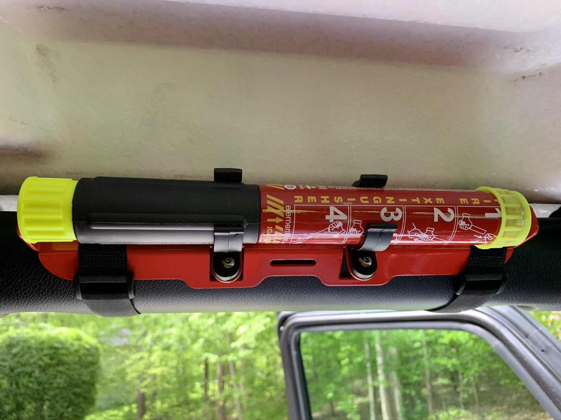

Am I the only person who looks at these rollbar-mounted fire extinguishers and thinks "in a 20g crash, that will become a missile and take my head off"?
Serious question, since I bought a fire extinguisher and rollbar mount, and haven't put it on due to this concern.
