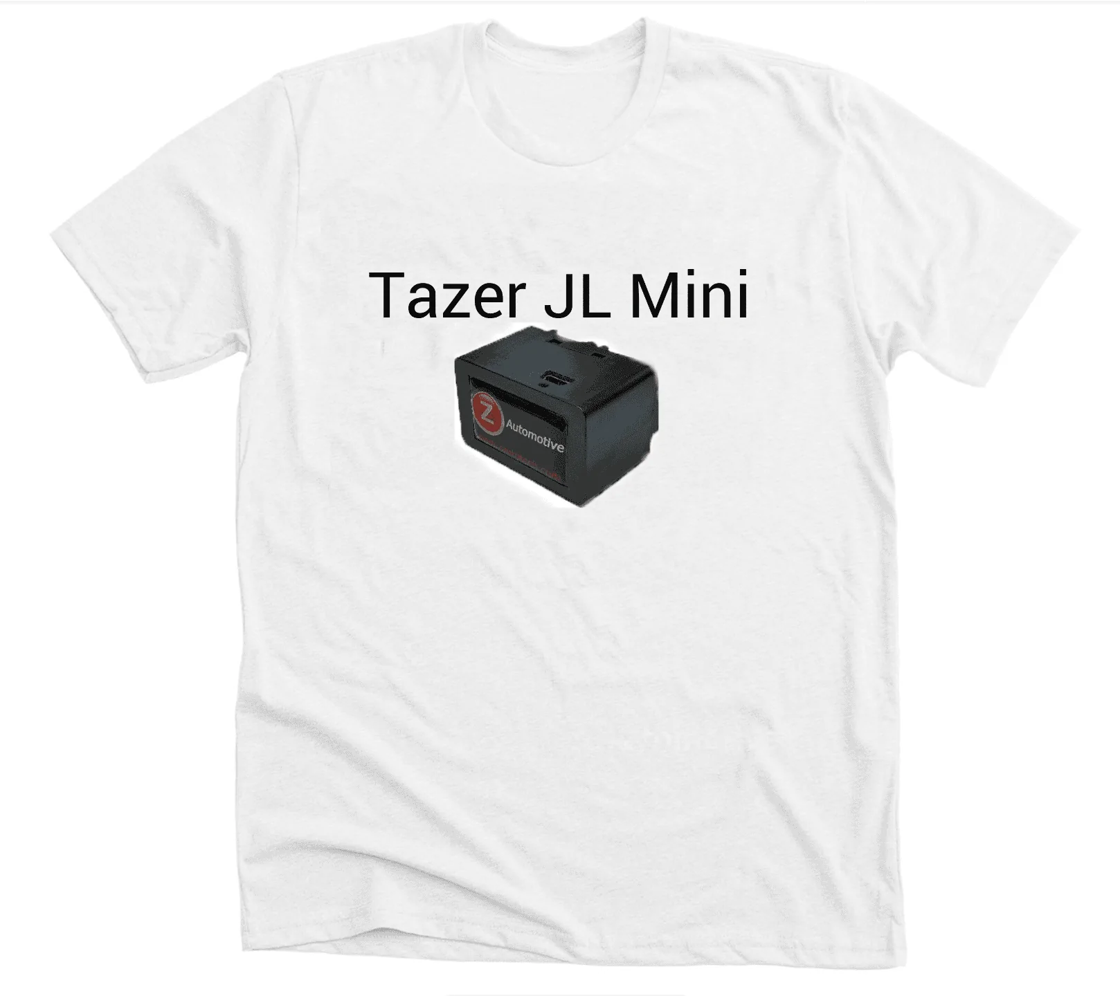

@robd1438
Always unmarry the Tazer JL Mini and remove the Mini before you take the vehicle in for service!
Don't assume ... think... or whatever, that the dealership Tech will not be doing a computer flash on your JL.
When you unmarry, your JL goes back to the way it was just before you married the Tazer JL Mini to it...... With that said, any and all Tazer JL Mini settings/features would no longer come into play after an unmarry... So, for your JL, no front camera, speedo would be off...
BEFORE, you do a firmware update on your Tazer JL Mini you need to unmarry the Tazer JL Mini. After you unmarry, you can then update the firmware and then you would remarry.
Tazer JL Mini
