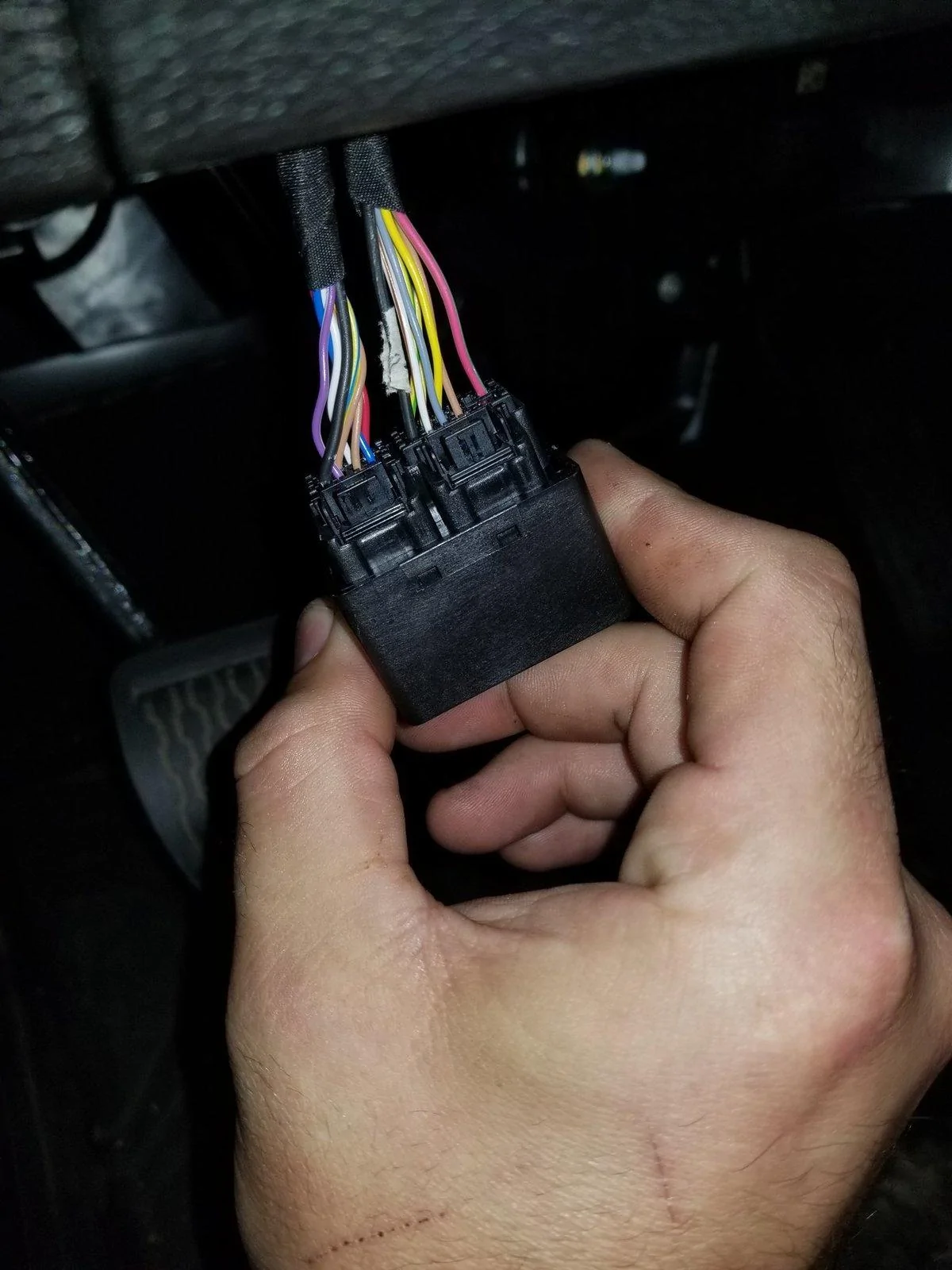

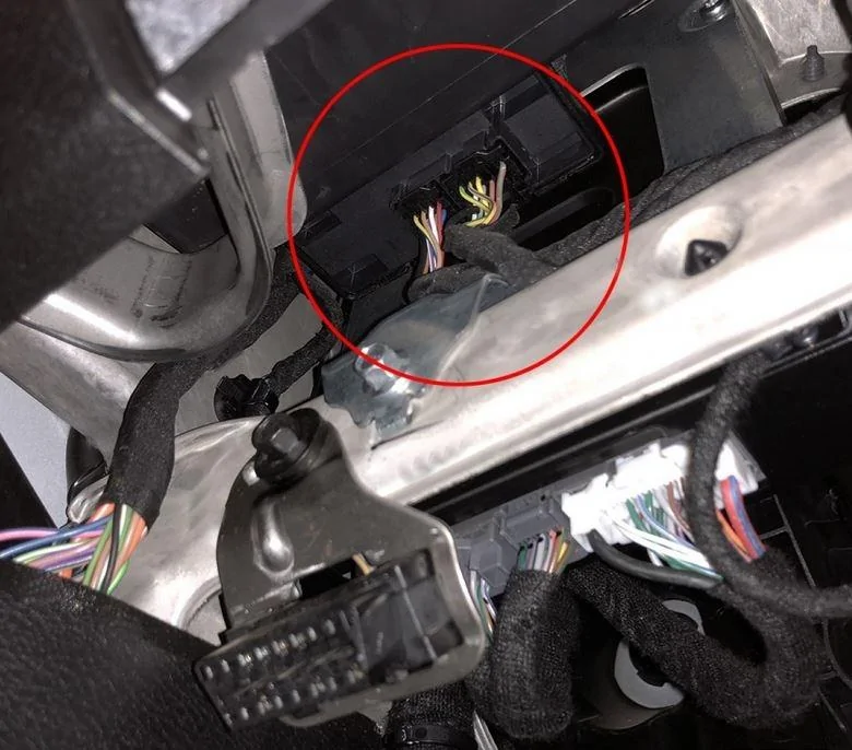

The video below is not in regard to the Tazer JL Mini but it does show how you access the SWG gateway, module, where it is etc.. Watch the video.
Yes, you disconnect both wires from the SWG and those disconnected wires plug into the Tazer JL Mini.

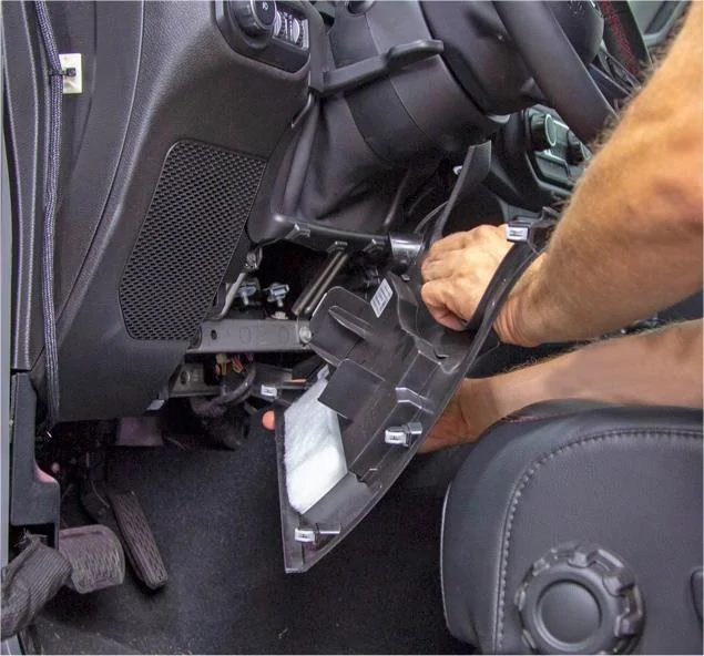

Install hints:
Pull panel below the steering column straight out and off. Careful not to lose any of the 6 white plastic female connectors that can fly off the black panel.

Locate the SWG. Do know that each of the 2 wires that you will be dealing with have a push in release tab so to speak on the connector that you have to push in firmly on, in order to get the connector to release. This release is on the back side if the connector, the side closest to the firewall. BEST BET, is to first push upward / push the cable inward. Now, push firmly on the release and at the same exact time, pull downward on the cable itself. Sometimes a little wiggle of the cable while pulling the cable firmly will help you get it disconnected.

Install hints:

Thanks for all the great detail, photos and recommendations. I am not a fan of those plastic fittings that can easily snap off with the wrong amount of force or wrong direction so your advice is quite meaningful. "straight out" tells me what I need vs straight down. :)
