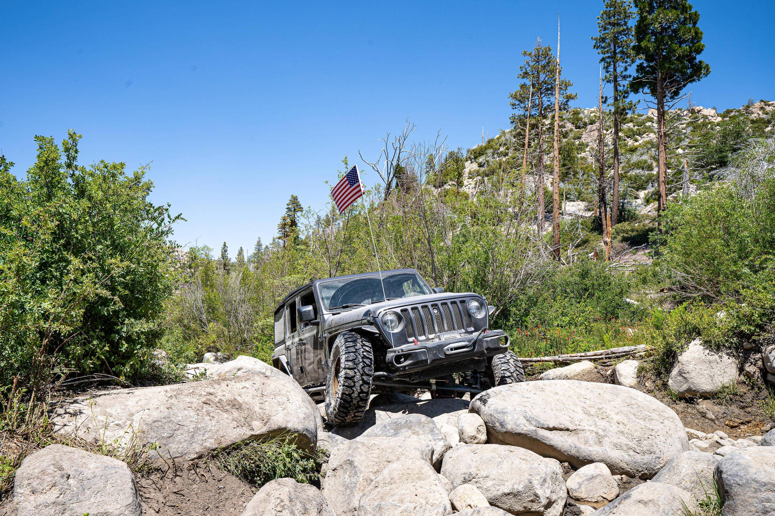

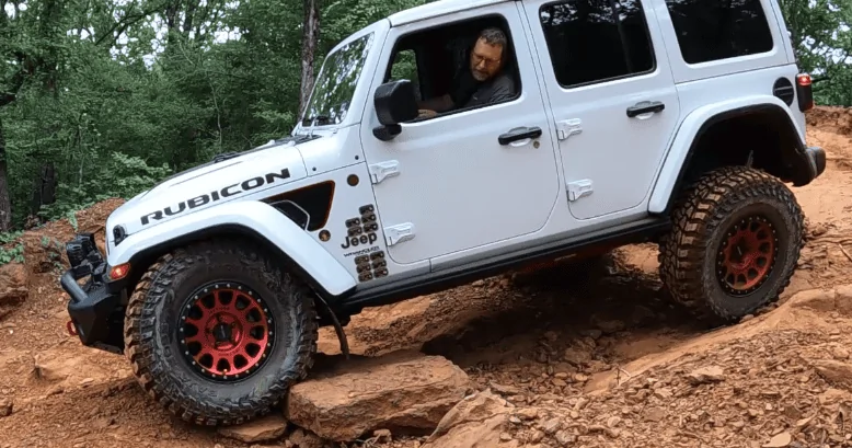

here is a good reference. i started with a base sportS model.. I swapped in rubicon axles ( i wanted front and rear lockers) and did a jks Mfg 2.5" lift. i have method wheels with 4.75" back spacing, 37" x12.5 ' Patagonia Mt-02 and changed the fenders and inner liners and i still get minor rub at full flex. Nothing that stops me from completing hard trails at all. you can see the front stuffs really nicely rear doesnt stuff as nicely as the front but it does kiss the inner fender liner even with them being aftermarket. only thing i dont know about is if the diesel axles come in the short or wide
