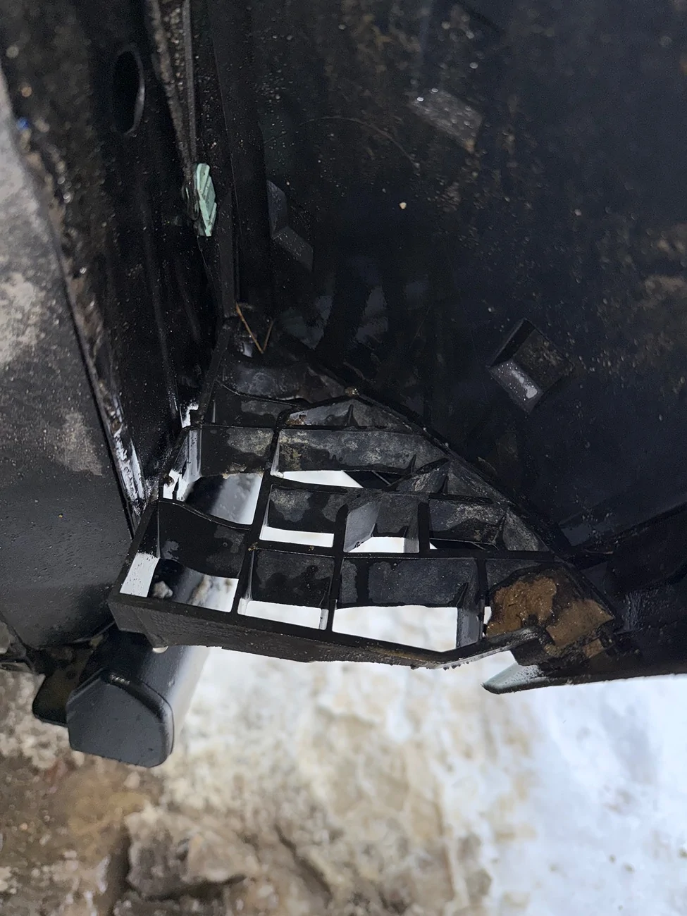

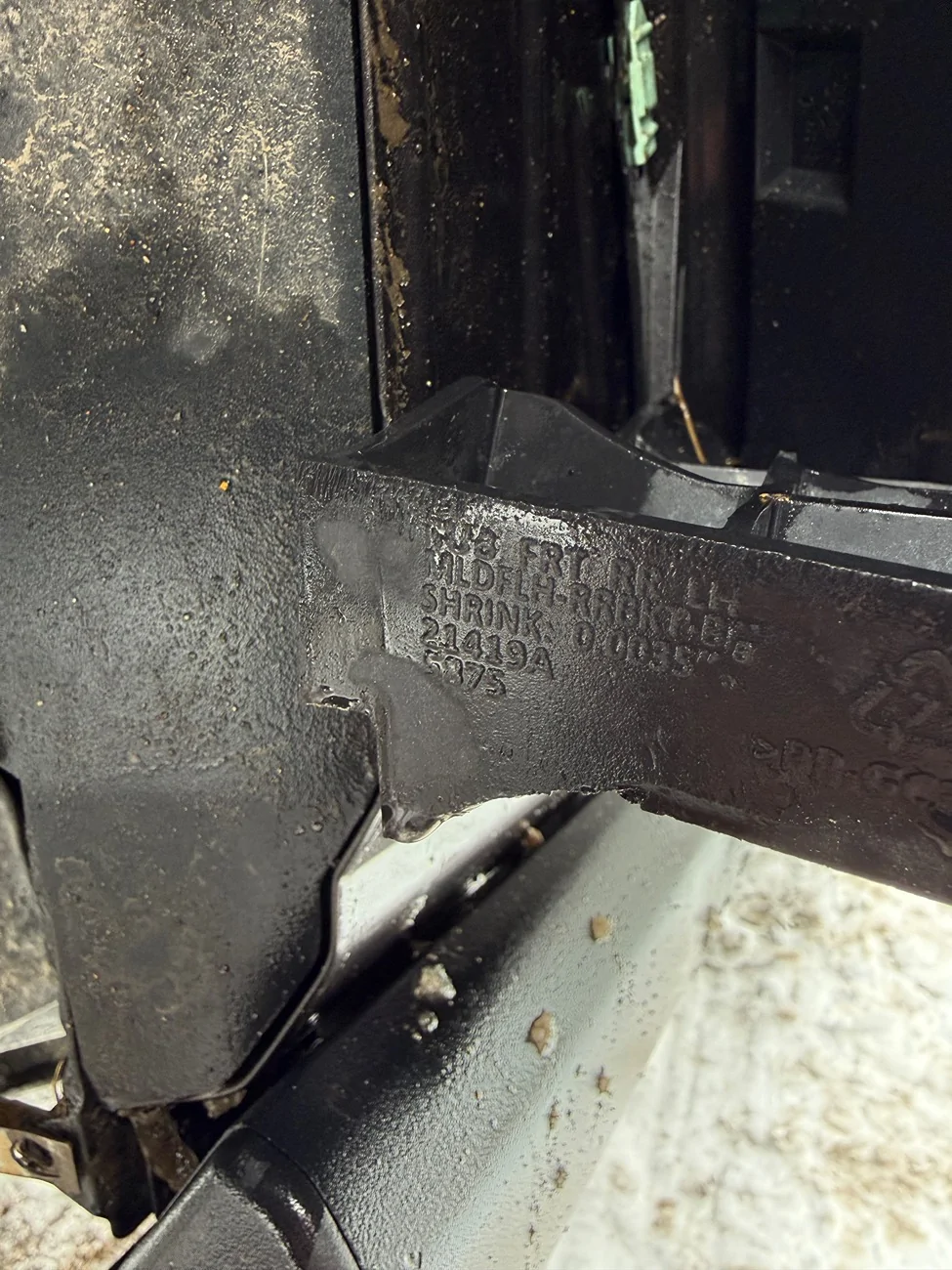

Hey yall, I broke this plastic piece inside my driver side fender flare. Went to the dealer and asked if they knew what it was said it was molded to the fender which it clearly isn’t and that a fender was the only way to find this part. If yall know what is or a part number that would be helpful. Tried getting the numbers and what not in the photo the best I could.

Looks like the fender flares have been split and thats the piece that holds the liners and inner part of the flare together. It is very possible thats not a par that is available on its own from a dealer since its part of a bigger assembly. I just tossed mine when I did the fender split and never thought about it again.

Ah darn yeah that’s what I just read on a similar thread. Unfortunate for me. Hopefully I can find one on marketplace or someone here on the forums

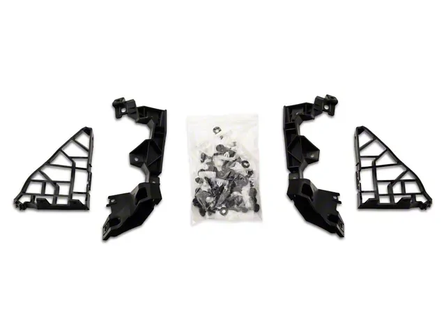

Rubicon or non-Rubicon? MP Concepts makes a Rubicon flare kit, front, rear and both, and that piece is in it. They might be able to get it separately. I had to change them changing the Willys fender for the high fenders.

The reason I was asking, is this is in the MP Concepts kit. Because they aren't riveted to the fenders, but instead go together with expanding fasteners in place of rivets, the parts are separate.

Yeah I was looking at the website and saw that. I sent them an email to see if they will sell the separately. Hopefully they will. I’m surprised no one does that I’ve been able to find.
