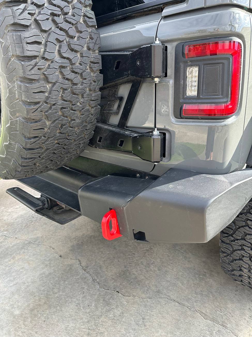

I second the Oracle flush mount. Great look and really bright backup light which I appreciate since I back in inches from the side of the house

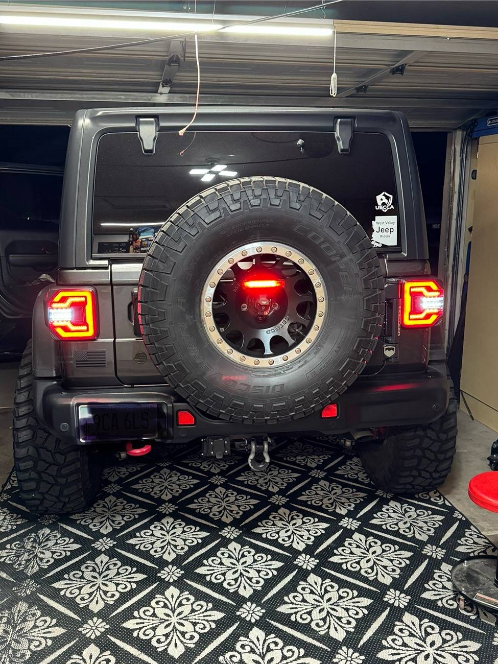

I've had the Oracles since they were released. If you have BSM and want to keep it, I'd go Morimoto. I still prefer the look of the Oracles, though.

Here's another vote for the Oracle flush mount tails, doubly so since you don't have the BSM feature that the Oracles struggle to maintain, anyway. They offer plug-and-play installation, and since you have existing LED tail lights, you needn't faff with the provided resistors as do those folks, like myself, who had halogen lights from the factory.
The illumination provided by the Oracles when in Reverse is arguably nonpareil. As suggested, if you damage those particular lights, you probably have larger concerns to worry about. ;)

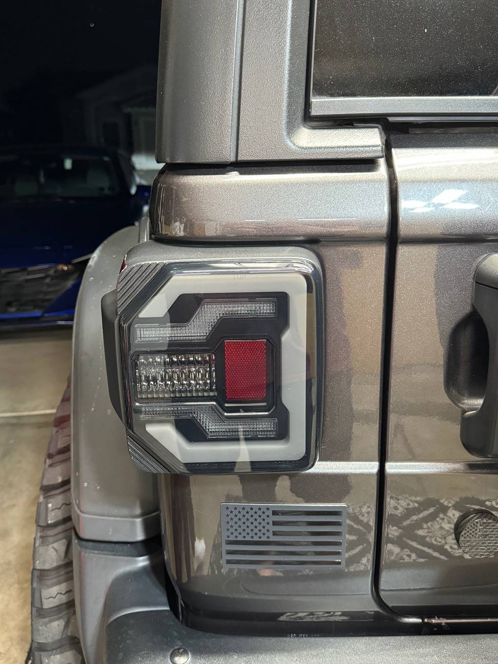

I have these. https://a.co/d/ci8HpiZ
They look nice and are very bright. BSM works but was overly sensitive so I turned it off. I don’t really need it.
