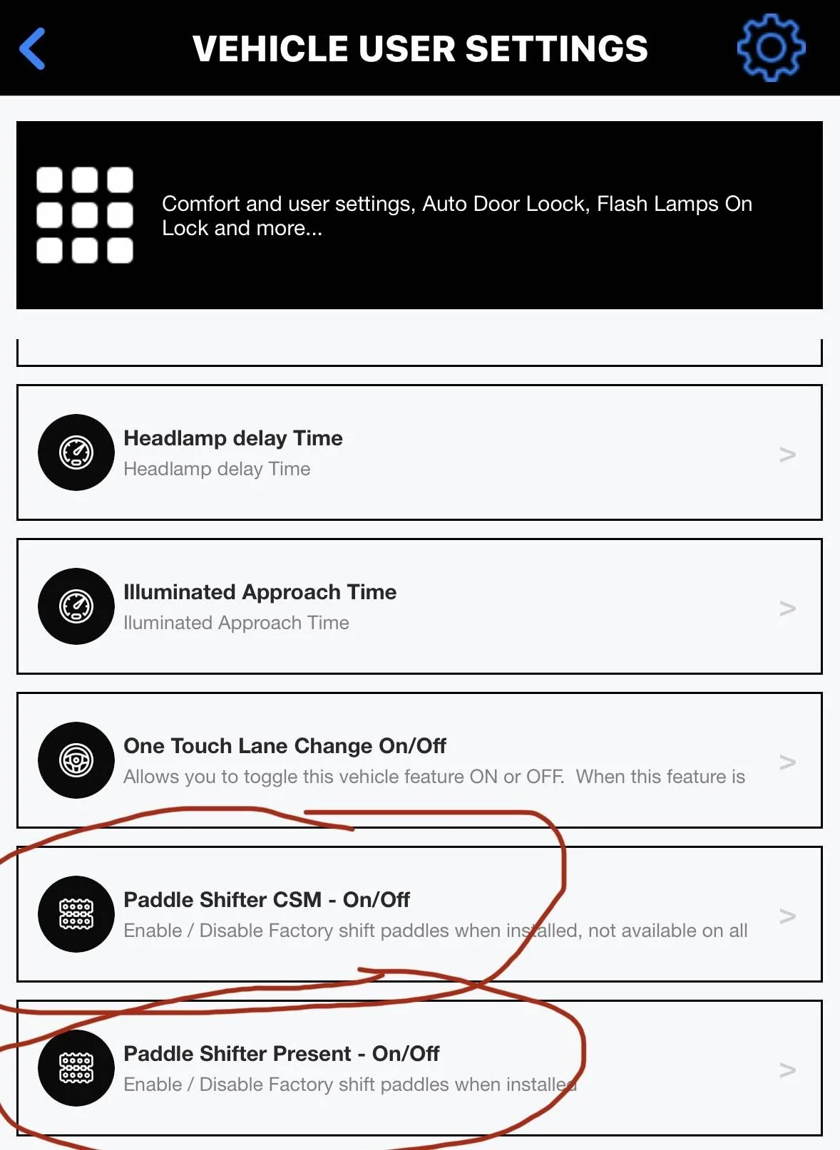

Here are the settings I changed in my JScanner app.
Jeep Wrangler JL Expected Paddle Shifter Behavior? 3012FE37-2188-449F-8F9D-C534834036A7
