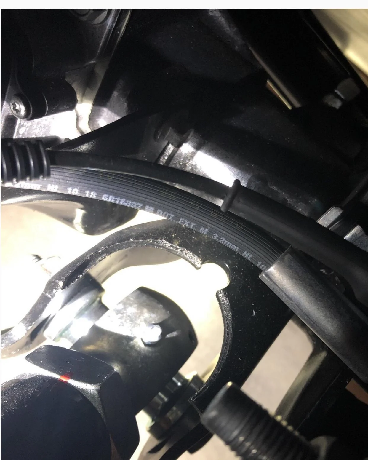

- Have been reading up on the johnny joints, and difficulties reaching the zerk on the lower control arm for greasing. Does any know if the zerk (assuming positioned on top of LCA) is accessible with grease gun on a JL? There's discussion elsewhere RE replacing the standard zerk with a low profile zerk for access on a JK. Wondering if the JL makes it any easier. FWIW, I identified that there's a hole, maybe quarter inch or so, on the LCA axle mount above where the zerk nipple should be. But the angles and height...I can't really figure for that, not sure if it'd be accessible or not.
