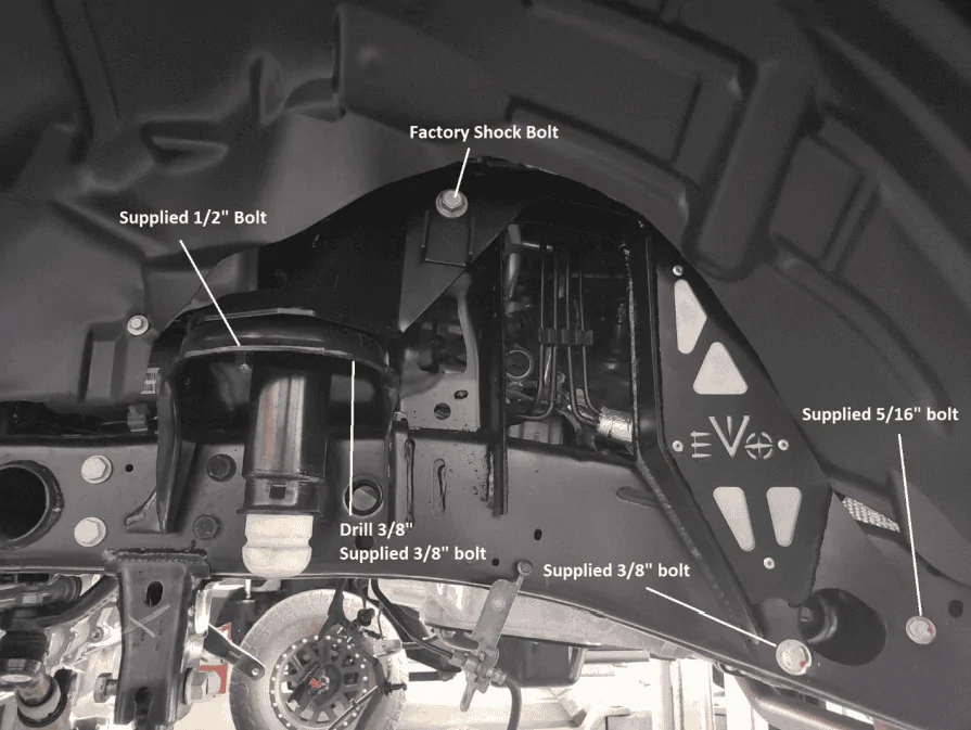

I'm prepping for installing the Evo Coilover kit and had a few questions that don't seem well covered in the pdf instructions.
  • The instructions say to trim the inner fender liner. To what extent does this need to be done, and what tool is best for the job?
  • The instructions say to drill a hole from the underside of the frame coil mount. What is the best way to mark this hole for cutting? (this is the Drill 3/8" in the photo)
  • Wondering if I would be well served to get a die grinder for doing the majority of the cutoff work? I have an angle grinder and sawzall, but it looks as if cutting with an angle grinder may prove difficult in the tight space.
Jeep Wrangler JL Evo Coilover Installation ?temp_hash=e2ce7810a5a28249b9e1cb0a489fa071
The questions around cutting have been partially addressed in the evo coilover kit thread, but I would be happy to hear from anyone who has done this and what tools they found best.

A box cutter with a new razor blade works well on the liners, even good scissors will do the trick. I've only installed the kit with alloy liners, but you do have to cut a fair amount.
I havent found a perfect way to drill from the bottom up, but I usually get it very close by taking measurements and starting with a smaller bit. I will then open the hole with a die grinder to match the hole in the bracket.
I found that a angle grinder with cut off wheel worked the best for cutting the factory shock towers. I tried to use a sawzall where I could, but with all the electronics/wiring etc behind the towers it proved difficult. Once I got into a groove with the angle grinder it was fairly easy/quick.
Hope that helps a bit, just what I learned from my experiences :beer:
