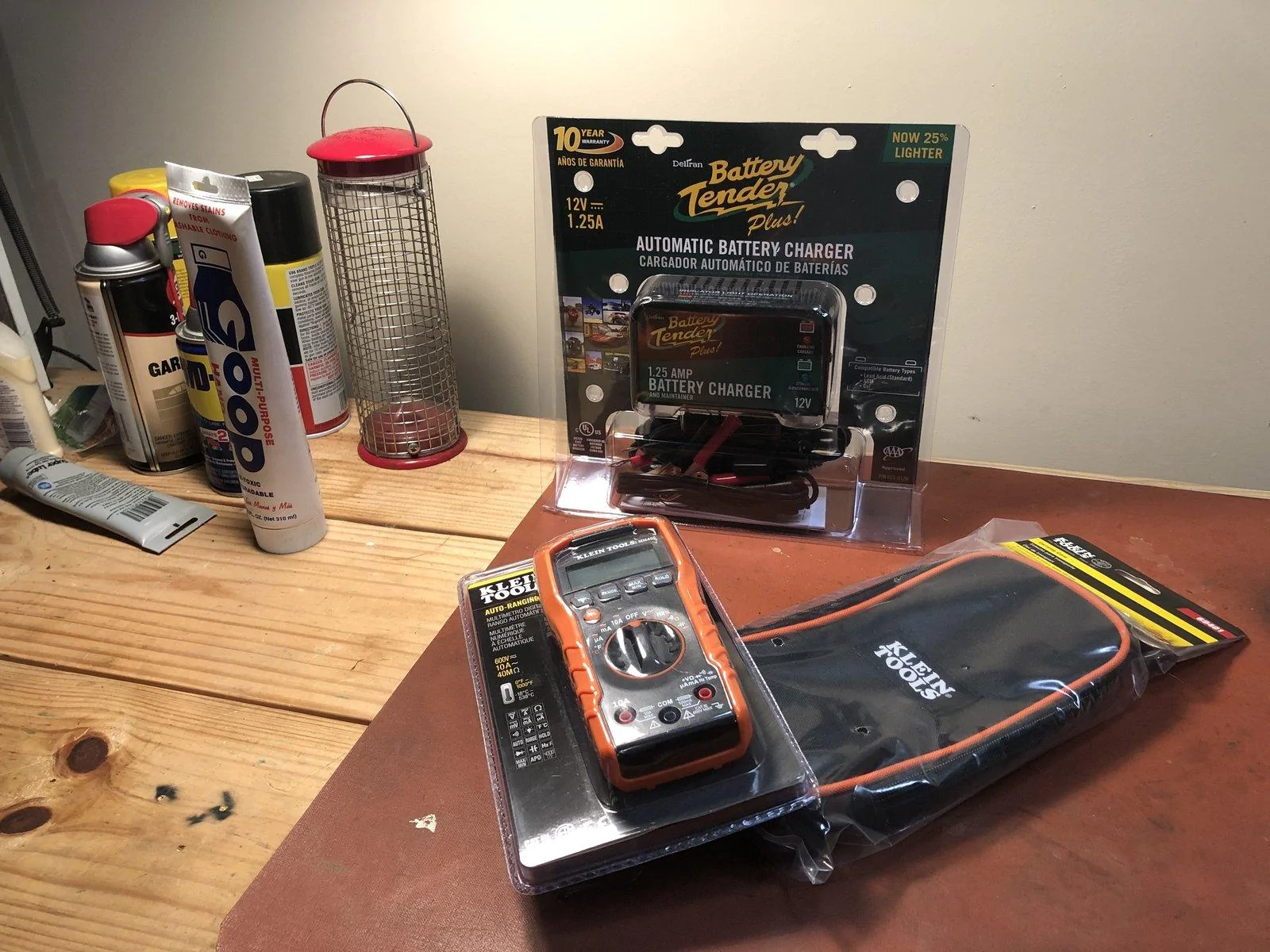

@RussJeep1 I would get a digital meter and measure voltage at the battery, I check voltage at the main and then I keep the negative lead on the main and put the positive on the N1 and N2 posts under the fuse box cover and all three should be pretty close to one another
