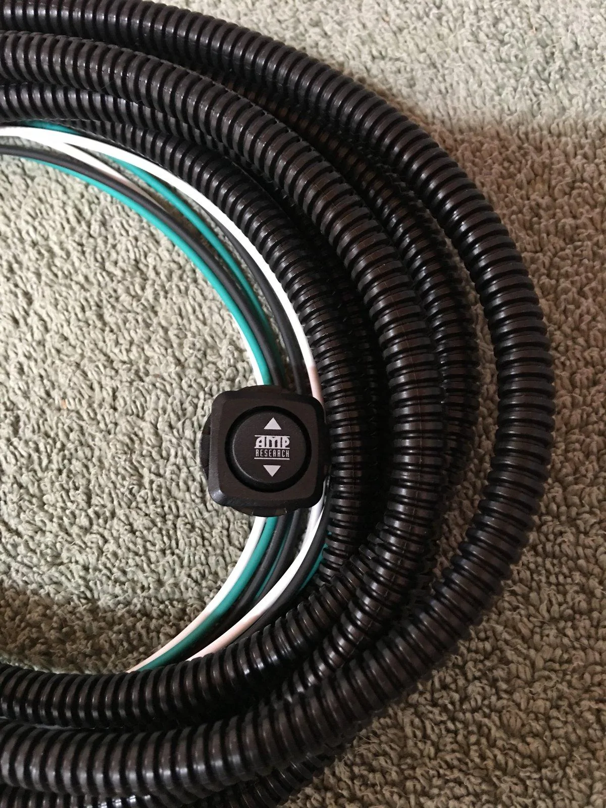

I need to run some wire from the AMP Research controller in the engine compartment to the AMP override switch on the drivers side of the Jeep. Where is the easiest place to bring wires through without taking a lot of things apart? Total of three wires with shielding that are about 3/8 of an inch in diameter.

For you with an automatic, the best place for you to go through, would be on the driver's side fire wall.
Look right where the clutch pedal would have come through the firewall, if your JL was a manual.
You will find a plastic covering over that hole and it is easy removed per forum member reports. Watch when you pop the cover out, as you can lose track of that plastic cover.

As always, thank you so much! As soon as it warms up a little I’ll get it done.
