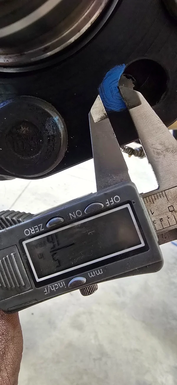

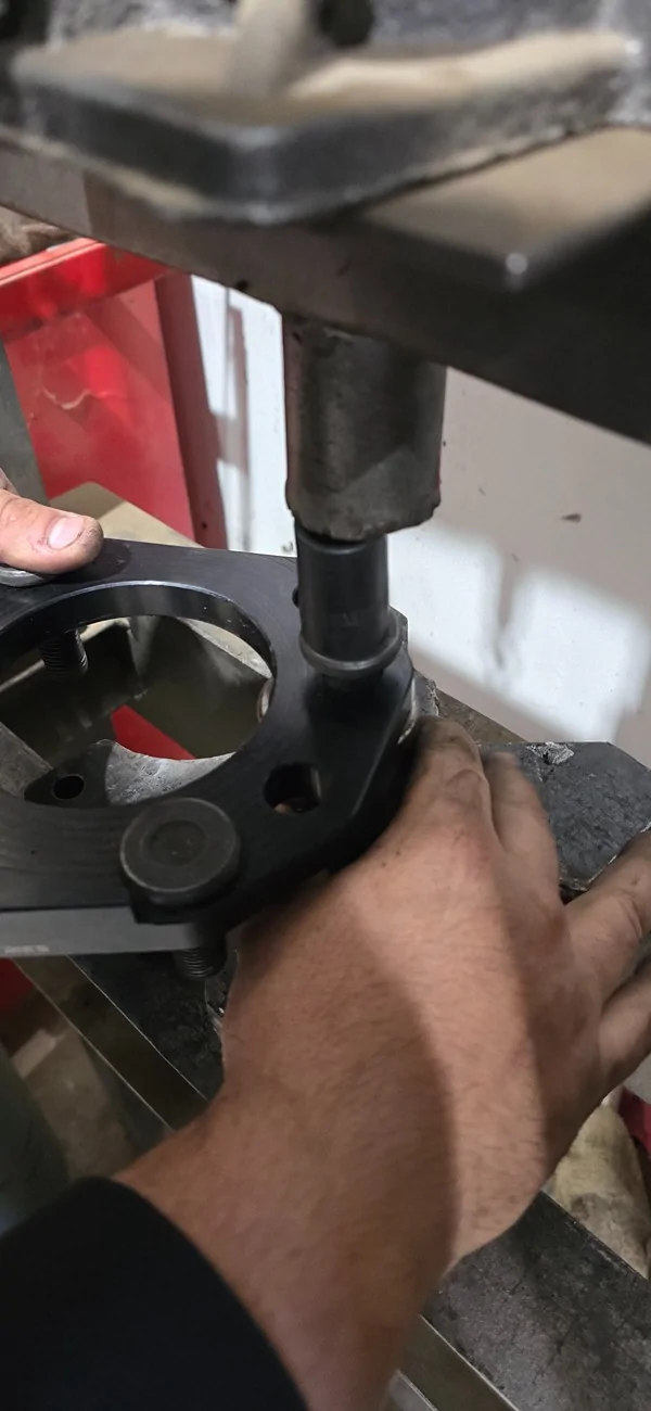

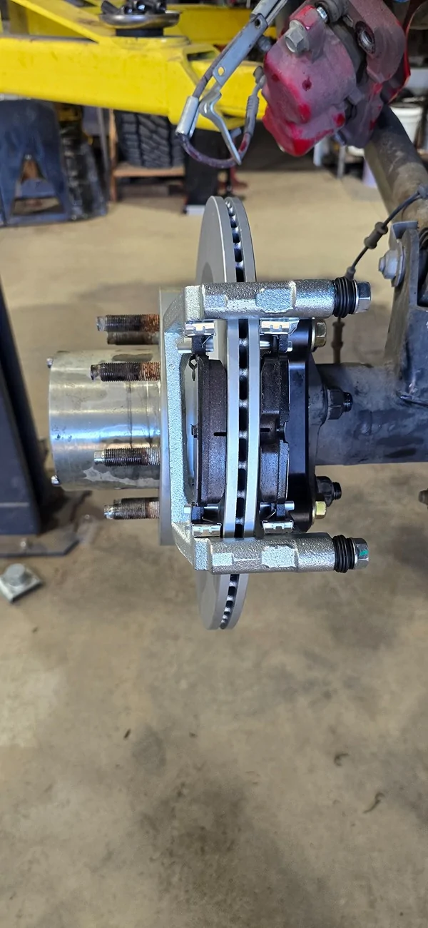

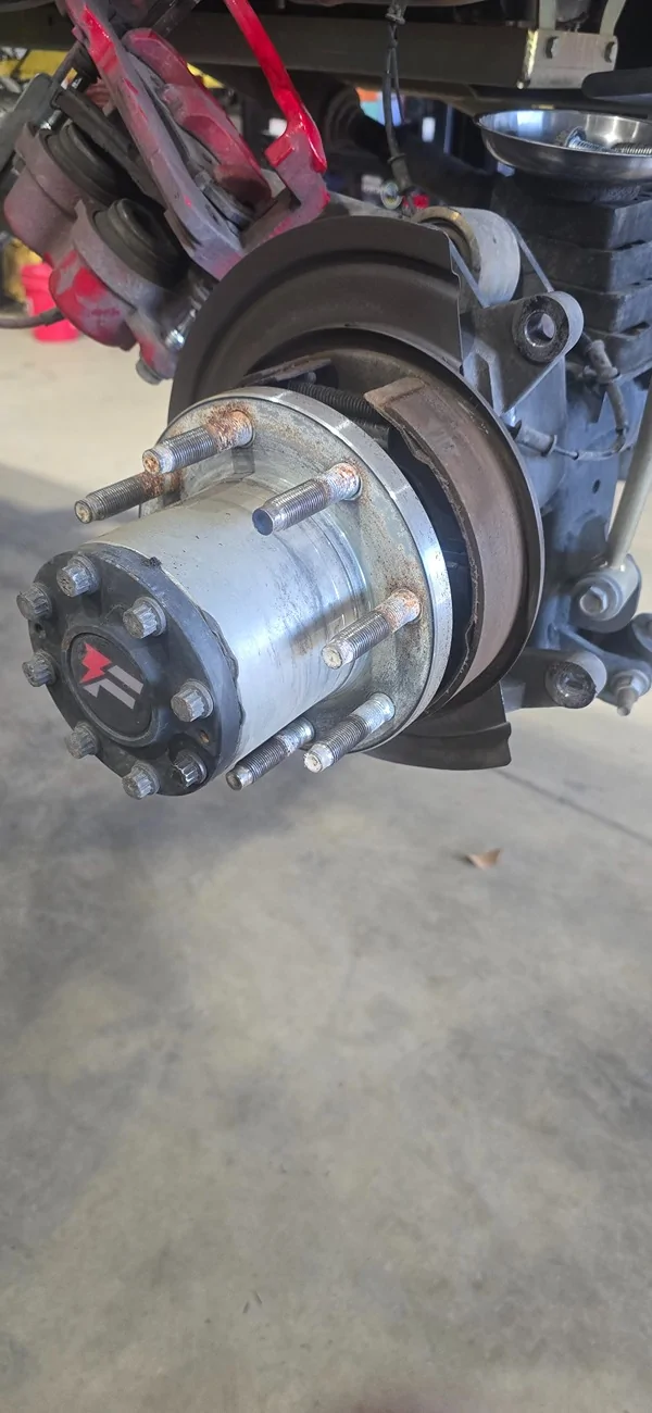

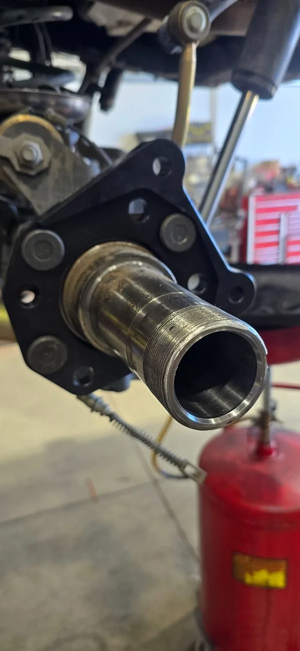

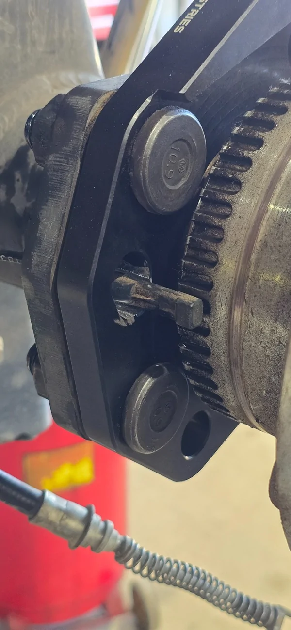

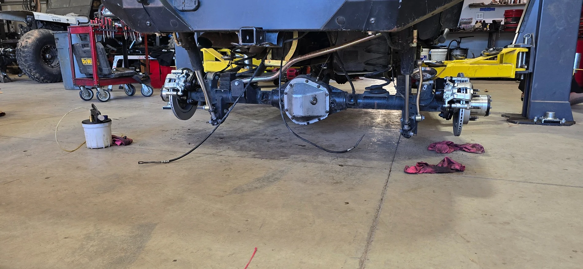

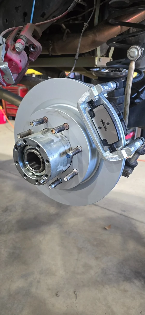

OK, This has been a topic for a while on the Fusion 4x4 / ECGS 40 spline axle setups. Bottom line is the handle doesn't have enough throw to fully pull the cables tight.

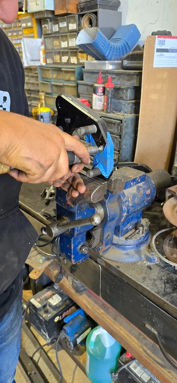

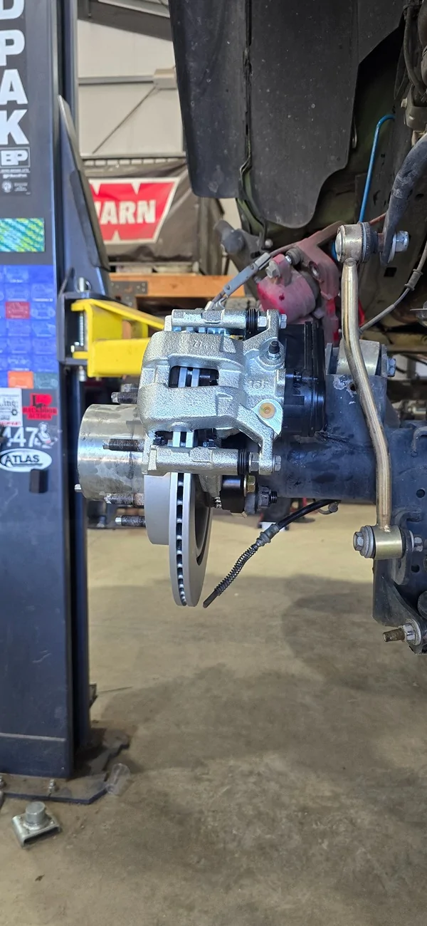

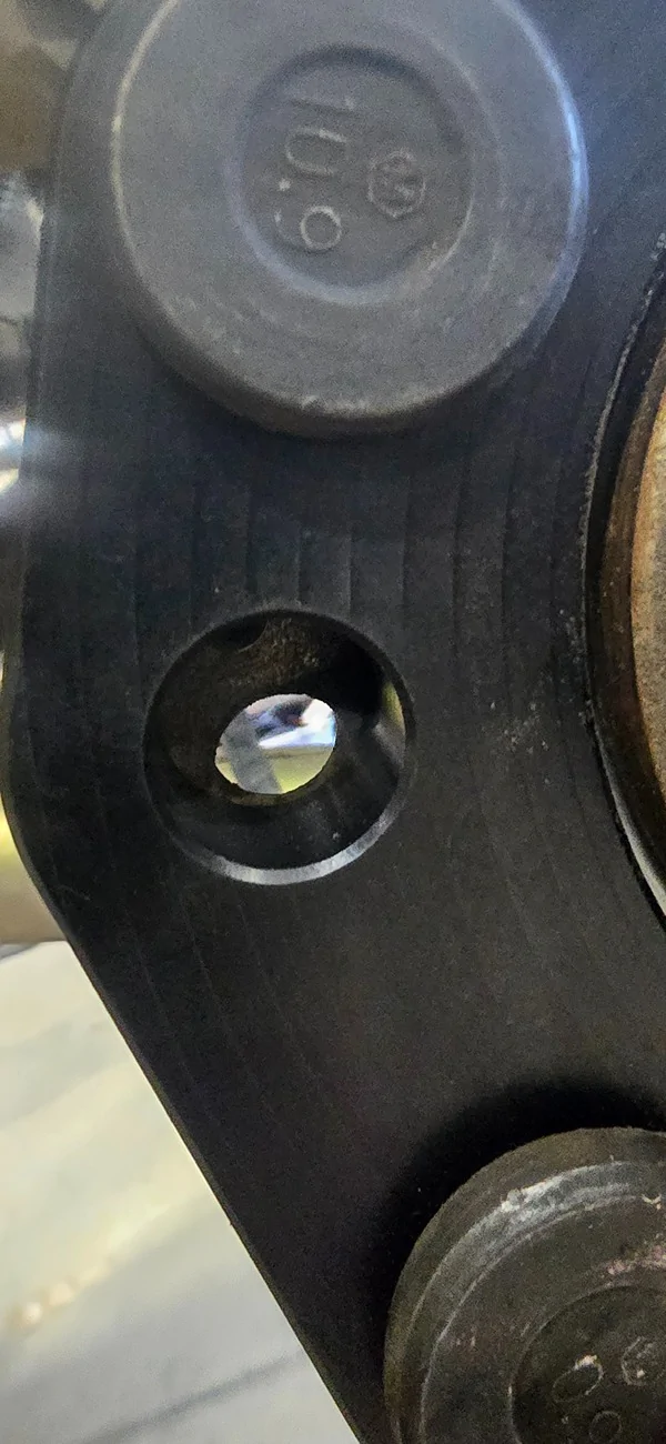

I just did the range industries E brake kit on my 40 spine axle. Ours use the 08/09 14 bolt breaks and the kit is set up for the 99/07. It only took a couple small tweaks to get it to work and now I can't drive through the brakes trying to.

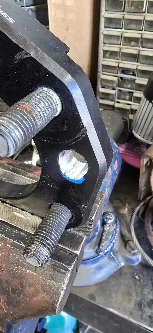

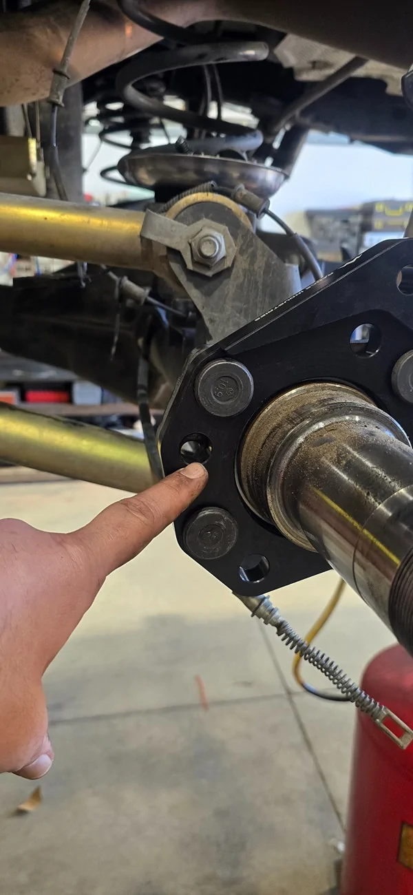

Had to open one of the holes on each mount for the ABS sensor.

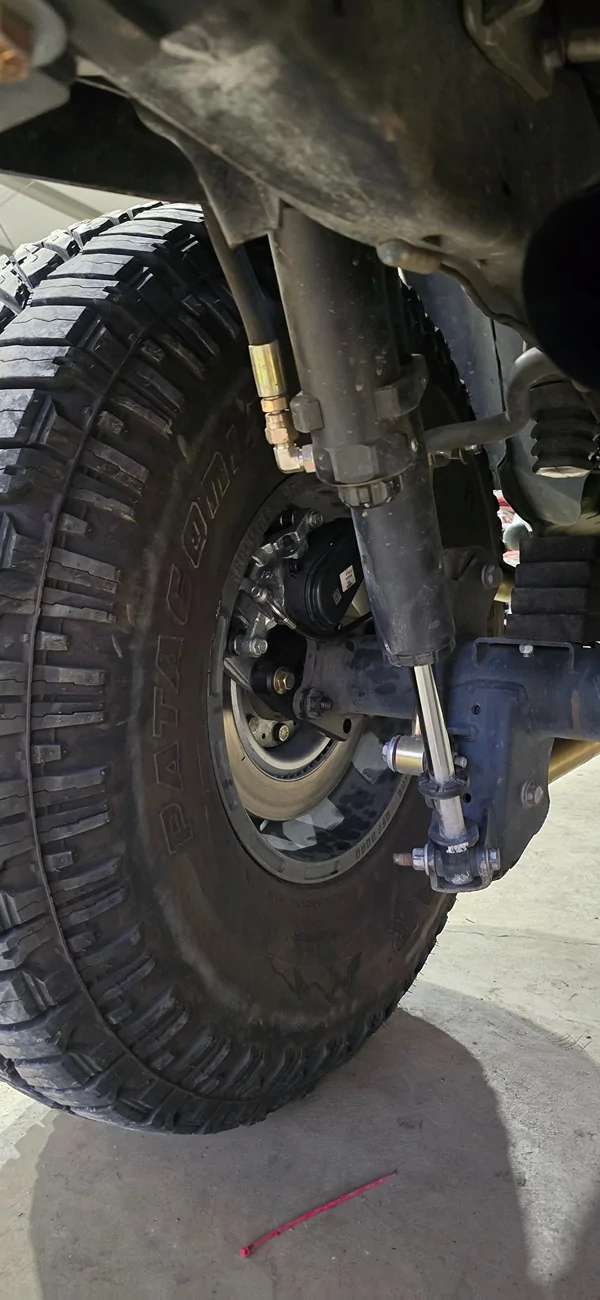

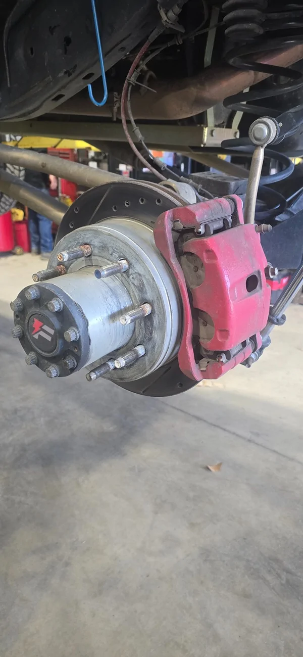

I will say that depending on your wheels it may not clear. I had to smooth the calipers to get my Racelines back on.
Parts list I used on my JL.
- Range offroad kit - https://range-industries.com/produc...-brake-epb-kit-99-07-gm-14-bolt-aam-10-5-11-5
-Grimm offroad brake line - They didn't fit right and had to modify. I recommend finding lines with normal banjo fittings and not angled ones.

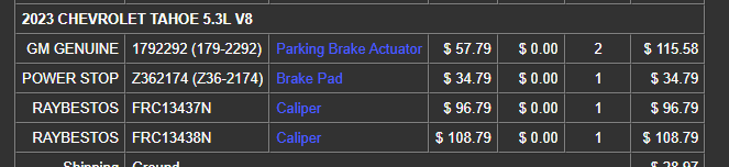

-2023 Tahoe rear calipers with actuators and pads. - Sourced from good ol' Rock auto.

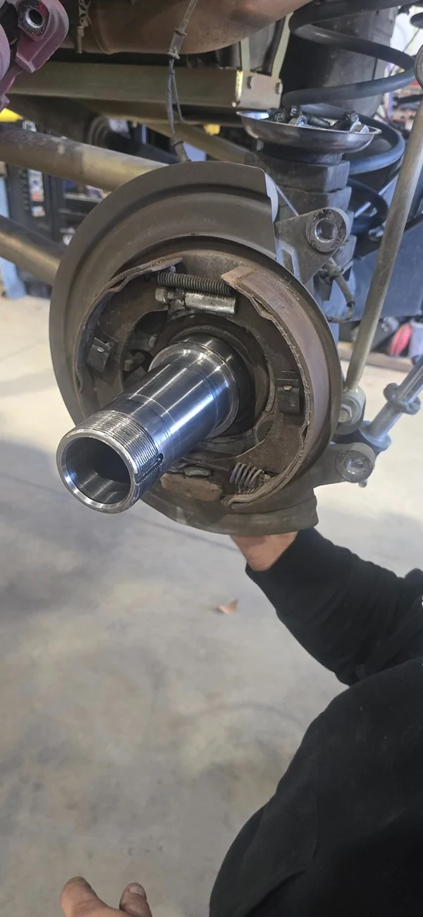

I installed the Ultimate Dana 44 front and Ultimate Dana 60 semi floating rear axles. Parking brake is almost useless so was looking into this change.

Yes, stock JL brakes fit the 60 semi floating axle although I have Power Stop heavy duty drilled disks and pads. If I do the electronic brakes I have to change disks and pads again.

This is the install on my buddies that helped me do the install on mines jeep.Good notes for those of you running 14 bollt junk yardswaps.
