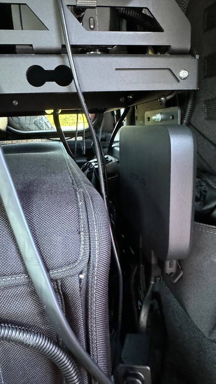

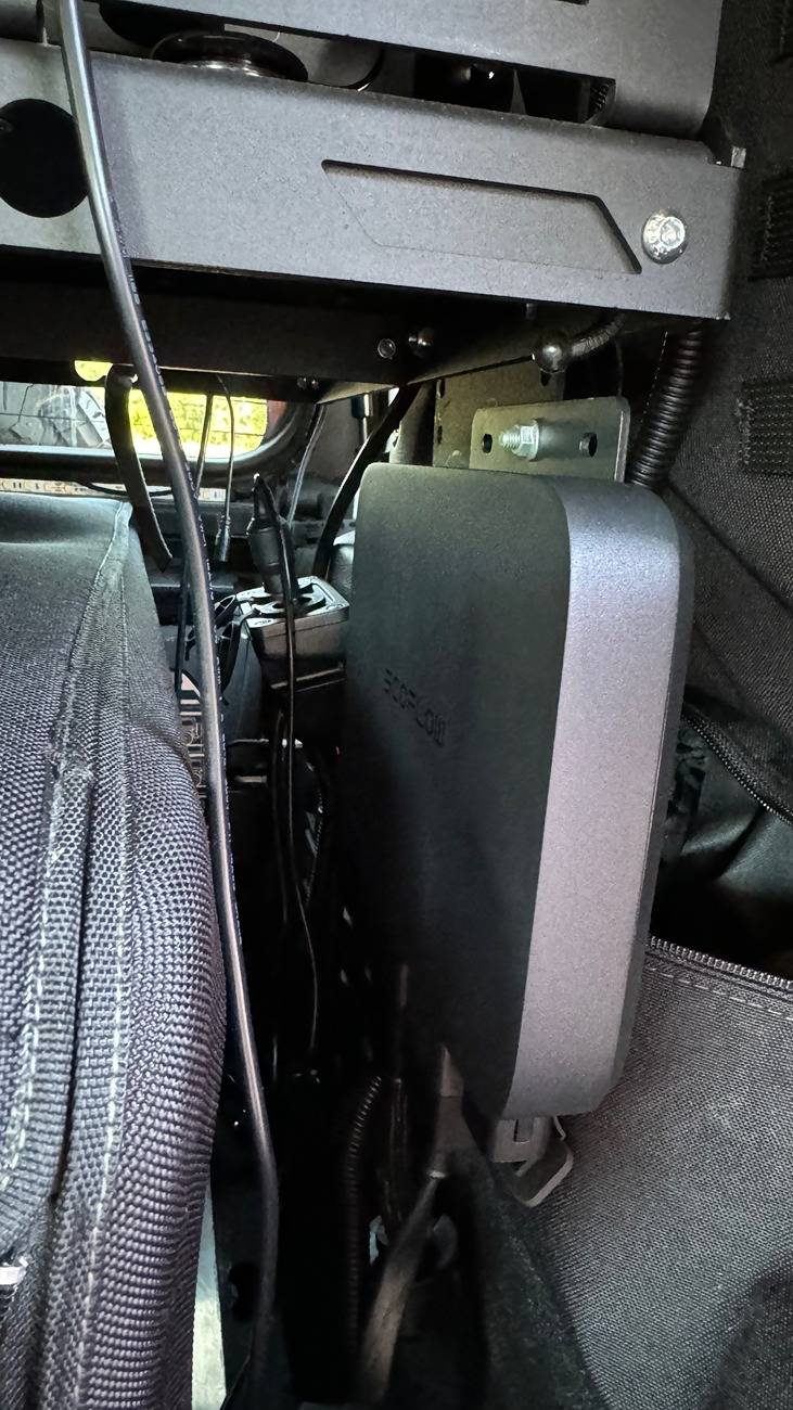

I just got mine. Where did you mount yours?
I have an American Adventure Labs cargo shelf. I mounted mine to the part that attaches the shelf to the to the roll bar. Under the shelf, that piece has some holes in it and I used the bracket to secure it to that part. It’s hard to explain but it works perfectly.

I have the same American Adventure Shelf - could could you please share a photo on how you mounted it? Would also love to know how you ran the cable to the battery?

I have it attached with one bolt, and it is really secure. When I get some time, I'm going to drill a hole and secure it with two. It fits perfectly, is out of the way, and provides great access.
This solution is temporary. I ran it along the door jamb. I need a better and more permanent solution. Since there are already cables there, I don't have much room to work with. I need to make it longer, remove the trim, and make it a long-term fix. I wanted to ensure that the location is correct before I implement a permanent solution."

Looks good like that. I’m trying to get it on the other side of the bracket but these cables are so big/thick and also have the bulky thing by the plug in.
I like what you came up with, I’ll share what I’m doing with mine as soon as I finalize it.
Appreciate the photo!

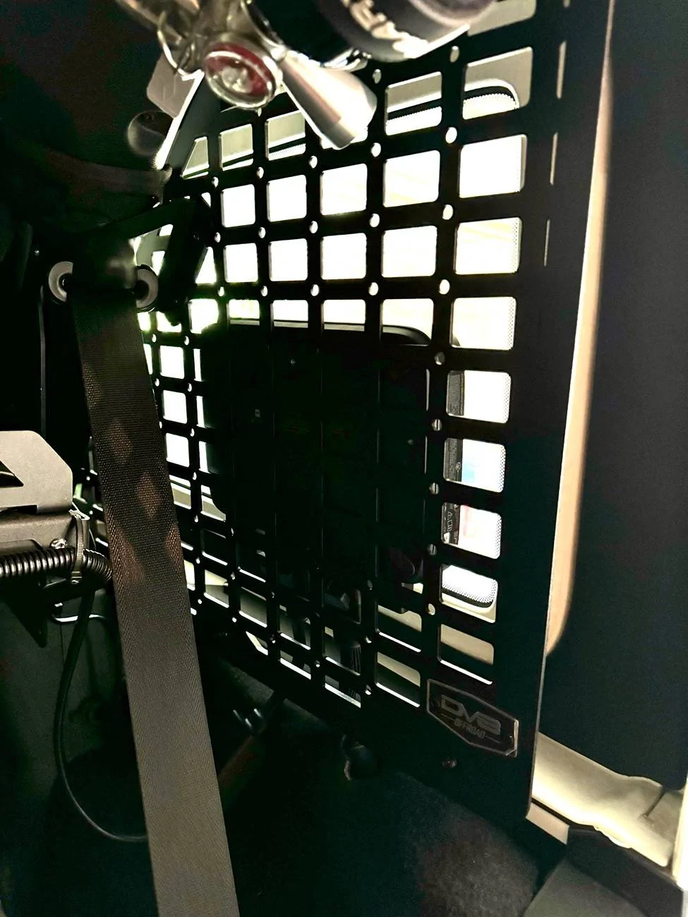

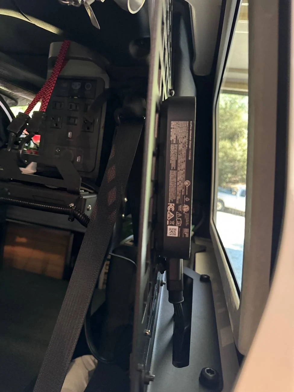

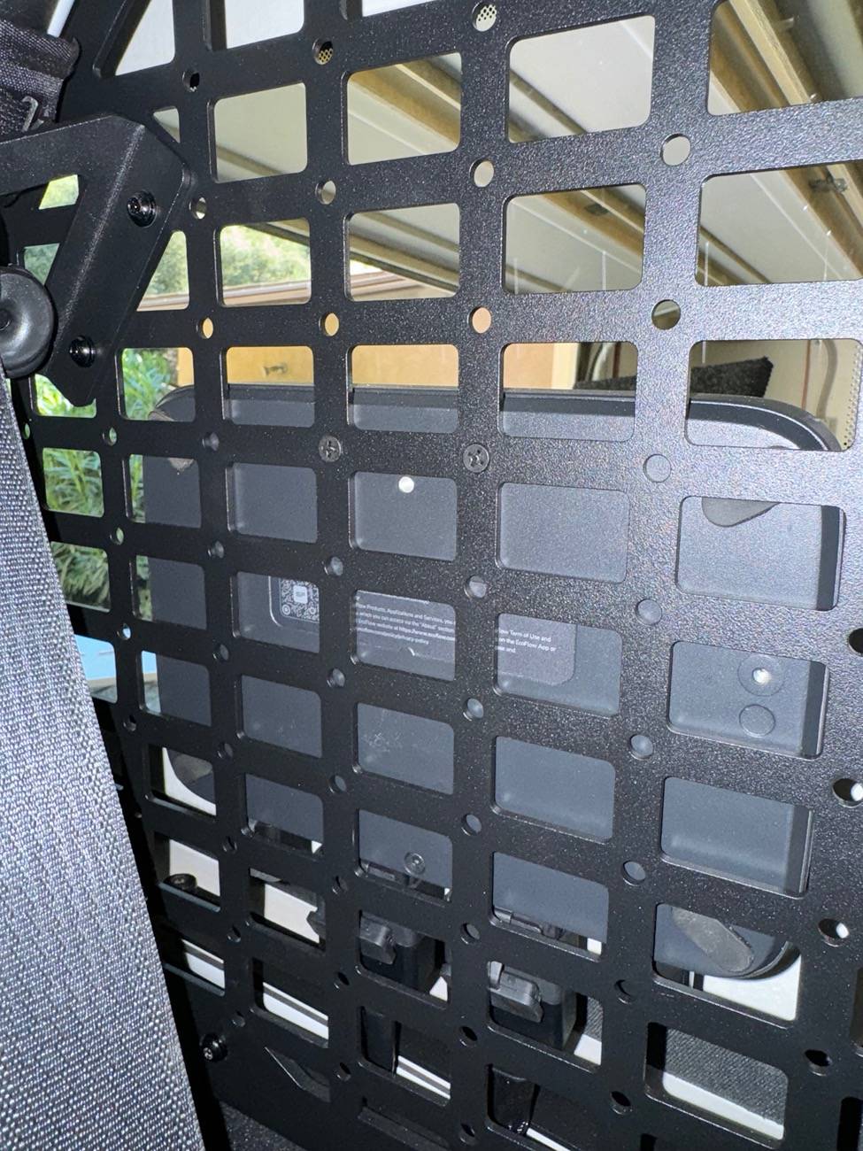

Hi,
quick update in case someone else is looking for install of the alternator charger.
I found DV8 rear window Molle panel (quite expensive but perfect for this install and other items) the holes line up perfectly for the charger to be mounted and part of the mount have a slot for the cables.
See photos attached, this will be my permanent solution as it fits perfectly wi the length of the cables all the way to the battery.
I installed it in the driver side. Also have American Adventure Lab rear cargo.
hope that helps!
feel free to ask any questions.
