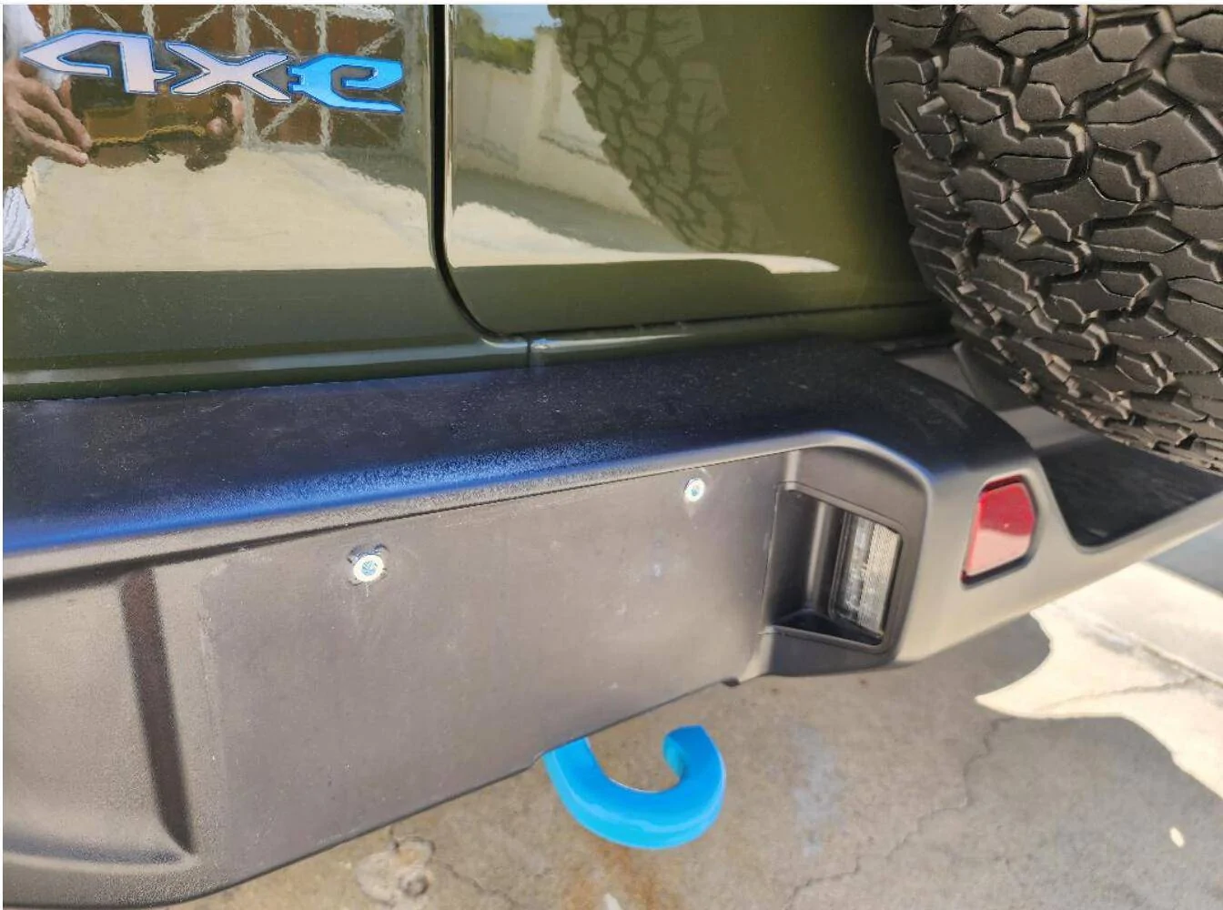

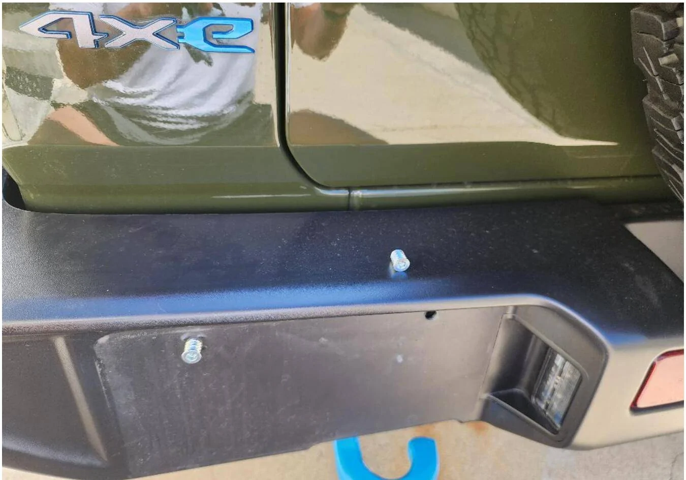

Just got a 2023 Rubicon 4xe a month ago. I noticed the bolts holding the Lic plate in the rear bumper (⅛in plastic) don't really hold since the plastic easily strips and the bolts just spin. I saw a lot of relocation options but I rather keep the license plate in it's intended location. I used 2 ¼in wood threaded inserts and epoxy them in place. Worked out perfect.

Nicely done! And a good decision to use the intended space.

Where did you get threaded wood inserts? Awesome solution.

You can get the wood inserts @ ACE hardware, they tend to have all the odd hardware, Home Depot even Amazon
