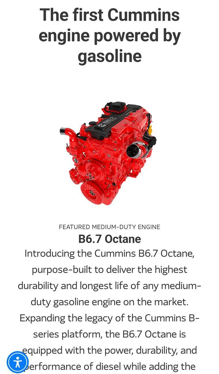

I know Cummins is coming out with a octane engine soon. I believe they're trying to make it as much like a diesel as they can, without all of the emissions nonsense. Basically the ease of running a gasser engine, with the power output of a diesel engine... Let me see if I can't find that link
Heads up this link brings you to a PDF...
Cummins B6.7 Octane
