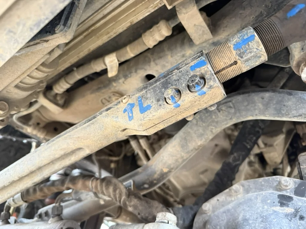

Hope you can see the pic. I modified a lot of things back in 2022, mostly with tereflex parts. Unfortunately, I don’t remember if this is tereflex or not. I can’t find markings on it.

Isn’t that just a 12 point bolt head? The E torx have six points.

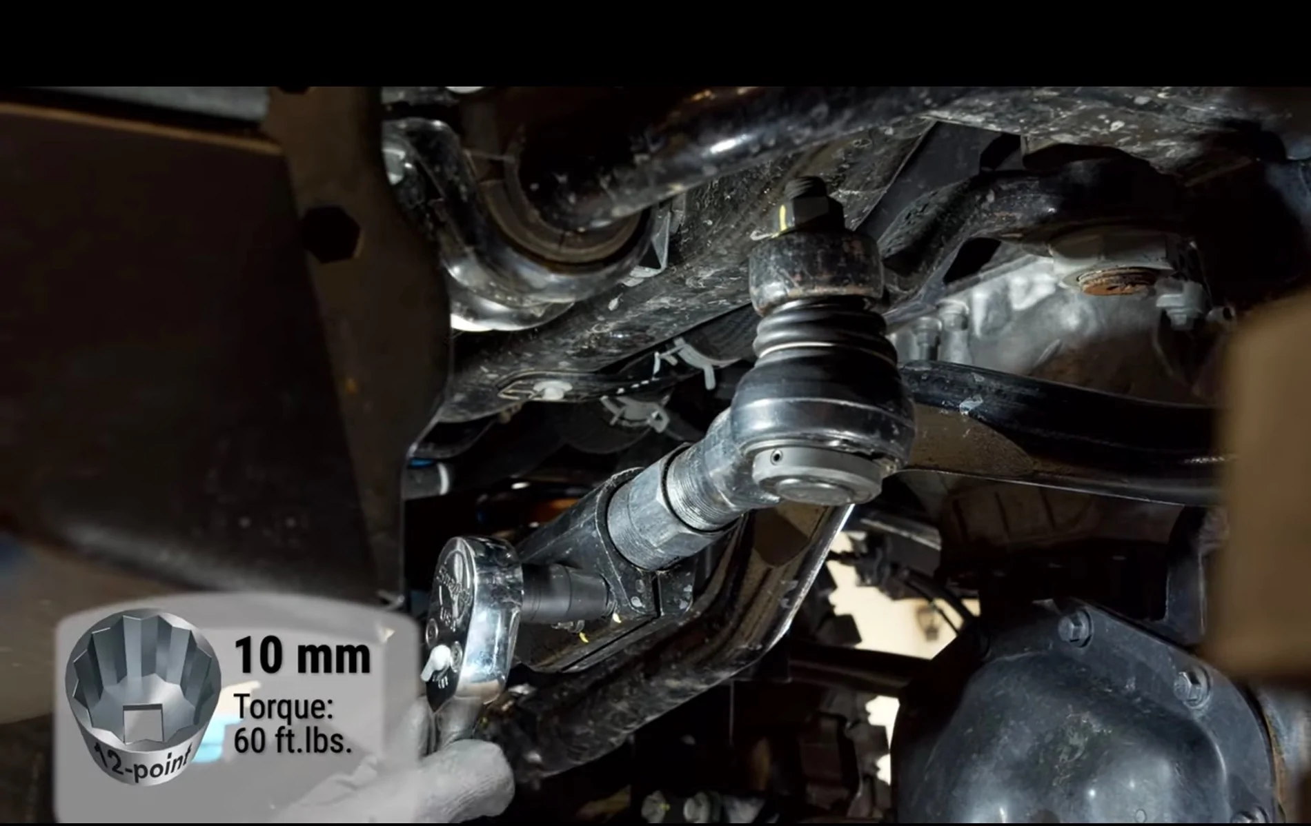

If there’s not room for a standard 12 point socket for some reason, I think I would swap out the hardware for some that uses a regular internal torx bit or Allen bit. They don’t take much torque.
Try a 12 point 10mm socket first.

FYI - a few years after installing their trackbar I wanted to adjust the length. After making the change I went to retorque the collar bolts and ended up twisting one in half and stretching the other before I could get to 60 ft-lbs.
I think what happens with their clamp over time is the two sides of the clamp collar stretch and end up touching each other, like it appears yours are doing in the picture. When you try to retighten them you go from well under 60 to way over when the two sides come back together.
This is also where I learned that I shouldn’t do non-essential maintenance when you only have one vehicle. I did it on a Saturday and couldn’t drive anywhere to even look for bolts. Fastest way to get back on the road was just order another Teraflex trackbar from Amazon.
