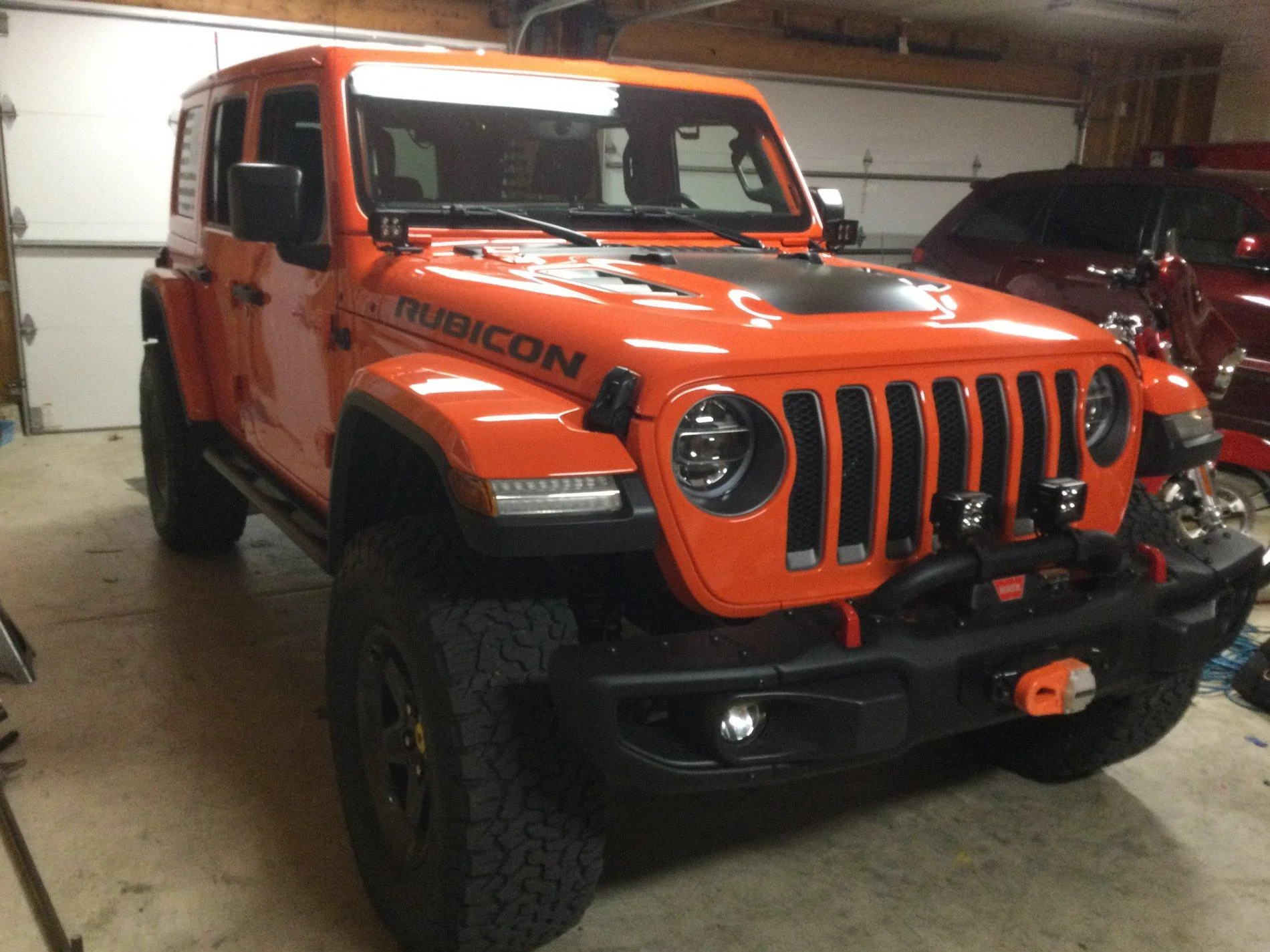

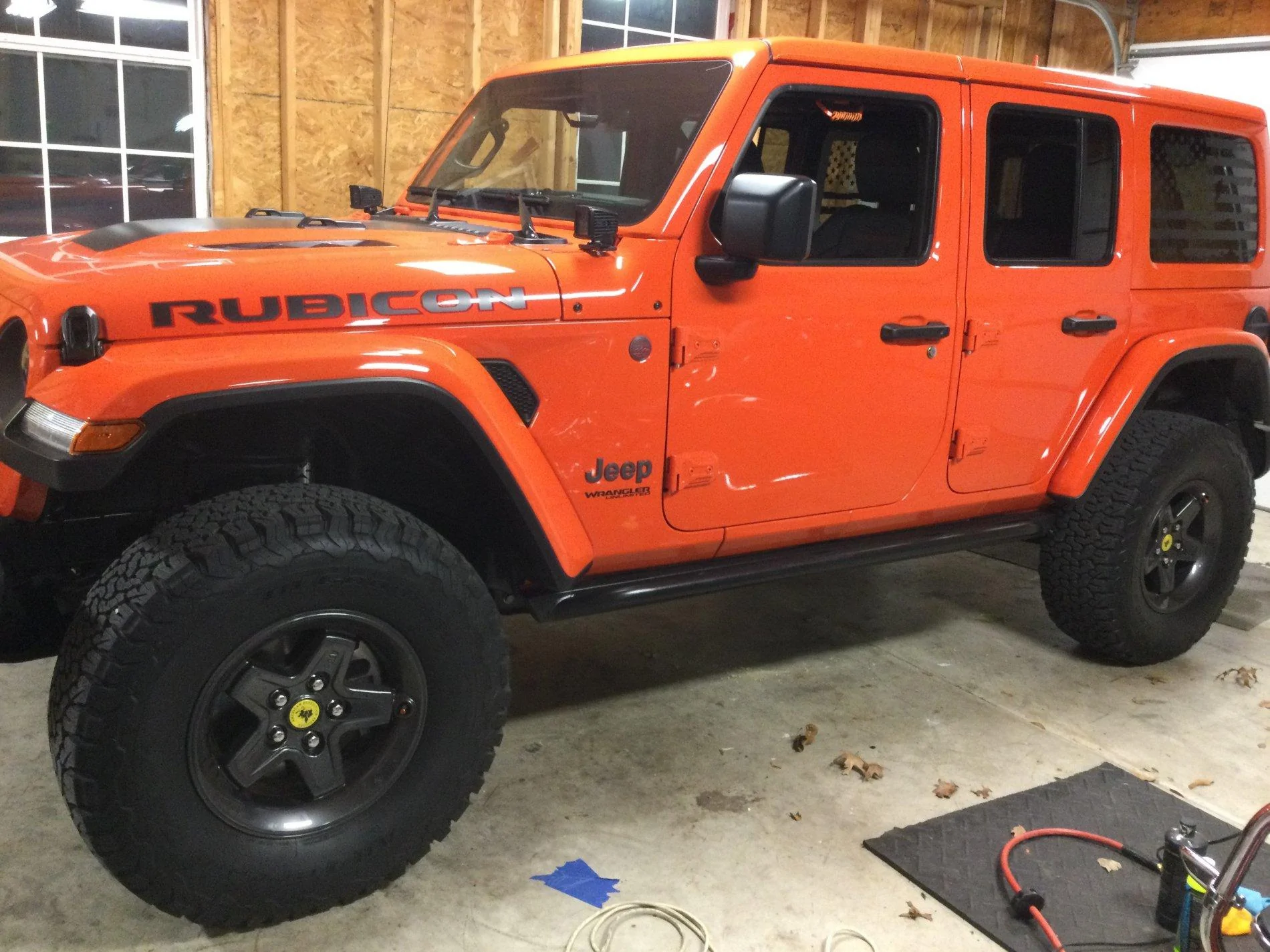

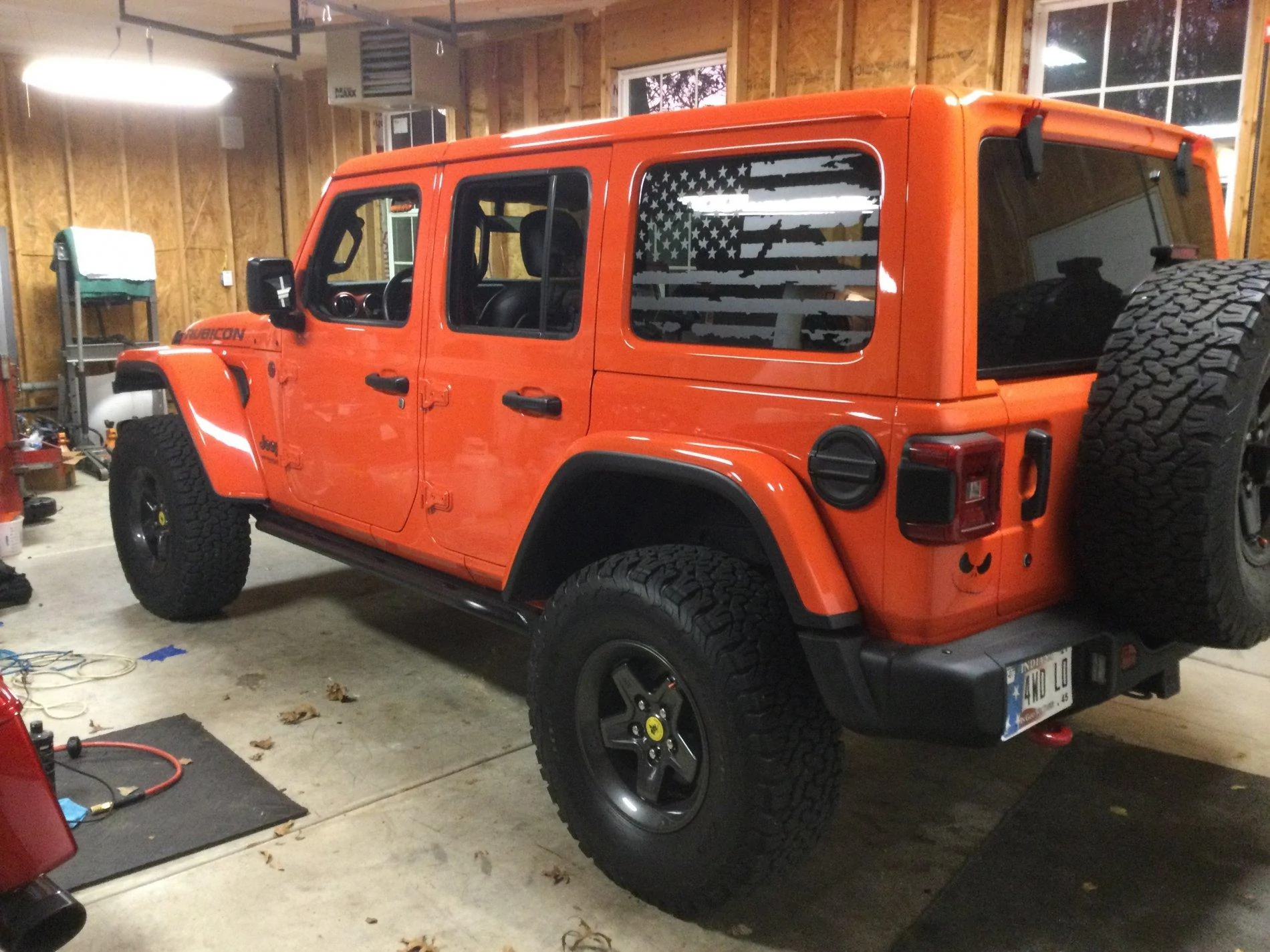

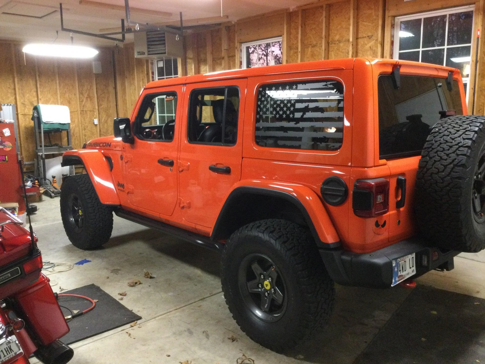

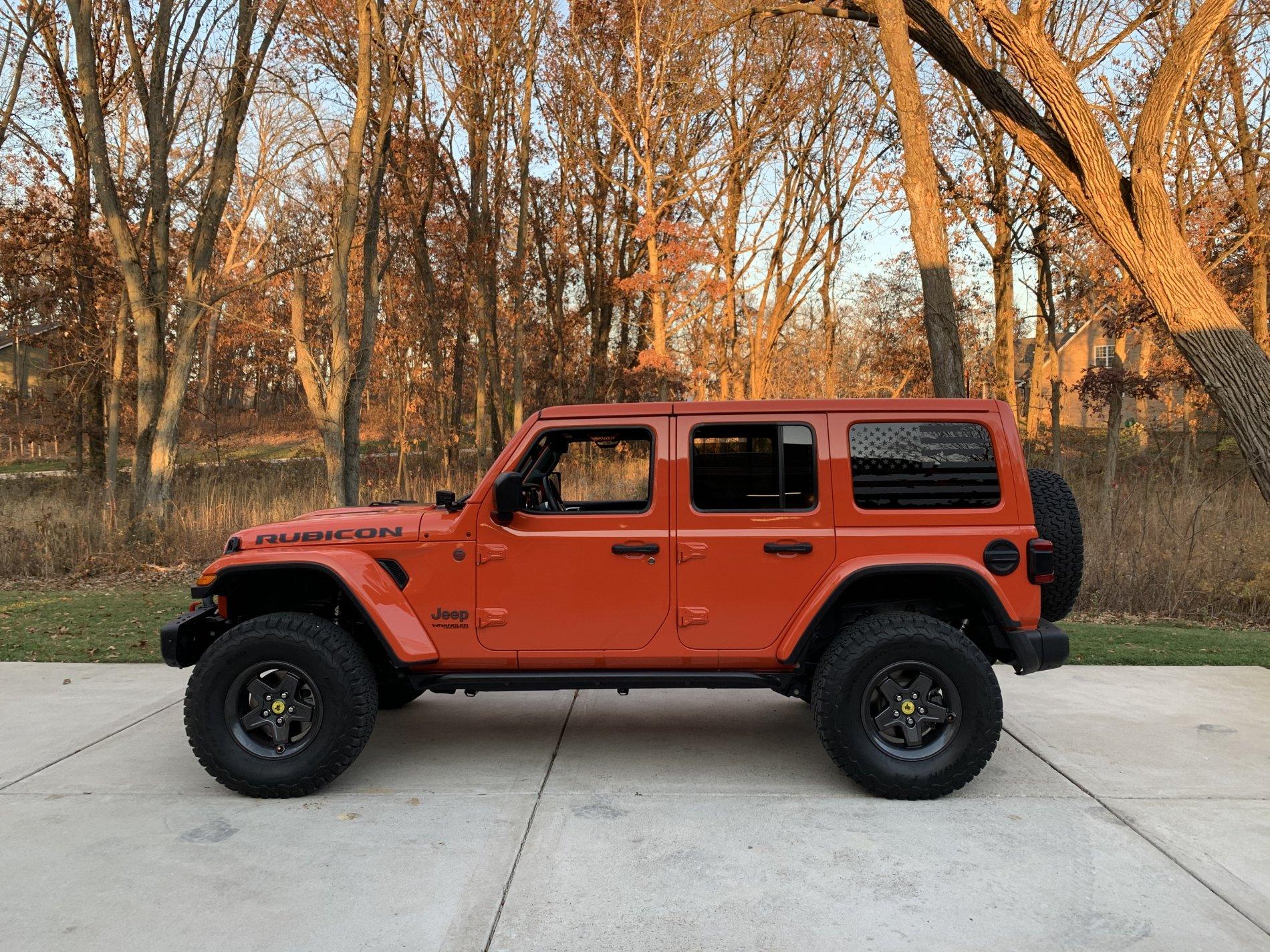

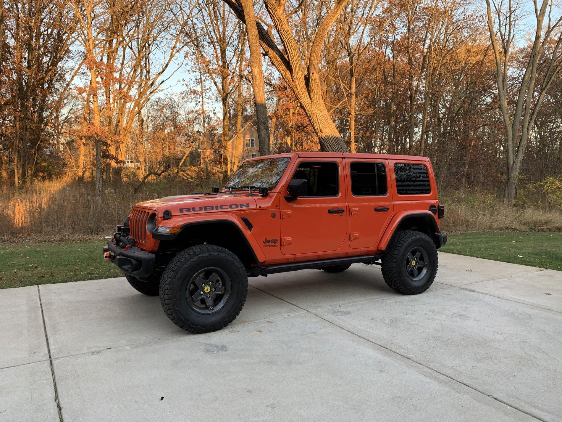

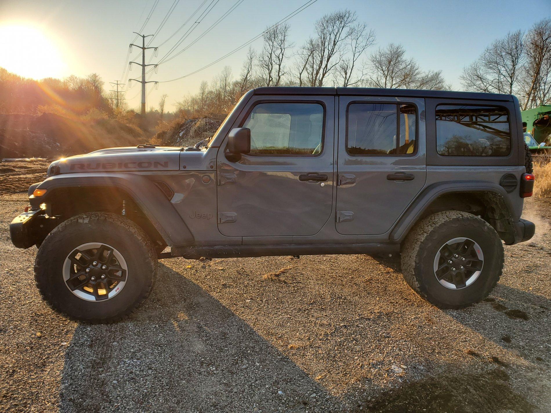

That’s not to bad, sounds like you did 3/4” spacers in front for rake/winch and added 1/2” to right side.
Rt rear is still a little low and Lt front is a little high. 1/4” in the right rear would probably put it perfect but I got tired of screwing with it. I will let everything settle for a few and maybe mill down a teraflex spacer and see if it dials it in the rest of the way.
