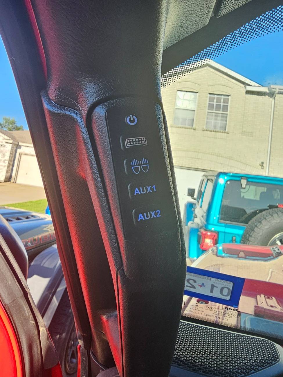

My addon rear lights come on with the normal reverse lights, and then I can also activate the addon lights with a switch in the driver side A pillar. Lights on, lights off... on demand... simple.

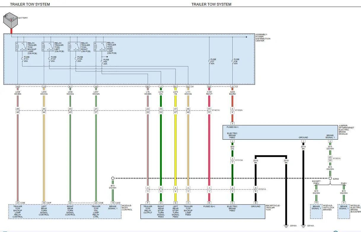

Doubt they've changed for 24, should be White w/ Orange Stripe

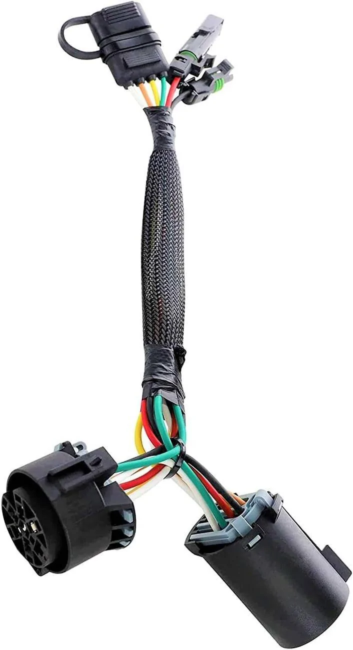

3. PUTCO 529004 - Blade Connect Harness -
Amazon.com: PUTCO 529004 - Blade Connect Harness : Automotive
This installs behind the existing 7-pin connection at the rear bumper (if you already have the tow kit option installed). Splice your lights into this item and not your OEM wiring.

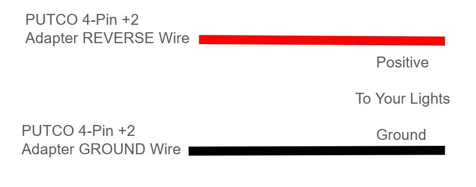

7. I used the 4-pin +2 pigtail of the PUTCO for splicing in my lights to work off of the REAR/BACKUP lighting wire. This made for a shorter wire-run from the lights to the 4-pin +2 pig tail. Cut off and terminate the wires you don't need.

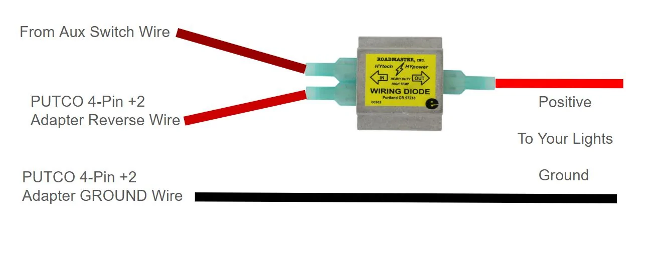

8. Once you have reverse light circuit driving your rear lights, it is time to locate where to splice in the diode and add the auxiliary-switched-relay wire harness connection. Find a location that works with your bumper and wiring.

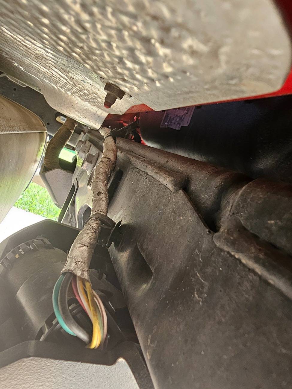

Thanks, this is the route I'll go. What is the thingy mounted on the other side of the receiver hitch opposite of the 7 pin connector?
