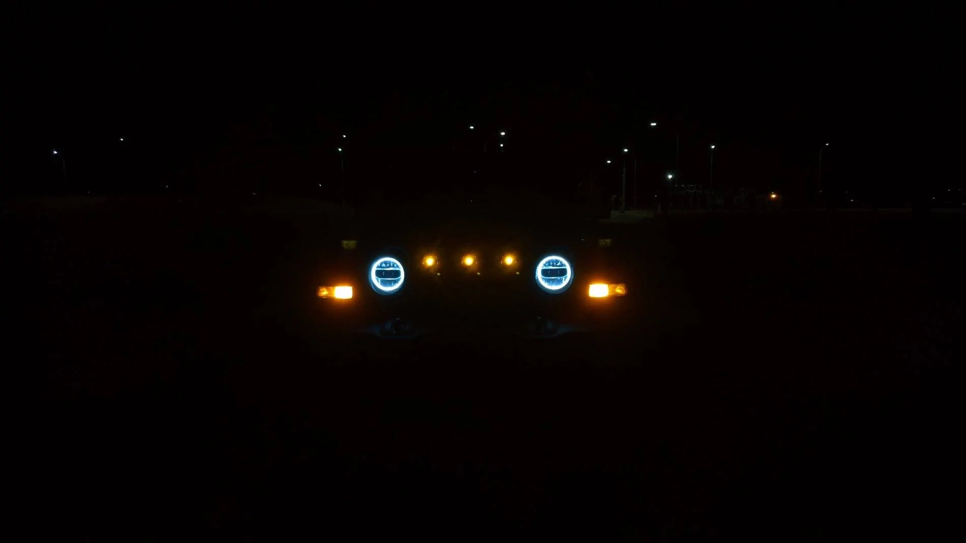

mines a Canadian sport s with led package, so not sure if your is same but my fenders have two bulbs in them and they don't come on as the daytime running light but with the jscan I just switched mine to use the orange light in the fenders as the daytime running light and it only lights the Halos and not the low beams.
this is what ot looks like after change with jscan
