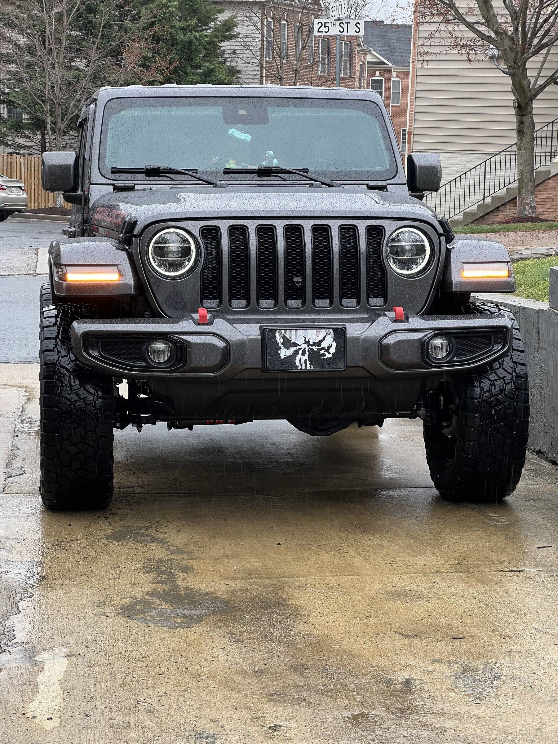

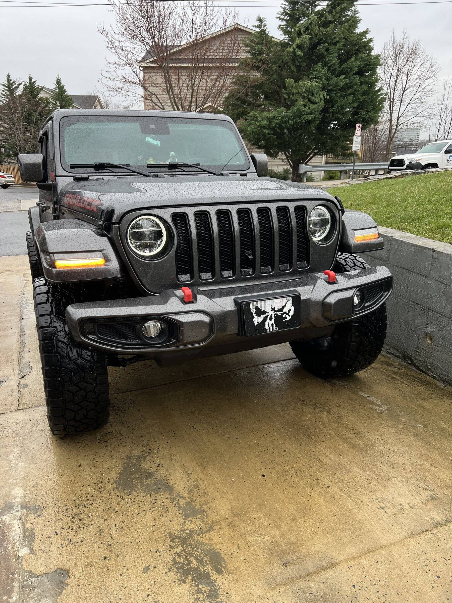

Well, if you want your JL to not look like all the other JL's you may want to keep it as is... Your JL will be unique.
I get lots of comments regarding my JL having yellow versus white..
With JSCAN you change to yellow for DRL's by doing this:
Turn Signals for DRL's
Maybe need:
ADAPTATION ---> DRL--> Day time running lights Configuration- Canada DRL
ADAPTATION
---> DRL - Day time running lights - settings --> DRL Lamp Location --> Turn Signal DRL

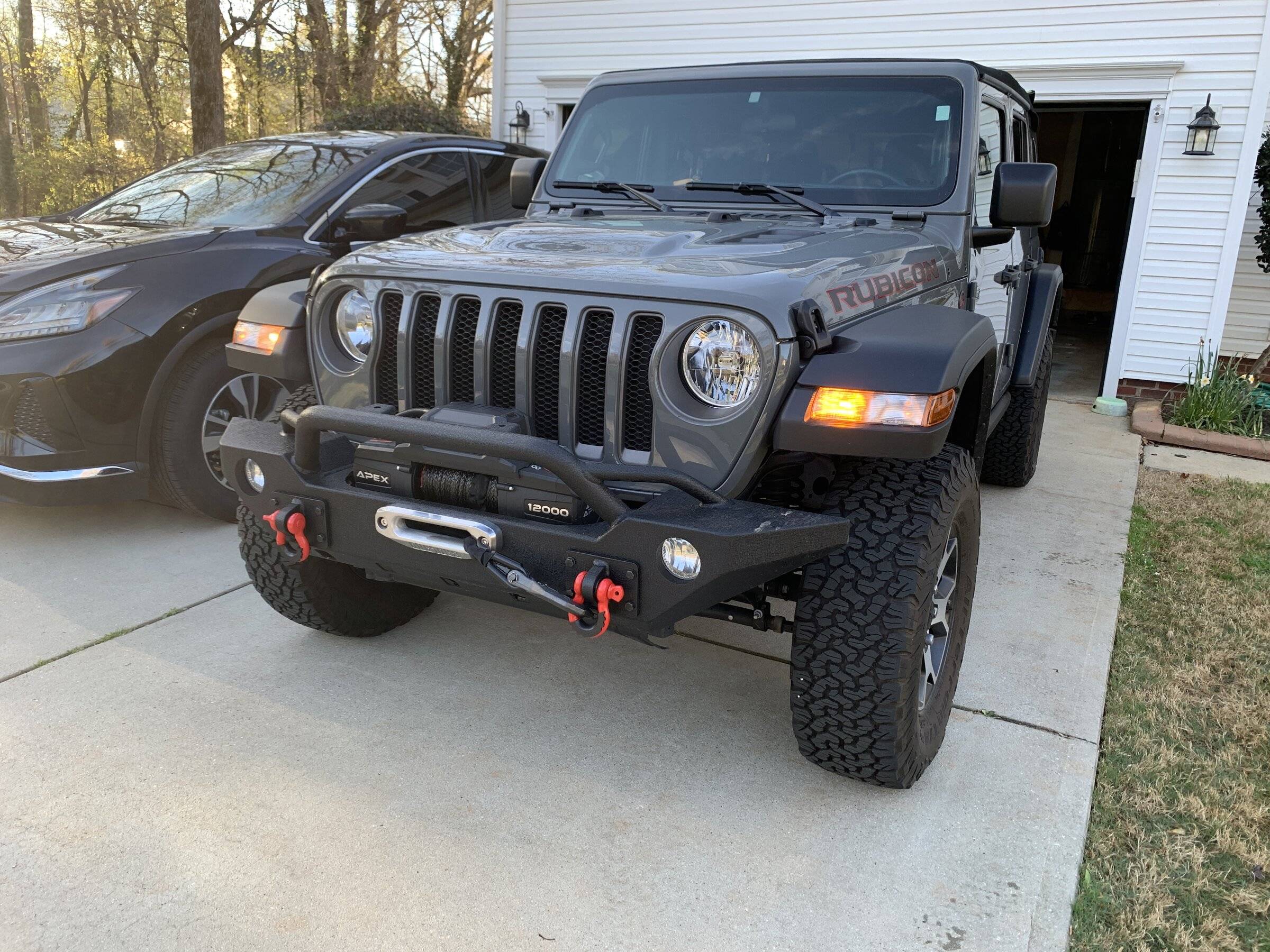

Halogen yellow DRL pic below. Any thoughts on turning down the power on the yellow DRL? Is that an option? Just did the switch and will run the a few day to see how I like them. My old Toyotas had yellow and I always felt they stand out better in bad weather.

Huh.... my JL and the guy's JL's that posted in this thread are not lighting as your JL. Something looks different/ not good in regard to your JL. (Unless it is a picture angle thing)
Did you use the exact same JSCAN settings as I mentioned early on in this thread.
This is not my JL but my JL lights look like this:

Mine is a 21 JLUR with halogen lights and my turn signals and white DRL are side by side instead of two horizontals like the first pictured jeep. I am thinking the first jeep has LED lights?

My Keep is a 21 JLUR with halogen lights and my turn signals and white DRL are side by side instead of two horizontals like the first pictured jeep. I am thinking the first jeep has LED lights?
@Trk3263
Yup, that is why there is a difference in appearance then. The other's in the pics in this thread have an LED optioned JL.
