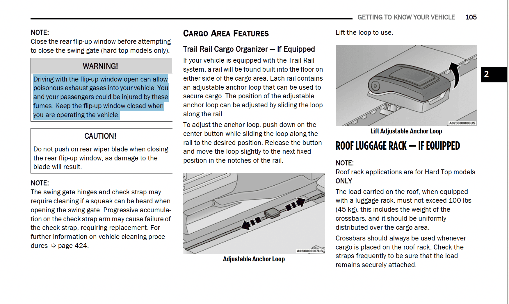

I personally drove like that and I don't think it would break that easily. That being said, manual is advising against it;
Jeep Wrangler JL Driving with rear window up? Screen Shot 2021-05-08 at 4.54.58 PM
