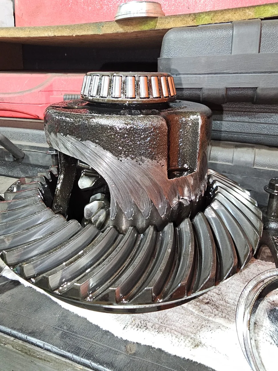

Hello, I’ve got a bit of a head-scratcher. I’m experiencing driveline vibrations above 67 MPH. A few months ago, I had my JL re-geared. After completing the break-in period, I resumed normal and highway driving and noticed the vibrations.
To rule out the driveshaft, I installed a brand-new Adams double cardan driveshaft (this is the second one), had the tires balanced, and corrected the driveshaft angles. I even experimented with different angles, but the vibration occurs at the exact same speed every time.
During the re-gear, my differential carrier was scuffed but reinstalled. Could that be causing the vibration? Do differential carriers need to be perfectly balanced? I attached some photos for reference.
ANY IDEAS?

Scuffed? LOL.
That previous pinion nut got loose, IMO. Sucked the pinion into the differential.

That’s what happened originally, so I had it regeared but the carrier was not replaced. Then when I replaced a driveshaft to a new one the vibration improved but now it starts at 67MPH. Should I replace the carrier?

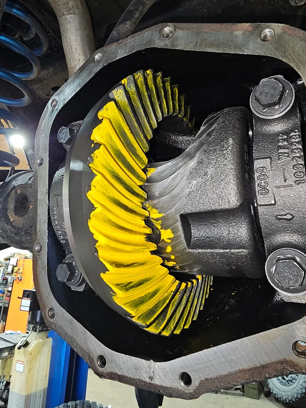

I didn’t regear it myself, that’s way too complicated for me. lol. I had a shop do it. They do tons of these so I’m assuming they did it right. But you never know. I’ll be taking it back to see if they can find the problem and mention what you said. I attached a photo of the pattern. Thanks.

I am no expert but I would have 100% replaced that carrier.... @chevymitchell what are your thoughts?
The carrier clearly needs replaced. lol.
There are several things that need inspected here. I would have refused to re-gear it in my shop unless the carrier was replaced along with every bearing.
The spiders need to come out and their landing shims inspected. You have a case here where an incredible amount of metal went everywhere. Anything other than a full inspection wouldn’t be enough.
Vibration is likely coming from the coast side of that pattern. The pattern could be better. Hard to tell you where a vibe is coming from but I can tell you from experience… if you see a problem, it’s likely the problem. Carrier needs replaced regardless of what you do or find. There’s no way I would have just re-geared it like this.

I guess I’ll be taking it back to the shop and replacing the carrier. Thanks for the reply.

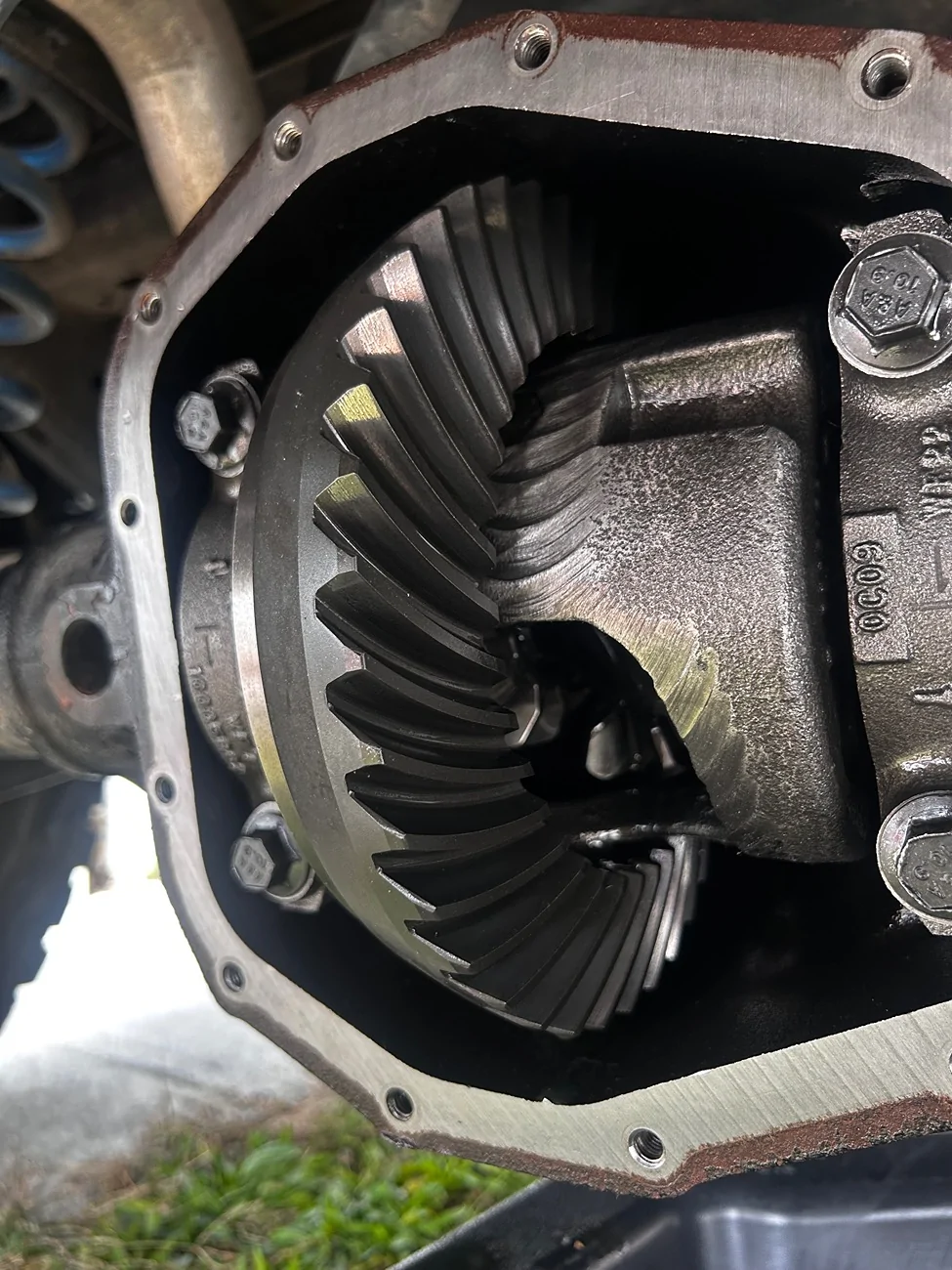

I didn’t have any metal shavings when I replaced the oil. The shop cleaned everything as much as they could. I’ll pull the plug again just to double check for any shavings. Thanks

That picture looks clean as a whistle. So, that's encouraging.
