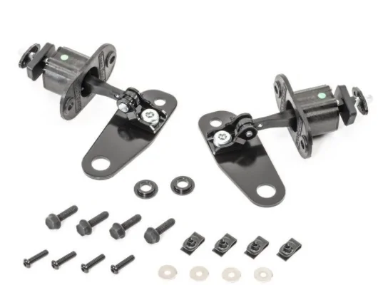

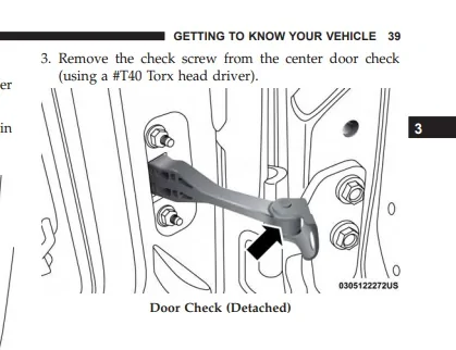

I know there is a new internal door stop design (door check) for the JL, but is it known whether the doors will just swing open freely like the JK or will there be some resistance or position stops like a traditional vehicle door? The new design appears similar to the aftermarket Mopar door checks, so hoping the latter is true.

In the close-up diagram, it doesn’t seem to have gradations to it, and it doesn’t appear to have additional arresting equipment like rubber band-like tensioners or hydraulics.
It seems to be very slim along most of it until it tappers at the end and then has a slight indentation, which would lead me to believe it’s likely rollers behind on a bit of pressure to snap in place one it passes through that indentation, and then offer just a little resistance when returning to closed.

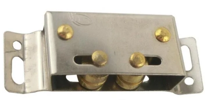

Likely something like this inside with some level of spring-loading on the rollers.

Might even be less technical with just some piece of metal (like a tiny leaf spring) or piece of rubber that do the same job by providing a bit of resistance and deforming through that wider part and returning to shape in the gap of the long part when in the closed position.

It needs to have detents at at least 2 locations plus full open, otherwise is just a rigid strap that adds no value, doors will still swing open uncontrollably, or close on you when on a hill.
The new metal door check have one middle detent / stop. So there's two stages of opening -- halfway and fully open.
