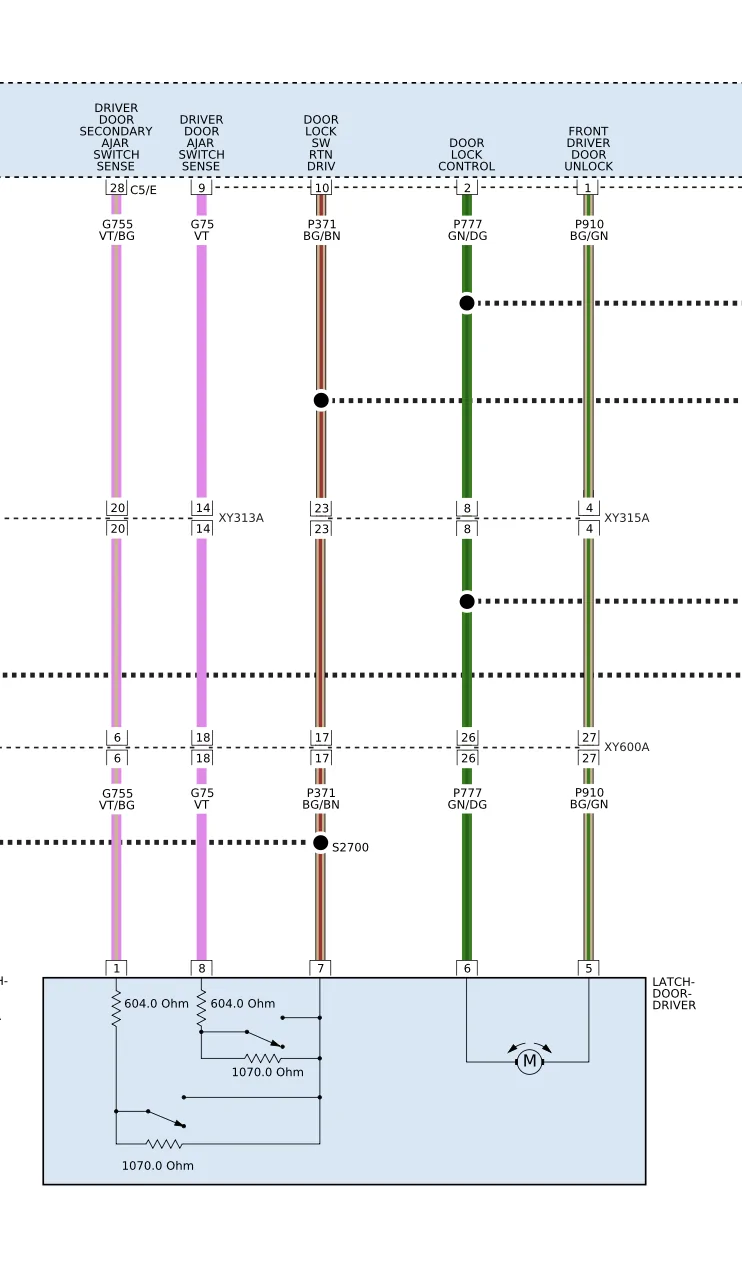

Just a thought:
Looking at the wiring diagram for a '23 Gladiator, which is likely to be similar to your '24 Wrangler, the driver's door has two door ajar sensors (apparently part of the latch). The other doors only have one. It is possible that some of the code uses the one sensor and some uses the other (or both). It might be a bad sensor or a bent pin on a connector or a broken wire. Hopefully a diagnostic tool is capable of showing both sensor inputs to verify they are both working properly. And you can use it to check out the other doors as well.
The blue at the top of the diagram is the body control module.
Jeep Wrangler JL Door open warning Screenshot 2025-11-03 at 8.34.19 AM
