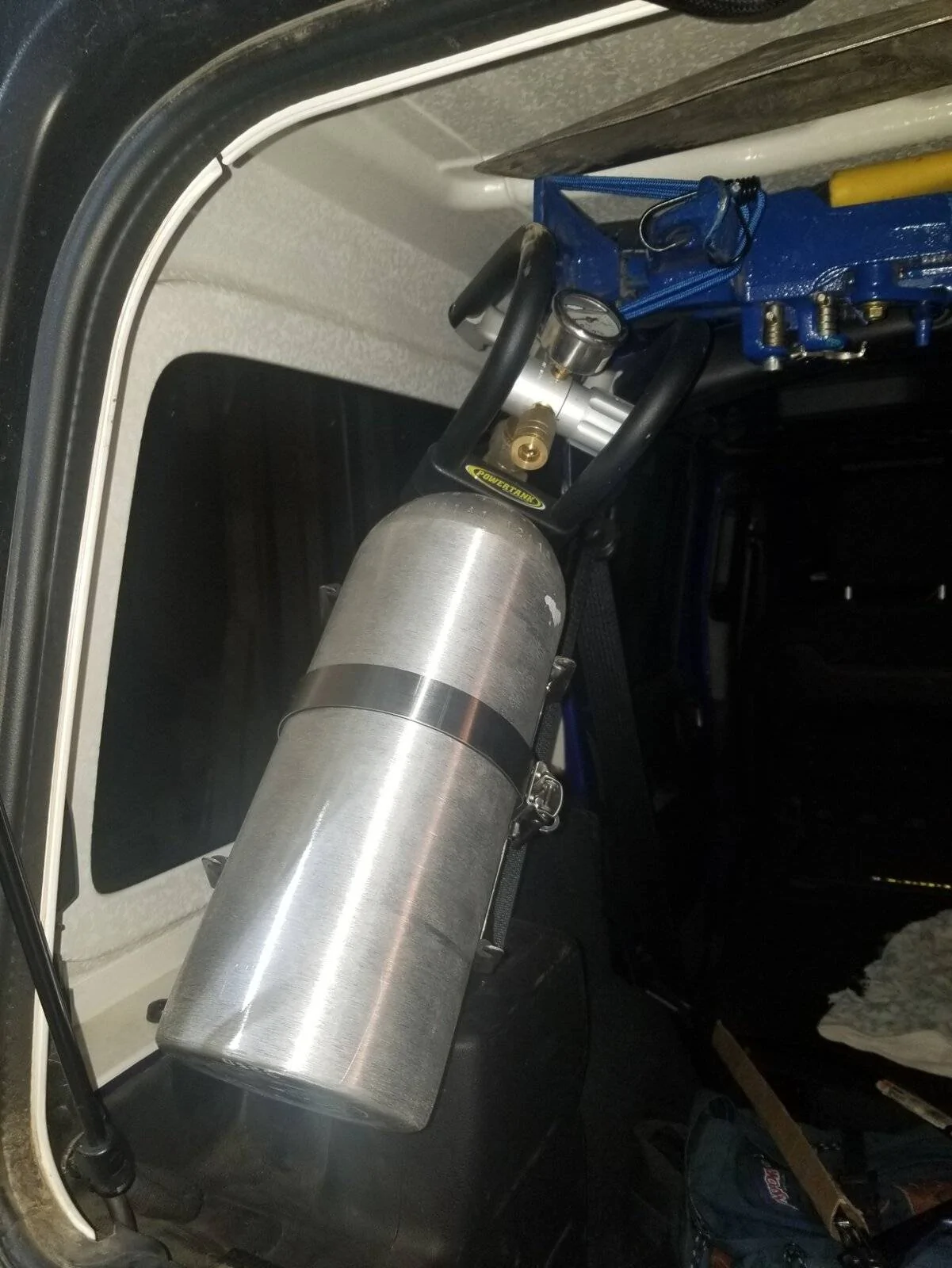

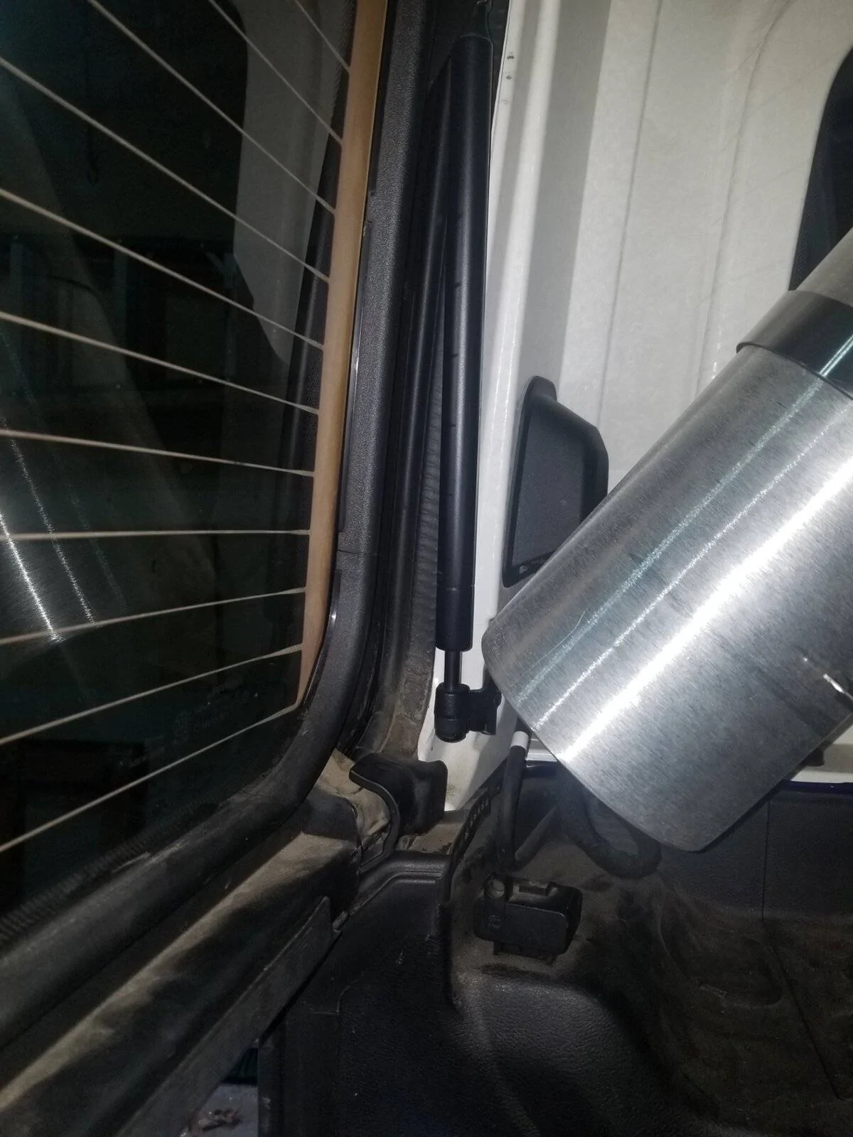

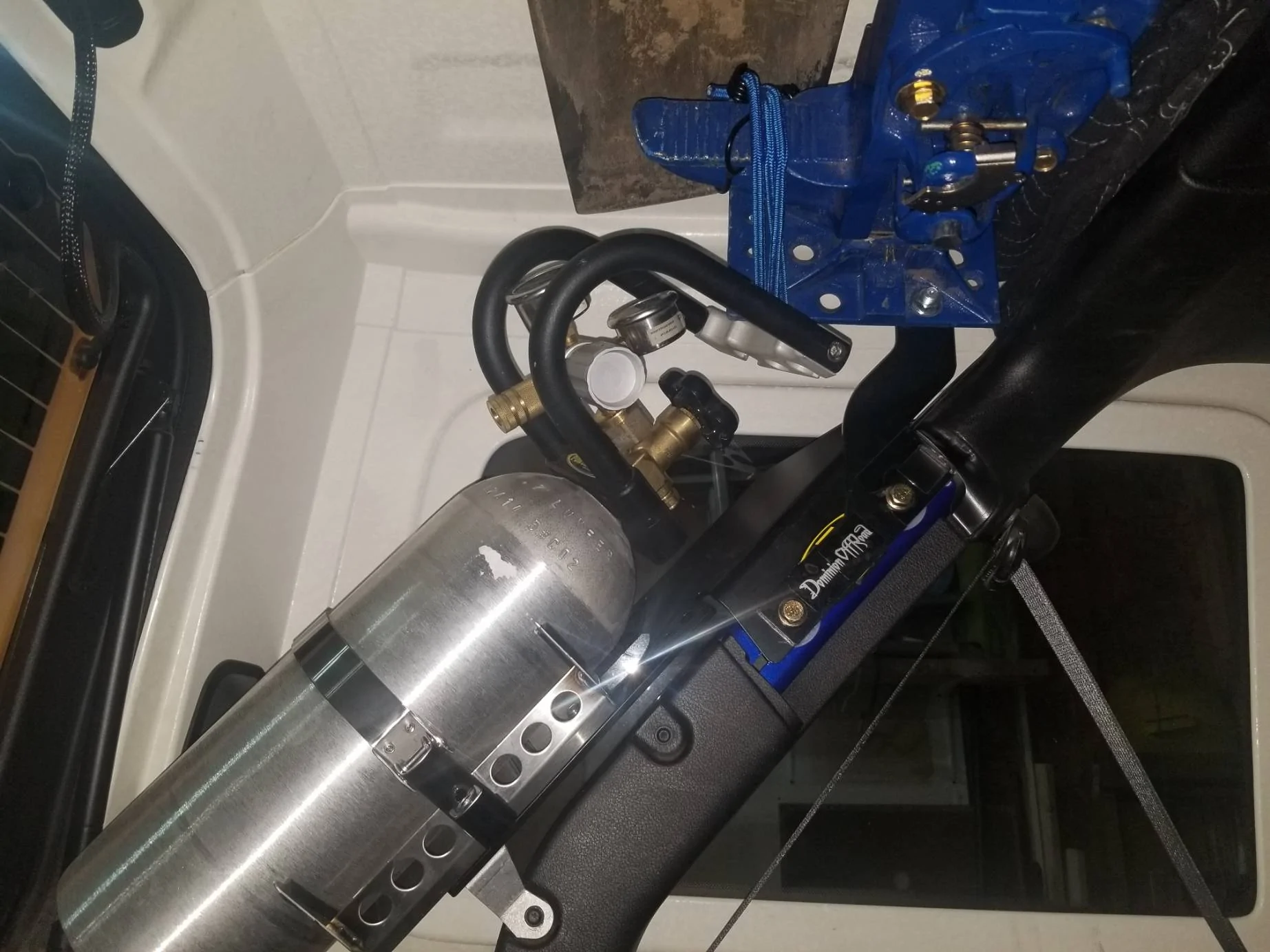

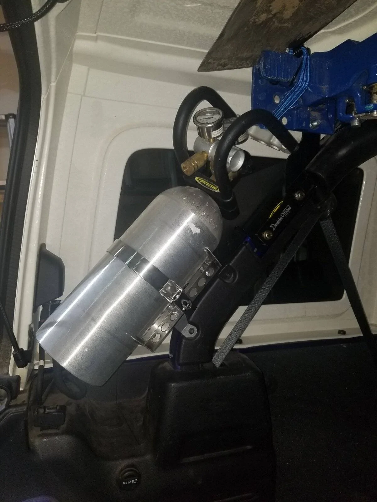

Was able to mount both the original (hard top only) Dominion Hi Lift bracket and the Power Tank JL 4door Sports Bar mount (driver side). Cheated the 5lb tank Super Bracket to be hanging off the bottom of the Sports Bar mount, and only used 4 screws instead of the designed 6. I figured the 5lb is about half the weight of the 10lb, and it's only mounted to the Jeep with 2 M8 screws, which are smaller diameter than the 4 3/8 screws mounting the Super Bracket to the Sport Bar. Also added the 10lb Sheeley Brace since the 5lb tank was mounted so low on the Sports Bar mount.
One thing that wasn't obvious to me when purchasing the Power Tank is it's only about a 45degree angle between the plate soft top attachment points and the long portion of the Sports Bar mount bracket, so the Super Bracket is facing "into" the center of the jeep, which means the Power Tank has to sit quite low on the Sports Bar mount to not mechanically interfere with the Hi Lift jack base. Might be a little more clearance on the passenger side?
Also, the newer Dominion mount places the Hi Lift jack a few inches lower for soft top clearance. This configuration might not work with that newer "shorter" jack location.
