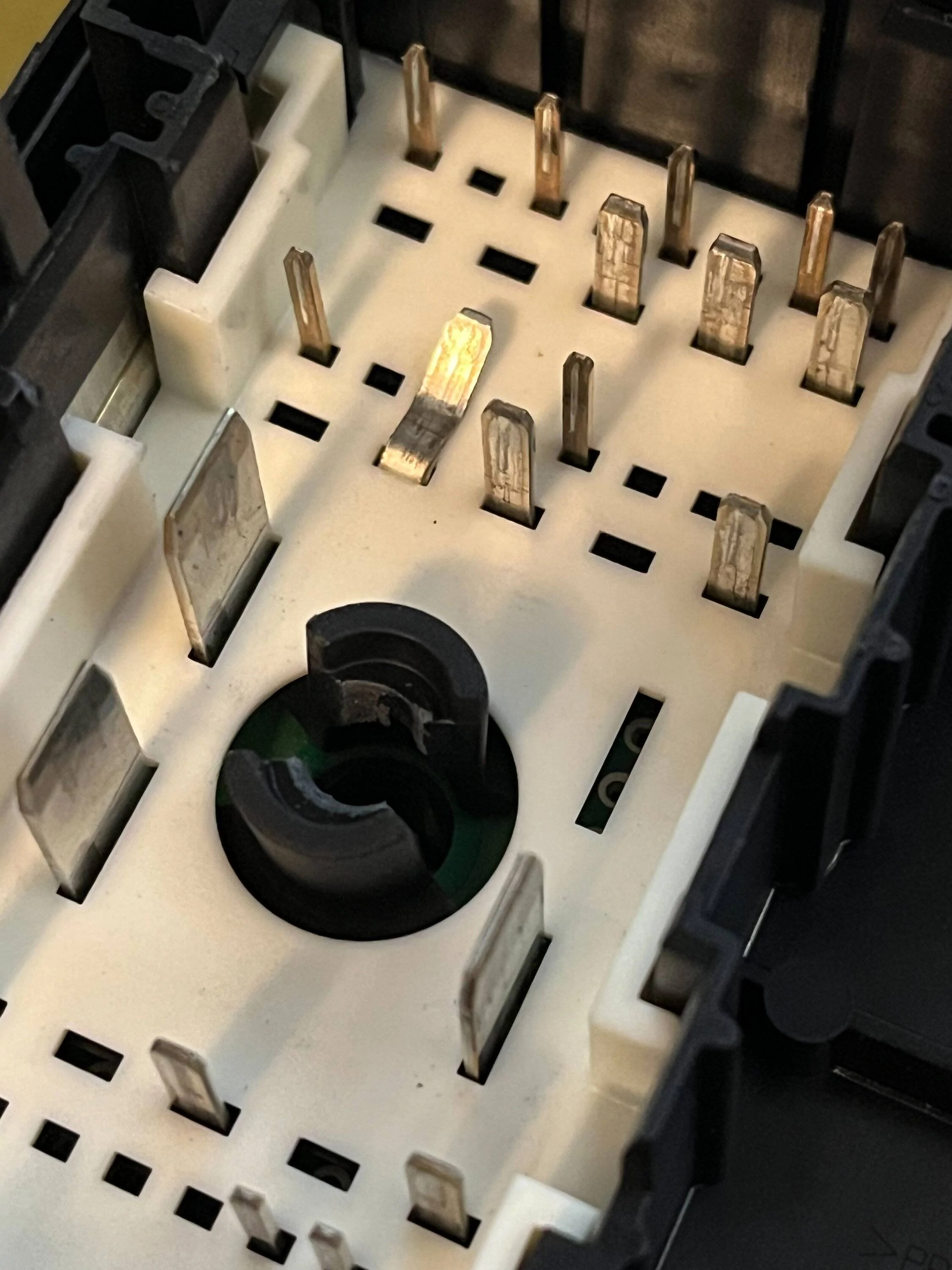

After much diagnostic effort, I ruled out the washer pump and switch on steering column. This left me scratching my head. I looked into aux battery replacement and learned the 'dealer way' of replacing was through the under hood fuse box (power distribution, TIPM, etc.). I also learned that box was commonly responsible for bizaar behavior (mostly in JKs though).
This prompted me to take it apart and I discovered a bent pin that was the culprit. I straightened the pin and put it back together. Both washer fluid and dome light work again.
I tried posting some pics, but don't think I am allowed with a new account.
I hope this helps someone else.

  • Thank you: ItsallWright and Hunter552, thank you both for bringing your dome light/windshield washer issue to this forum. Your information helped me with the exact same probelm.

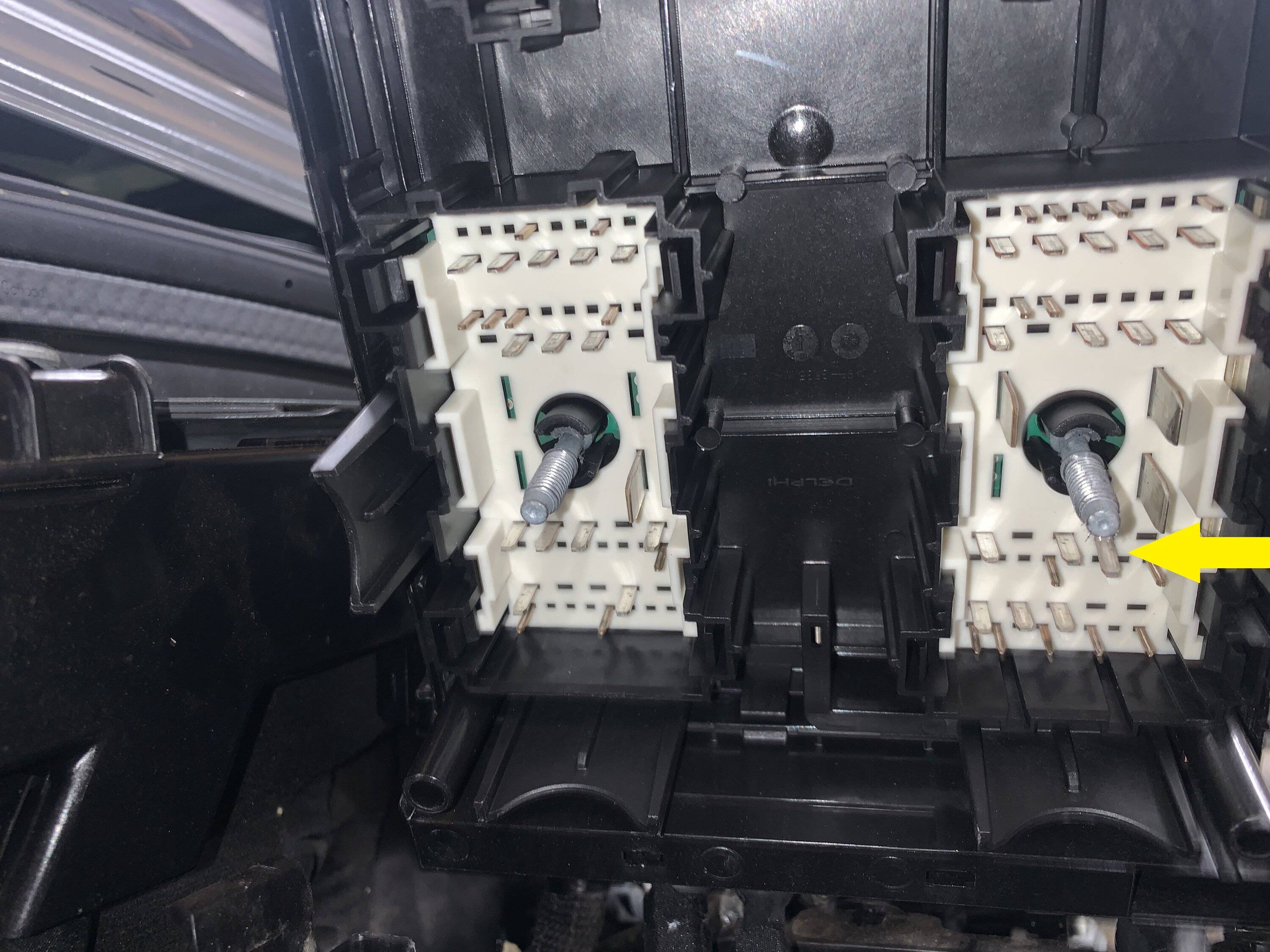

  • The Problem: I bought my Jeep from Dan Cummins in KY, and had it shipped to my home in SC. It had the problem when it arrived. The dome light would not work, and the fuse was good. The windshield washer would not spray, but the wipers worked fine. I took it to a local dealership, and they spent a week troubleshooting with no luck.
  • The Fix: My awesome wife found your post, and I went to work on it. The pin was barely bent, but it was enough to miss the mating socket (see pic below). I also found that the plastic was deformed around the mating socket where the pin hit it. Unfortunately, I did not get a picture of that part. I straightened the pin and used a screwdriver to straighten the deformed plastic socket. I carefully set the PDC back down on the 4 connectors as straight as I could. Now, the dome light and windshield washer works again.
  • Good Resource: I used this video to help me to dig down to the bent pins (starting around 6:00 mark).
